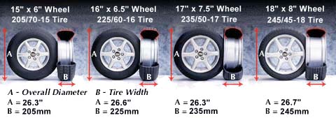

Plus One means increasing the wheel diameter by 1", for example, going from 15" to 16".
Plus Two means increasing the wheel diameter by 2", for example, going from 15" to 17".
Plus Three means increasing the wheel diameter by 3", for example, going from 15" to 18".
... and so forth!
Close is good enough
Unfortunately, plus-sizing isn't an exact science. Side wall aspect ratios only come in multiples of 5, and tire widths are in multiples of 10mm. This makes it more difficult, because when you go to a lower profile tire, you may also have to get one that is wider in order for the overall diameter to be close to your OEM tires. Most of the time, the overall diameter won't be exactly the same, so the best you can hope for is "pretty darn close". If you're only a few tenths of an inch off, that's good enough.
Here is a Tire Size chart of all tire sizes that are readily available, and are within 1" or so in diameter of the reference size, 225/60-16 (which is the standard 16" tire size available on all W-body cars since 1991).
