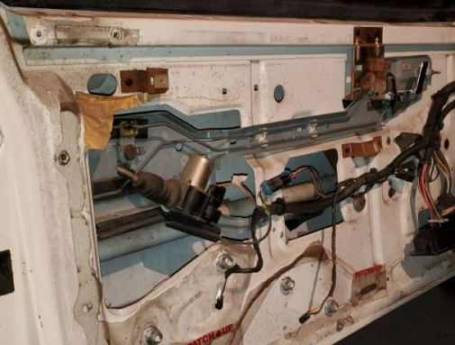

stantmann Posted April 30, 2023 Report Posted April 30, 2023 (edited) I know this is old, but though I would update for people with future problems. Get a slim jim, slide it down from the outside and push or pull (depending on what side you hit) in the circled area in the pic. Here's what you are trying to hit... Edited April 30, 2023 by stantmann Quote
