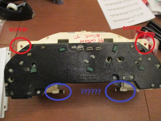

2005Yukon Posted February 14 Report Posted February 14 1995 Olds Cutlass Supreme Convertible Is there some "secret" to getting the gauge cluster out?? I bought this replacement but can't get the original (which looks identical) out. I got the 2 screws out (top left/right) but see no other screws. Do you pry out the 2 things circled in blue??? Do you just tug and twist (already scraped up the knuckles!). Quote

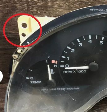

94 olds vert Posted February 14 Report Posted February 14 I've never removed a cluster on 1995 CSC. I've removed many of the early model clusters and never had an issue. Is all gauge cluster trim removed? Sometimes tilting the steering wheel all the way down is needed for clearance. It shouldn't be too hard to remove especially with the bolts removed. I wouldn't tug too hard in fear of breaking something. I would carefully pull on it in a few different directions and hopefully you will feel it move. I would think there is a white/black peg that comes up through the hole that didn't have the screw so the cluster is centered. If so you'll need to get clearance on that first, then I'm thinking it must rotate along on those lower pegs you circled. Then pull out. I'm sorry I can't be of more help. But just take your time with it. If it's been in there 30 years it might just be a little stuck. Quote
55trucker Posted February 14 Report Posted February 14 LOL......what'd the service manual tell you? to get the cluster out remove the top fasteners (you've already done so, tilt the cluster forward to you, those 2 pins seat into 2 horizontal recesses, the backside of the recess is curved shaped the same as the pins ,pull upwards (vertical) on the cluster to release the pins. 94 olds vert 1 Quote
2005Yukon Posted March 5 Author Report Posted March 5 A garage I go to replaced it. There is still a "secret". My guy wasn't there when I picked it up, but another mechanic did mention that he saw a piece from under the steering column on the floor (?). Could there be a pin, bolt, etc that holds the bottom of the cluster in...it's still a mystery. 94 olds vert 1 Quote
