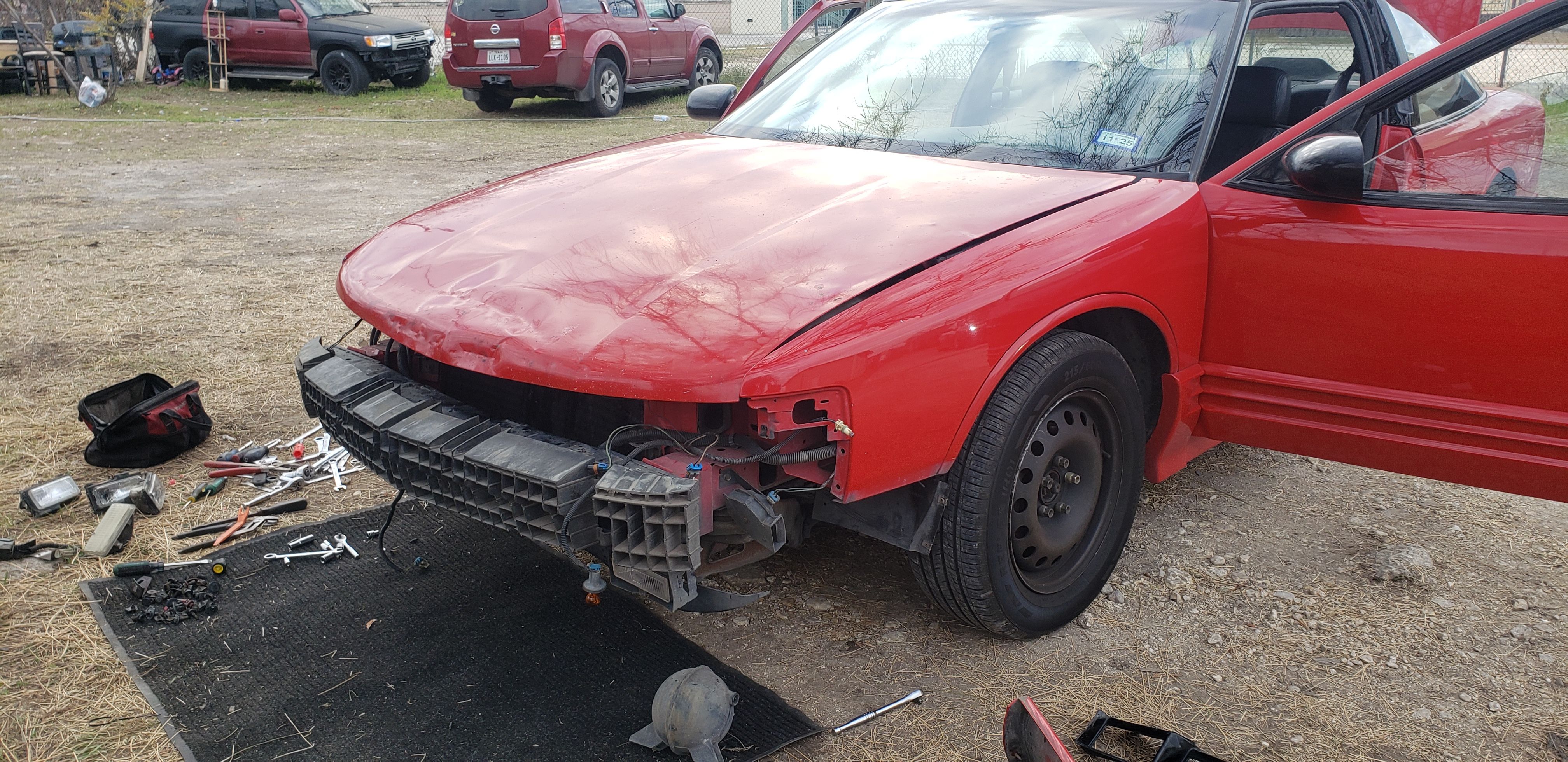

darklotus42 Posted January 16 Report Posted January 16 Has anyone ever tried to swap miniquad headlights from a GP to a CS? I got in a bit of a fender bender and now all my lights are smashed to bits. I can't seem to find a CS header panel to save my life but the yard here has a couple GPs but idk if I could Frankenstein something together. Lmk any thoughts. Quote

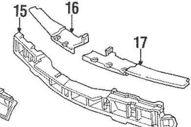

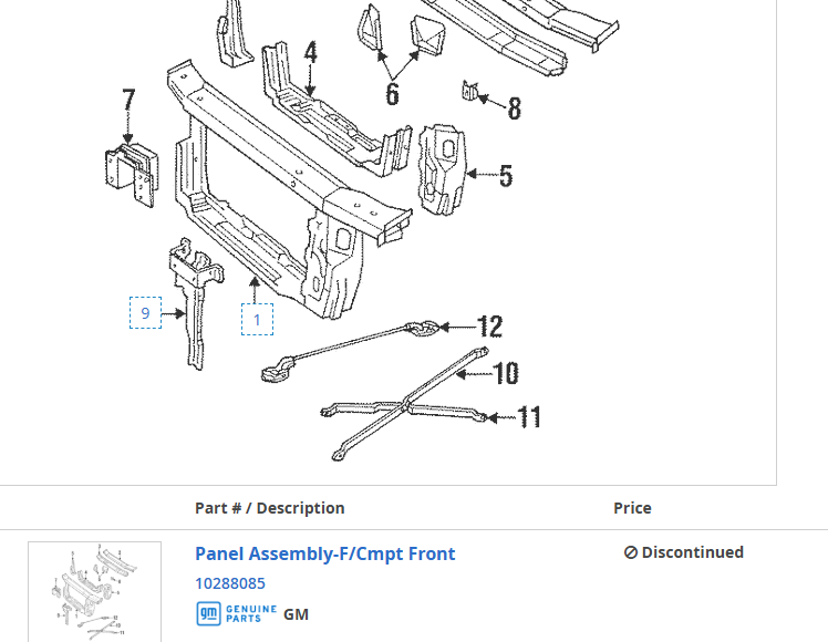

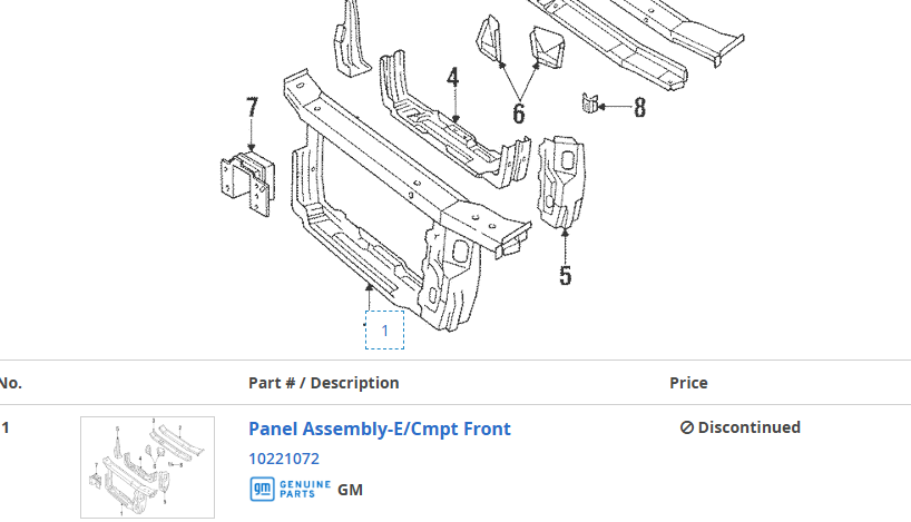

94 olds vert Posted January 17 Report Posted January 17 (edited) 1992 Grand prix GTP header panel for the headlights. #15 1992 Cutlass Supreme SL head panels for the headlights. #13 At one point in time I had both of these and they are different. I'm pretty sure they could be interchanged it might take a bit of work due to mounting points being different on the rad support. I have no idea about the bumpers or how the lights would align. The rad support is nearly the same. 1992 GP rad support 1992 Cutlass Supreme rad support Note the different part numbers. The work needed to do this would probably require drilling, welding, and painting. Edited January 17 by 94 olds vert hopefully that's easier to understand jiggity76 1 Quote

94 olds vert Posted January 18 Report Posted January 18 2 minutes ago, jiggity76 said: Thank you for 94 vert showing the differences. With me owning an STE and a Cutlass Supreme coupe, I know there are differences between those for the obvious reasons. When I had my 93 GTP parts car, I just remember that the header panel was a lot different compared to my 91 Cutlass coupe. Just guessing here but I'm assuming the rad supports are all the same between W body's...it's the header panels that are unique between let's say a Regal or Prix, etc. Not sure why the different part numbers for the rad support. The only thing I can think of is different mounting locations. That could easily be taken care of. The rad support will interchange. jiggity76 1 Quote
darklotus42 Posted January 18 Author Report Posted January 18 How would you replace a rad support? Looks like it's spot welded Quote
jiggity76 Posted January 18 Report Posted January 18 21 minutes ago, darklotus42 said: How would you replace a rad support? Looks like it's spot welded I was wondering the same thing. I suppose you'd have to drill out the welds and separate where needed. 94 olds vert 1 Quote
darklotus42 Posted January 18 Author Report Posted January 18 That doesn't sound like fun. I think I'll try to bend it back in place Quote
94 olds vert Posted January 18 Report Posted January 18 (edited) 11 minutes ago, jiggity76 said: I was wondering the same thing. I suppose you'd have to drill out the welds and separate where needed. Yeah that's exactly what you need to do. Then weld in a new one. Edited January 18 by 94 olds vert jiggity76 1 Quote

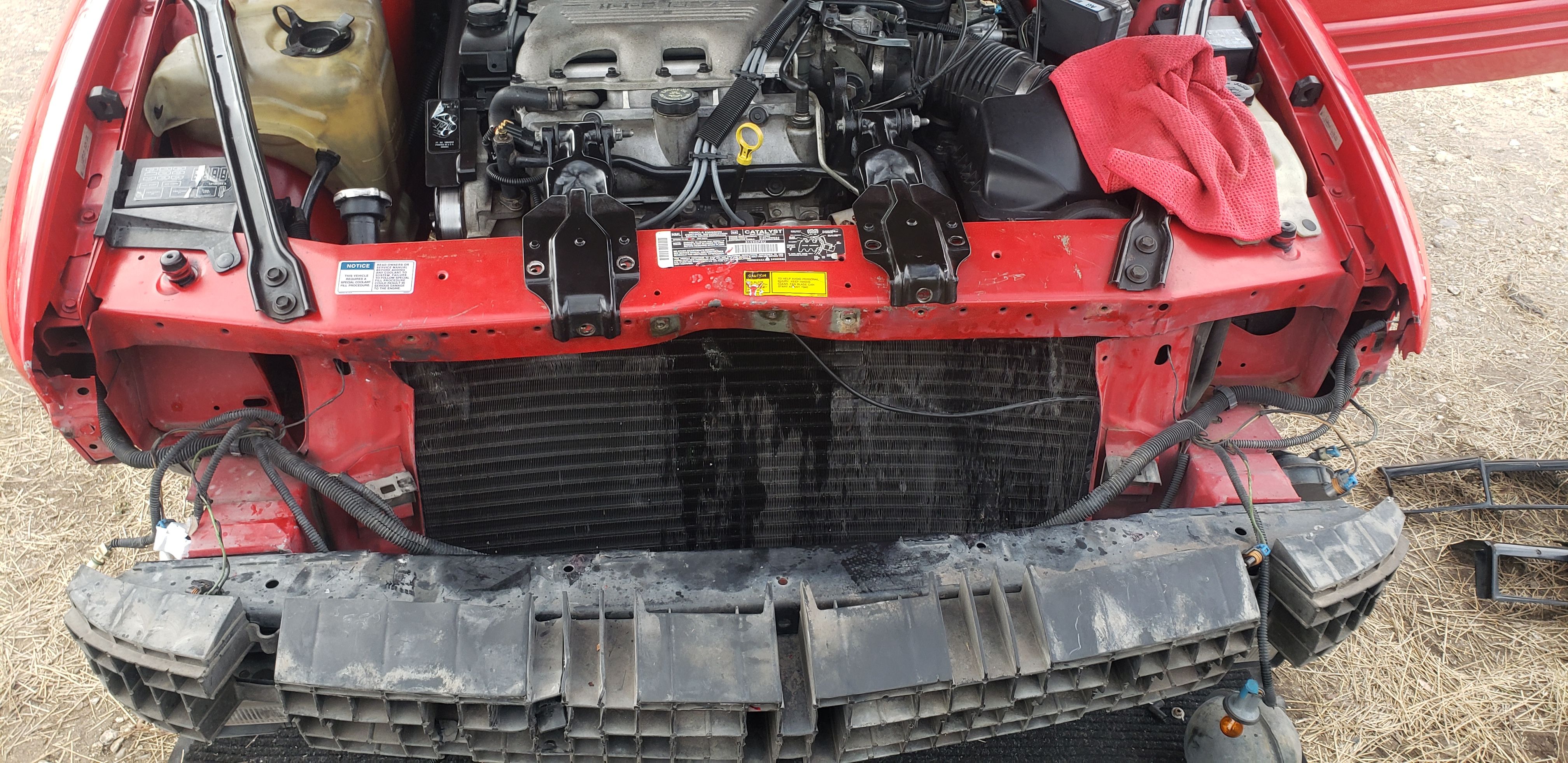

55trucker Posted January 18 Report Posted January 18 30 minutes ago, darklotus42 said: That doesn't sound like fun. I think I'll try to bend it back in place Approach a body shop, speak with the manager & ask him what he'd charge you to get the car on an alignment rack & pull the entire header back into correct shape. What the hell did you hit to do this? 94 olds vert 1 Quote
darklotus42 Posted January 18 Author Report Posted January 18 I rear ended a lil SUV......poor cutty....she still runs and drives just fine tho Quote
94 olds vert Posted January 18 Report Posted January 18 2 minutes ago, darklotus42 said: I rear ended a lil SUV......poor cutty....she still runs and drives just fine tho That damage isn't that bad. Looks like you took the hit up high. That rad support can be straightened out. That should fix any issue with the alignment with the dog bones. As for the panel that holds the lights, keep looking you should be able to source one eventually. I have no idea how a GP mini quad set up will line up with the bumper. I'm sure it could work but seems like a lot of hassle. jiggity76 1 Quote
55trucker Posted January 18 Report Posted January 18 14 hours ago, darklotus42 said: I rear ended a lil SUV......poor cutty....she still runs and drives just fine tho Appears as tho you're in need of an a/c condenser & a rad as well? Quote
darklotus42 Posted January 18 Author Report Posted January 18 Yeah The condenser is toast. Thankfully the radiator is okay just slightly bent....good thing too cuz I literally just replaced it a week before this happened Quote
