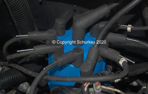

Schurkey Posted December 18, 2024 Report Posted December 18, 2024 (edited) On 12/9/2024 at 12:31 PM, Black92GS said: And if it’s a constant misfire, try something as simple as a cylinder drop test first. Unplugging each cylinder individually at the coil to see which are contributing and which are not will be very helpful as to which direction to go. Right idea...wrong procedure. Removing the plug wire from the coil creates an open circuit on the ignition secondary side. An open circuit drives the voltage sky-high, which can cause insulation failure including inside the ignition coil. Find a way to GROUND the spark, which drops the voltage to zero, and causes no insulation stress. In this case, if you remove the plug wire from the coil, connect a jumper wire from the coil terminal to engine ground. THEN start the engine to see if that cylinder is contributing. It's easier on a distributor than on a coil-pack. A few small nails, blunted, and dabbed with silicone dielectric grease, slid BETWEEN the plug wire and plug boot (Don't puncture the insulation) so that the nails touch the metal spark-plug wire metal terminal; and a grounded INCANDESCENT test-light or jumper wire works wonders. Start engine, touch test light or jumper wire to each nail in turn. Maybe you can sneak small nails into the coil-pack end of the plug wires. I wouldn't be able to on my 3.4L Luminas, there's no room to work with the coil packs bolted to the front of the engine. For the record...since you had an alternator failure, did you ever re-charge the battery? Low battery voltage can cause all sorts of problems. Edited December 18, 2024 by Schurkey Quote
