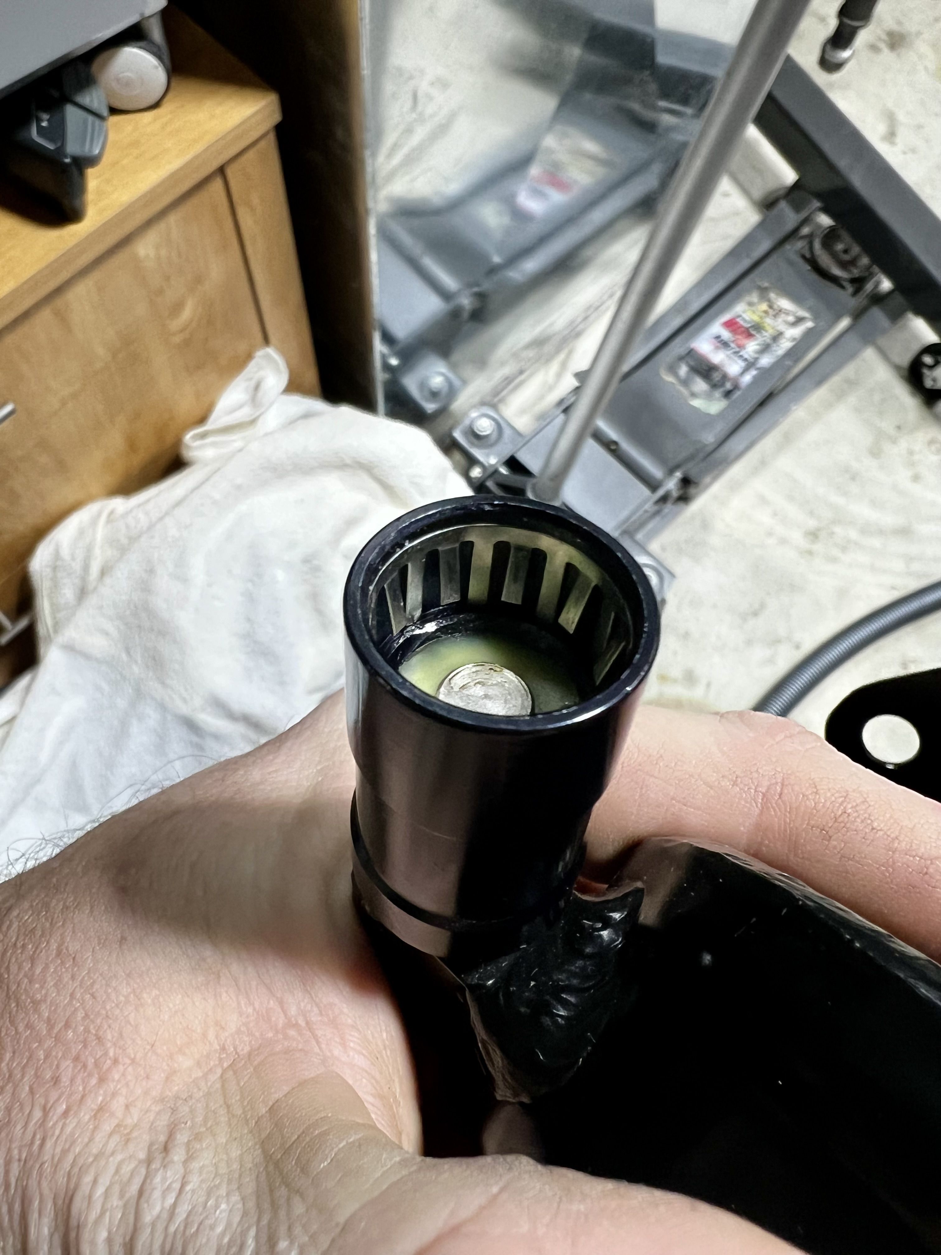

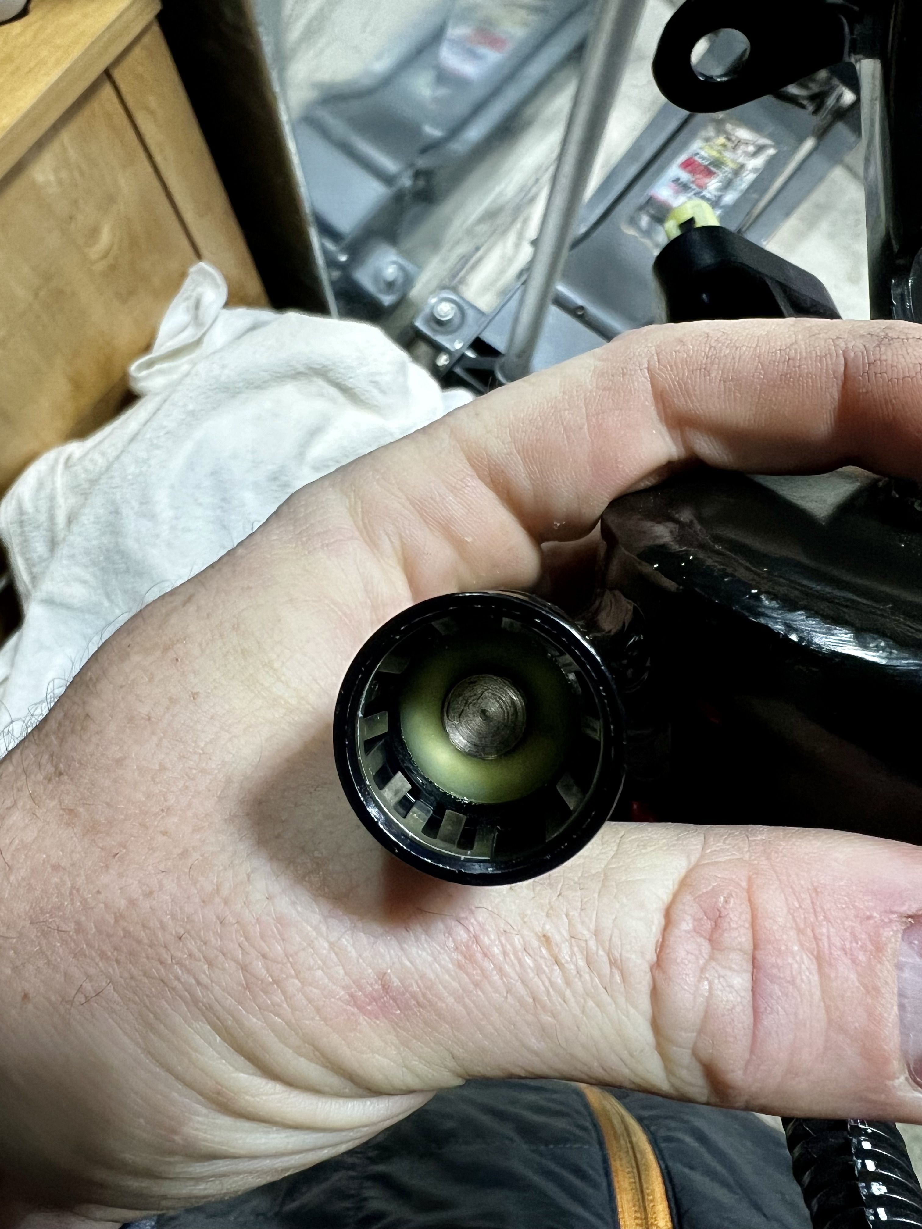

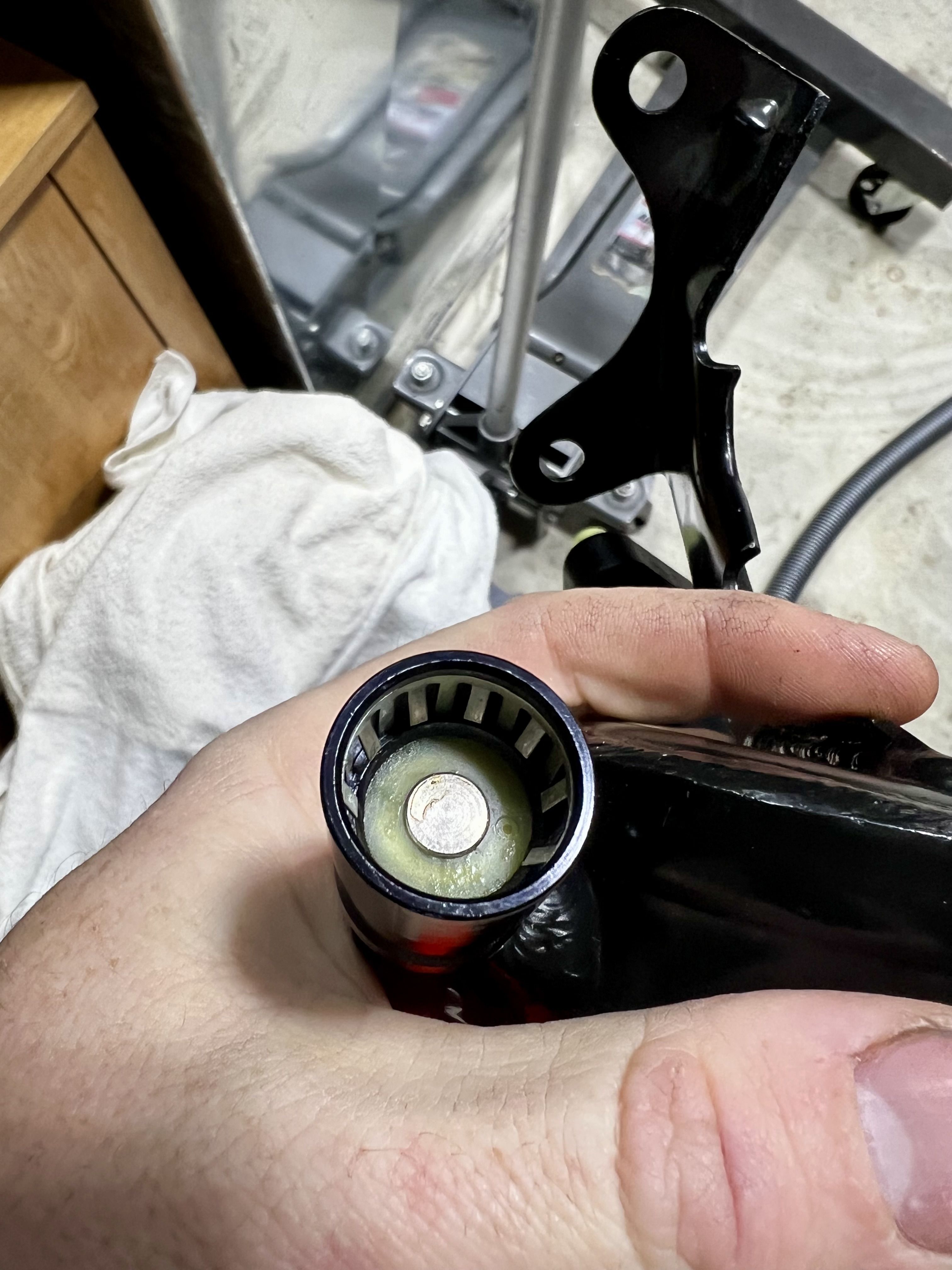

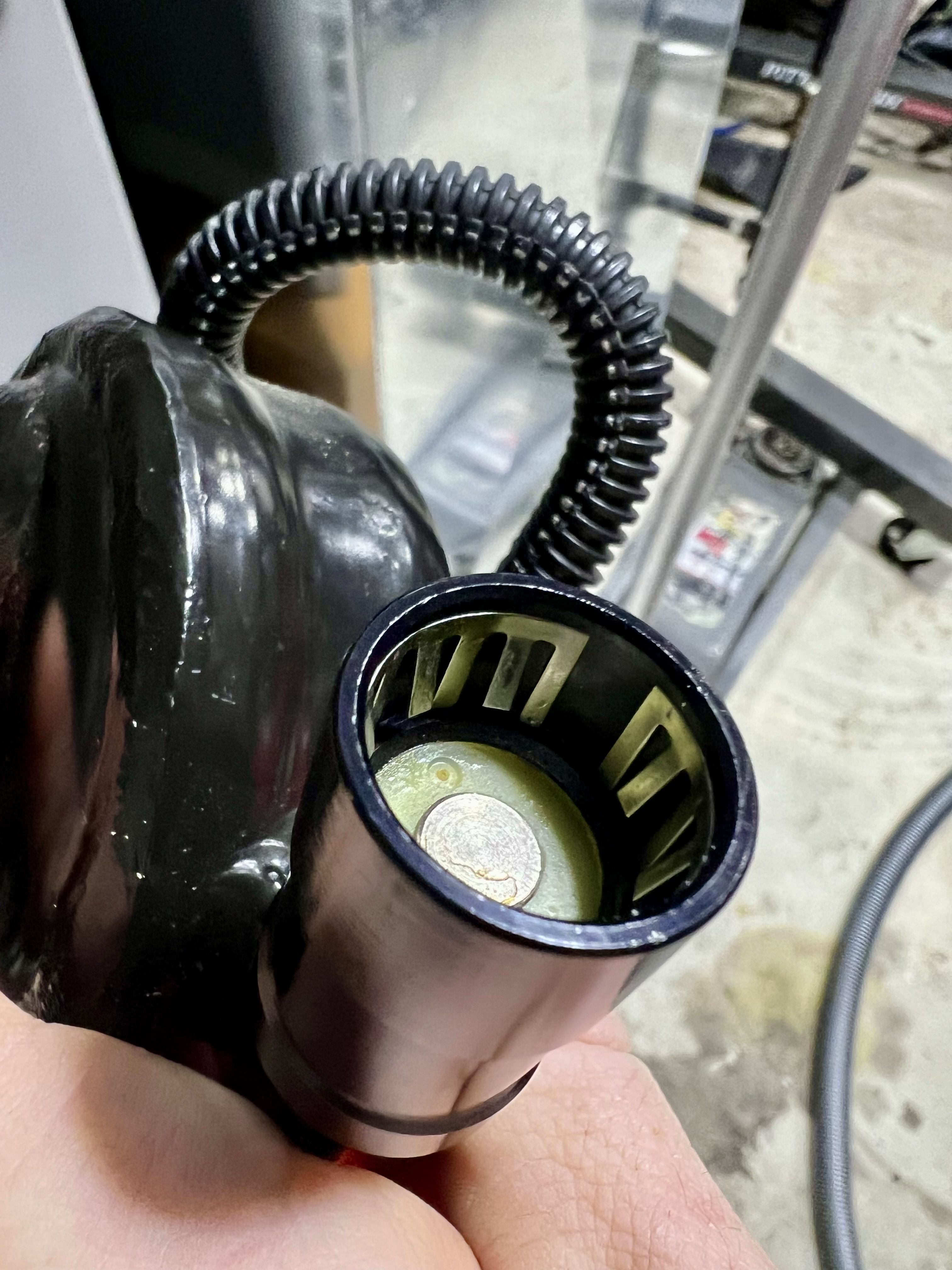

SuperBuick Posted Wednesday at 09:57 PM Report Posted Wednesday at 09:57 PM Not sure if it helps but here is what the inside of the accumulator connection looks like: Quote
