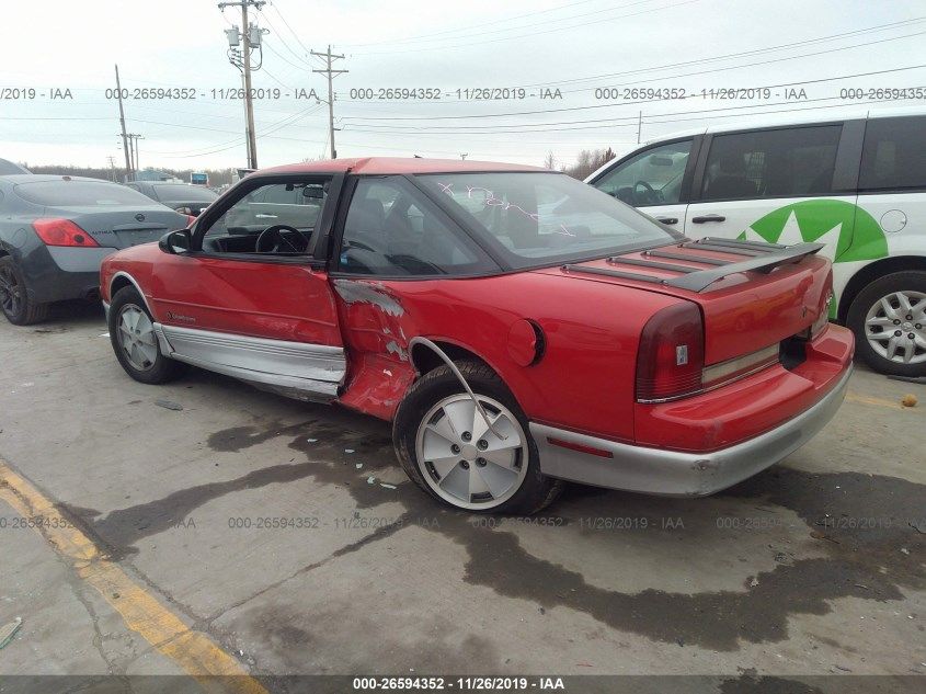

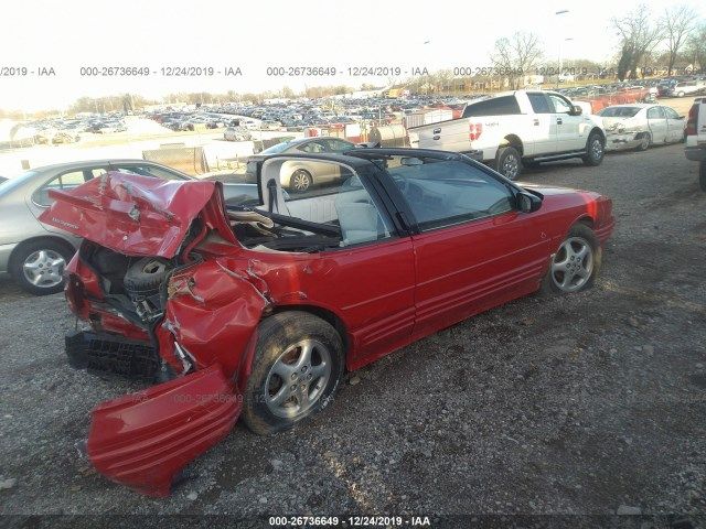

jiggity76 Posted November 20, 2024 Report Posted November 20, 2024 (edited) 10 hours ago, mycarsucks said: the 1st gen front ends are extremely strong. I just wish that they continued that same rigidity for the rest of the car. Primarily around the B pillar area and the rear end. I own a 91 Cutlass International Series coupe and a 96 Cutlass Supreme sedan. I guess I haven't noticed anything hinky going on with them when driving. The sedan does great in the snow though, great traction, but that's another topic. Just for fun...a bit scary though. But, it's also a 50 MPH crash so most cars from this era perform about the same. I need to watch my rearview mirror more often, LOL. This poor vert took a pretty good hit too. Looks like it performed pretty well for not having a metal roof. Concerning the B pillar area. This very rare 90 International coupe met it's end unfortunately. It still breaks my heart seeing it. Accidents are so odd. Can't believe that quarter glass is still intact. Edited November 20, 2024 by jiggity76 Quote
