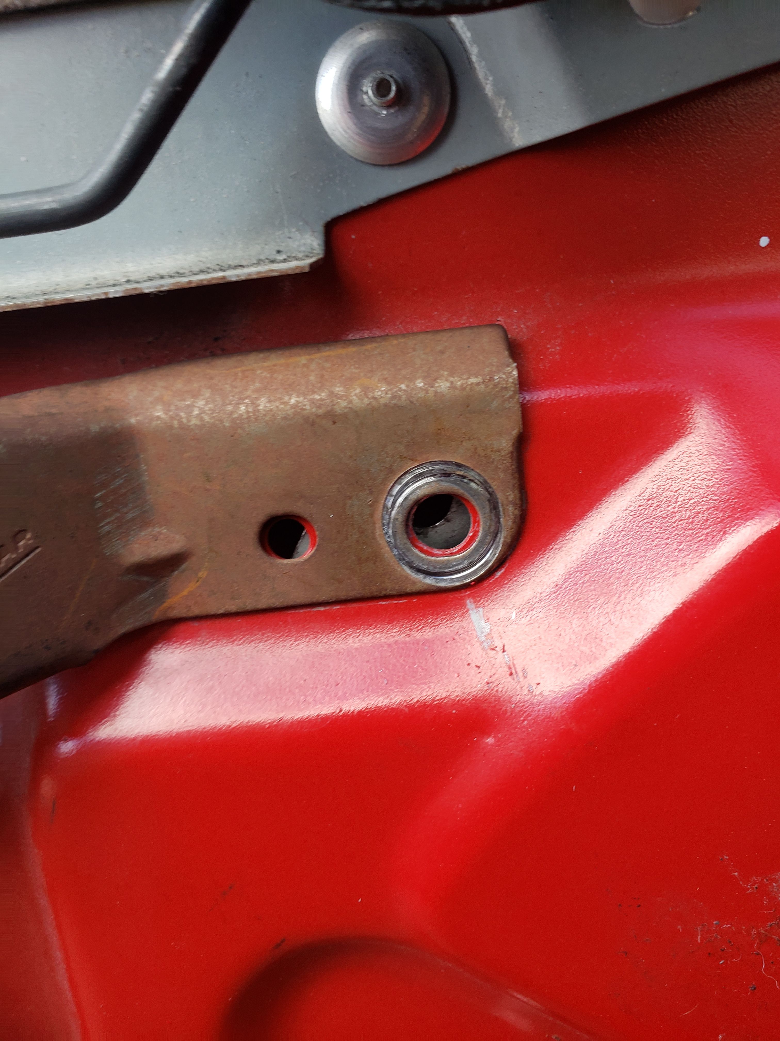

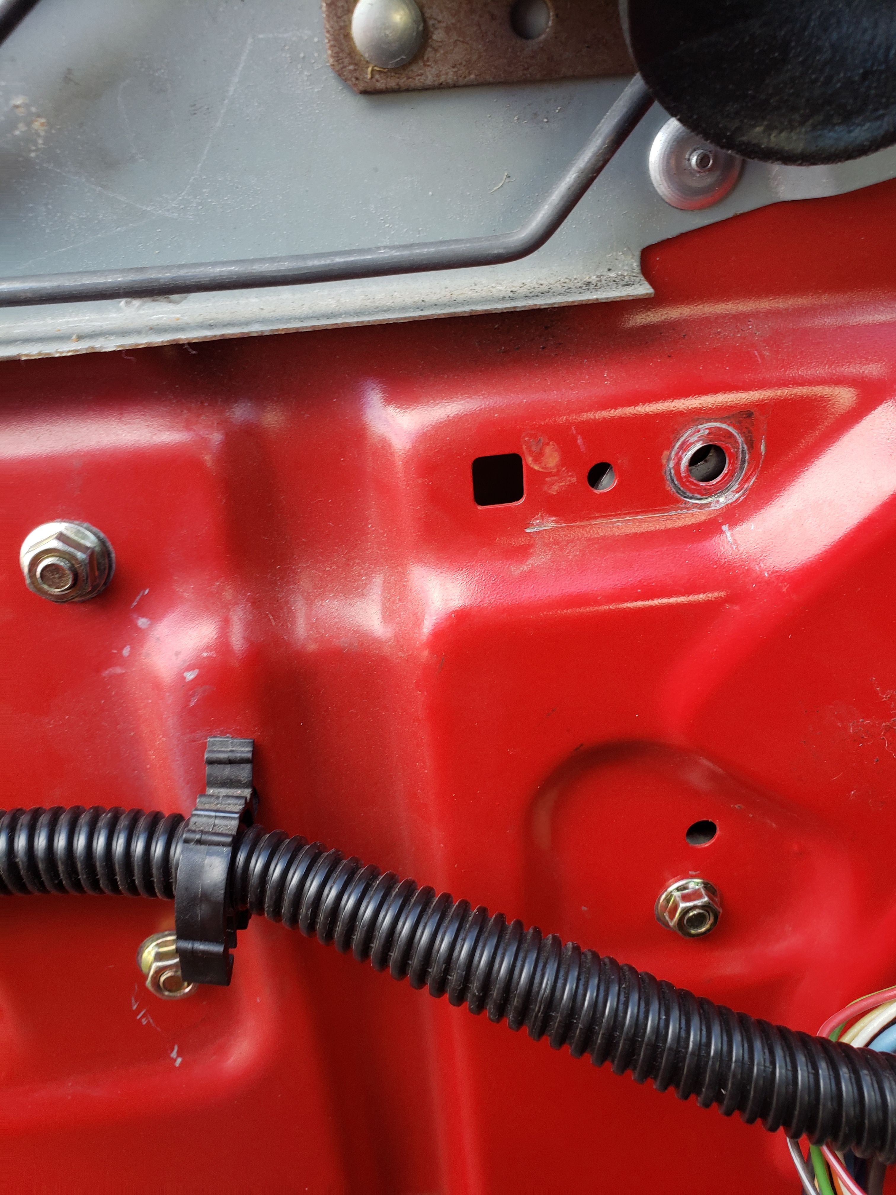

Yeah so I have a 95 CS 2dr I just replaced the window motor on the driver side. New motor, old regulator and reinstalled everything. power and switch works fine up and down when I tested before putting back in.  but for some reason it doesn't want to go up after I bolt it in. If I take out the top right corner bolt it goes up just fine. And as you can see the hole doesn't quite want to line up in the fully up position. All the way down the holes lines up fine. Nothing seems to be binding but can't really tell. The assembly shifts slightly between directions. Was thinking about just drilling out the hole so it lines up better. Any other suggestions??

Just to update I decided to drill the hole out a lil and bolt it and everything is fine now
