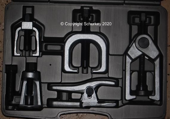

While the previous advice will "work", I REALLY HATE hammering anything to separate the ball joint stud from the steering knuckle.  Pickleforks are almost as bad.  Hammering, or pickleforks both have the potential to damage the parts they're applying force to.
I've put ball joints into multiple vehicles--'66 Toronado, '68 El Camino, '88 K1500 6-lug, '97 K2500 8-lug, and '03 Trailblazer are the most-recent.  I have not put ball joints into my '92 and '93 Luminas, or '98 Monte Carlo, though.
I've been using a readily-available "Front End Service Set" that has various tools for separating tapered studs from tapered holes.   If you have access to slide one of these tools in place, they're a ZERO-DAMAGE method of popping the stud out of the hole.  My particular set came from NAPA, but the EXACT SAME tools are sold by Gearwrench and OTC; and lower-quality knockoffs are sold by dozens of other vendors.
