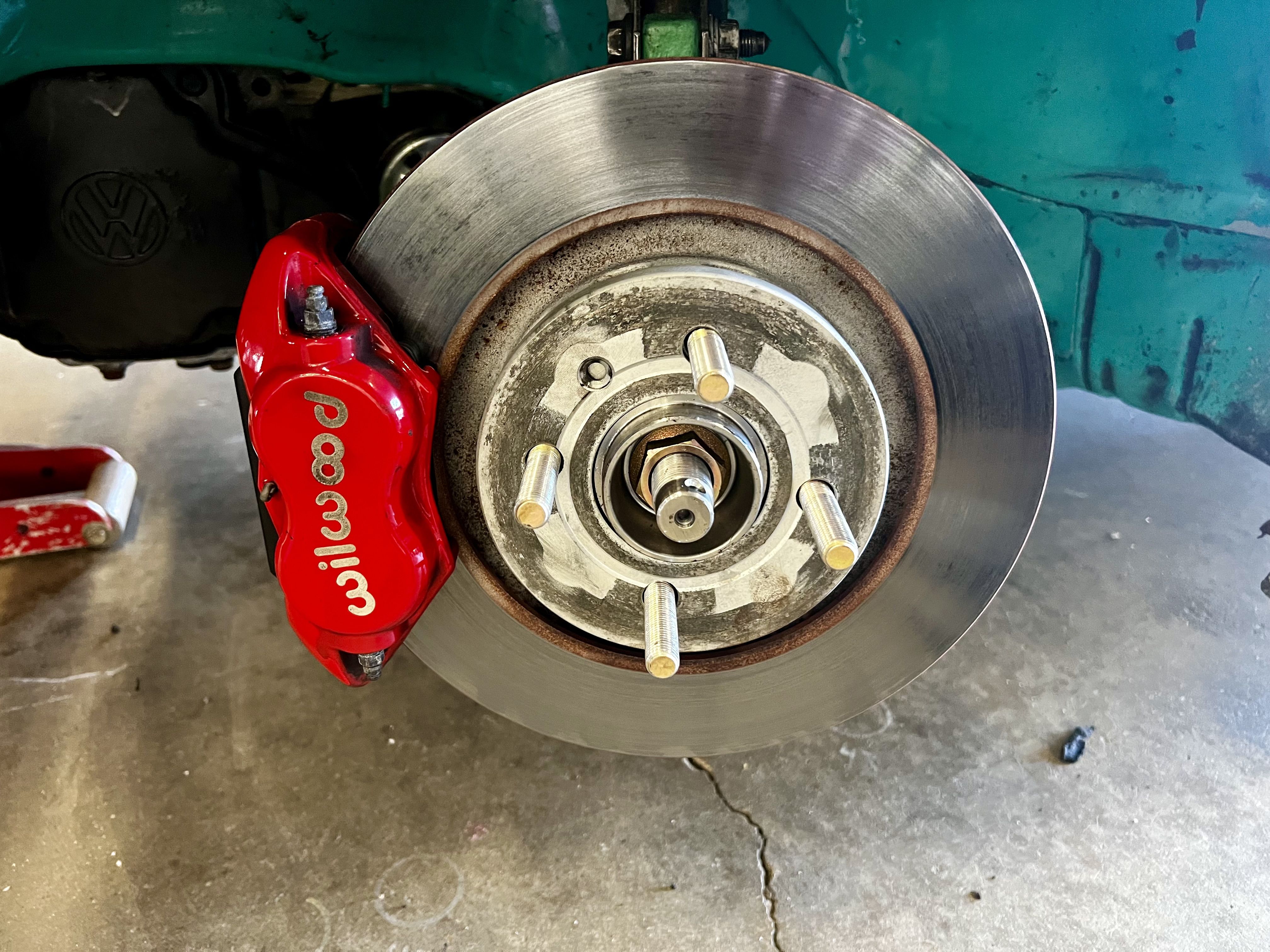

Vegeta Posted October 18, 2024 Report Posted October 18, 2024 Has anyone adapted a Wilwood caliper setup? I had 96 Grand Prix brakes on a 92 before, and figured that would be the best I can do without cut/weld. Quote
Amanita Posted October 18, 2024 Author Report Posted October 18, 2024 6 minutes ago, Vegeta said: Has anyone adapted a Wilwood caliper setup? I had 96 Grand Prix brakes on a 92 before, and figured that would be the best I can do without cut/weld. Are the '96 brakes bigger? I didn't know there was a difference. Quote
Vegeta Posted October 18, 2024 Report Posted October 18, 2024 I forget the sizing but yes, bigger front for sure, and the back is either bigger, or just a better design. The parking brake cable was modified/welded until it broke, so it will be an issue. Have to swap to the 96 strut/hub, and I think the rears bolt on? I didn't do it, previous owner was road racing the car and had it setup with those brakes. Amanita 1 Quote
SuperBuick Posted October 18, 2024 Report Posted October 18, 2024 If going through that work, unless wilwood is the only option, id try a brembo setup before wilwood. Wilwoods are , uh, not that great, and have really small pads. Of course that may be why they are better for adapting to the w bodies. Im literally typing this while standing next to a race car im about to get into that has wilwood brakes, getting pads installed for me to bed in for the team Amanita 1 Quote

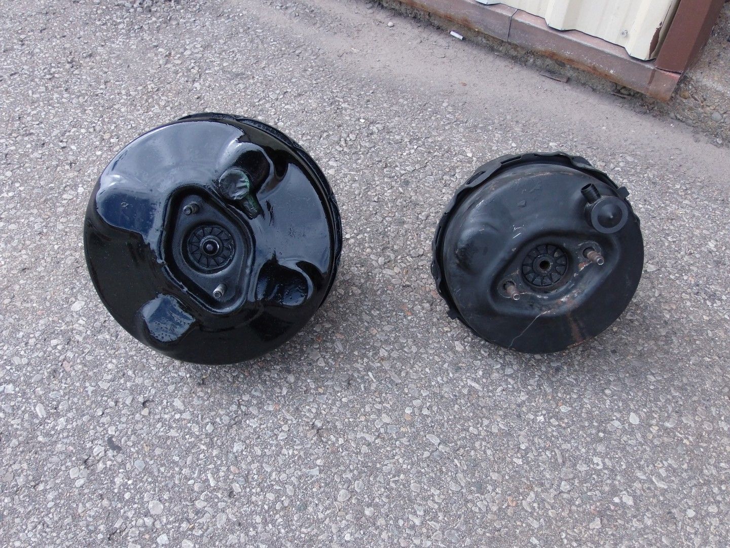

Schurkey Posted October 19, 2024 Report Posted October 19, 2024 (edited) 2nd Gen front rotors are somewhat larger diameter. As said, the whole front strut assembly is required as the caliper mounts a bit farther from the hub center. The rear calipers have a very poor reputation, although I've had ZERO problems with them on my two Luminas. As far as braking power is concerned, the big issue on my two ('92 and '93) Lumina Euro 3.4s were the VACUUM POWER BOOSTERs. Both cars had high pedal effort, poor braking performance. That seems to be a common complaint on the first-gen cars. It wasn't the front calipers, rotors, pads, neither was it a problem with the much-maligned rear calipers, or the rear rotors/pads. The WHOLE problem was the power booster. The boosters on both cars "partially" failed leading to reduced assist (almost none, yet not totally dead.) The boosters had NONE of the usual symptoms--didn't leak vacuum, held vacuum until the check-valve was removed, didn't hiss or make ugly noises. There just wasn't much assist. I installed "rebuilt" vacuum boosters sourced from CarQuest/Advance Auto, and both vehicles were immediately fixed. If I remember correctly, the brake light switch on the '92 gave me more trouble than the (updated design) brake light switch on the '93. It may be that the better solution is to install 2nd Gen boosters on the 1st Gen cars with vacuum boosters. I guess the 2nd Gen vacuum boosters are larger-diameter. Edited October 19, 2024 by Schurkey primergray 1 Quote
Amanita Posted October 19, 2024 Author Report Posted October 19, 2024 7 hours ago, Schurkey said: 2nd Gen front rotors are somewhat larger diameter. As said, the whole front strut assembly is required as the caliper mounts a bit farther from the hub center. The rear calipers have a very poor reputation, although I've had ZERO problems with them on my two Luminas. As far as braking power is concerned, the big issue on my two ('92 and '93) Lumina Euro 3.4s were the VACUUM POWER BOOSTERs. Both cars had high pedal effort, poor braking performance. That seems to be a common complaint on the first-gen cars. It wasn't the front calipers, rotors, pads, neither was it a problem with the much-maligned rear calipers, or the rear rotors/pads. The WHOLE problem was the power booster. The boosters on both cars "partially" failed leading to reduced assist (almost none, yet not totally dead.) The boosters had NONE of the usual symptoms--didn't leak vacuum, held vacuum until the check-valve was removed, didn't hiss or make ugly noises. There just wasn't much assist. I installed "rebuilt" vacuum boosters sourced from CarQuest/Advance Auto, and both vehicles were immediately fixed. If I remember correctly, the brake light switch on the '92 gave me more trouble than the (updated design) brake light switch on the '93. It may be that the better solution is to install 2nd Gen boosters on the 1st Gen cars with vacuum boosters. I guess the 2nd Gen vacuum boosters are larger-diameter. Did the '96 cars have an updated booster? Granted, the '96 has much more aggressive pads and is a couple hundred pounds lighter, but I think the braking performance between my '96 and '98 is pretty similar all things considered. I know brake conversions exist, but for now I'd like to keep the car mostly stock. Quote
Vegeta Posted October 19, 2024 Report Posted October 19, 2024 I don't know much about brake brands, just that there are aftermarket options;) RSM used to sell a kit to swap in a corvette front rear setup. 13" front 12" rear I believe. That made a big difference, and it was cutting the 2 bosses off the front and welding them to a new spot (not a lot of work, just spacing, not offsets), and the rears used a bracket adapter. Quote
Schurkey Posted October 19, 2024 Report Posted October 19, 2024 (edited) 2 hours ago, Amanita said: Did the '96 cars have an updated booster? Far as I know, everything '95 model-year and newer had the better booster. Some of the first-gen cars had the goofy ABS system that didn't use a vacuum booster--the ABS system also did brake assist somehow. I believe that was a troublesome system; but I don't really know anything about it. Edited October 19, 2024 by Schurkey Quote
55trucker Posted October 19, 2024 Report Posted October 19, 2024 5 hours ago, Amanita said: Did the '96 cars have an updated booster? Granted, the '96 has much more aggressive pads and is a couple hundred pounds lighter, but I think the braking performance between my '96 and '98 is pretty similar all things considered. I know brake conversions exist, but for now I'd like to keep the car mostly stock. The revised booster was introduced with the '94 year. It is physically larger than its predecessor, if one wants to *update* ones older car to this booster it is NOT a simple drop in. But it is an definite improvement to the system, being a larger double diaphragm design it does supply more boost & reduces the pedal effort dramatically. Amanita and Schurkey 1 1 Quote
55trucker Posted October 20, 2024 Report Posted October 20, 2024 On 10/14/2024 at 11:02 PM, Amanita said: I've got another possible track date coming up, and I'm starting to push the limits of the EBC Redstuff pads I've been running for the past 6 track days plus 35,000+ miles on the street. I'm looking for something more aggressive since this isn't my daily driver anymore. EBC offers a direct upgrade in braking performance with their yellowstuff pads, but I've heard people say they're not the best brand. Any recommendations for pads? Additionally, has anyone used Bosh 5.1 or Motul RBF 600/660 brake fluid? Take a look at EBC's SR series pads, they are sintered, seeing as you're not using the car as a DD these may be what you're looking for. Quote
Schurkey Posted October 23, 2024 Report Posted October 23, 2024 (edited) On 10/19/2024 at 6:00 PM, 55trucker said: The revised booster was introduced with the '94 year. It is physically larger than its predecessor, if one wants to *update* ones older car to this booster it is NOT a simple drop in What is required to change to the '94-newer booster? I thought it screwed into the mounting bracket just like the original. Different pedal-to-booster rod? Interference with the larger diameter? Edited October 23, 2024 by Schurkey Quote
55trucker Posted October 23, 2024 Report Posted October 23, 2024 (edited) 2 hours ago, Schurkey said: What is required to change to the '94-newer booster? I thought it screwed into the mounting bracket just like the original. Different pedal-to-booster rod? Interference with the larger diameter? For any individual who owns a 91-93 LQ1 equipped car the process of installing the newer designed booster is not a simple process. The issue is not the booster itself, both old & newer booster use the same cam-lock design to fasten it into place, it is the additional alteration of the plumbing around the larger booster. The inlet heater core piping has to be relocated to accommodate the larger diameter booster. The 94 model year saw GM redesign the a/c for the vehicle, 134a was introduced in 94, the back end of the a/c compressor was redesigned & saw a new manifold assembly fitted to it, the accumulator/drier was reconfigured by replacing the fittings with a newer different thread pitch so the older manifold assembly will not connect it at all, the same for the 94+ condenser, the fittings are not interchangeable with the older pieces. The a/c fluid return piping from the evaporator core for the older system will interfere with the larger diameter booster, so one has to replace that older piping with the newer design which redirects the piping in behind the booster down & away from the bottom of the booster so the newer booster will mount & lock into place. I discovered all of this at the time I did the upgrade to the newer larger booster, I had to remove the heater piping & cut it in multiple places to braze in extensions to move the inlet further to the left side of the new booster. I purchased the later 94+ a/c fluid piping & accumulator/drier from Rockauto, (I already have the newer 134a compressor & manifold installed into the car) because I still have the older design condenser (a new one) in the car I had to cut off the fittings of both of the ends of the manifold hose assemblies (old & new) that go to the condenser & then tig on the older pitch fitting to the newer hose so that the fitting would screw into the older design condenser. All this took me about 2 weeks to do as I had to wait for delivery of parts from Rockauto, but after it was completed the *new* brakes are well worth the effort I went to. Edited October 23, 2024 by 55trucker Schurkey 1 Quote
