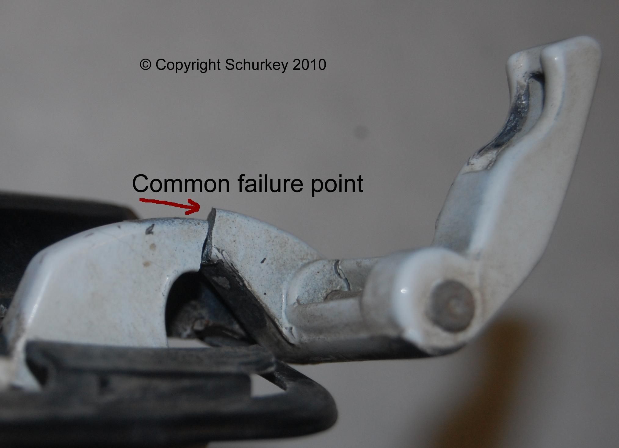

I don't know about '95, but I broke a lot of door handles (shitty metal on both Genuine GM, and Dorman replacements) on my '92 Lumina Euro 3.4 until I grabbed the metal rods the door handles activate, and pulled 'em back into proper shape.
The metal rods aren't stiff enough, they bend, and then the door handle has to be abused to get the door latch to work.2010Feb26023.jpg.deaa475733efbea196986442bdeac2e9.jpg

Absolutely.  The handles are made from crappy metal.  Even so, they work OK but only if the rods they activate aren't bent.  And the rods are also not sturdy enough.
In short, the rods are the primary problem, but the handles suffer the consequences and take the blame.  This is made worse in freezing weather, when precipitation causes ice to form along the door seals, "freezing" the door shut.  Not only do you have to pull on the door handle to unlatch the door, but you've also got to pull on the handle to break the ice "gluing" the door shut.  The handles are not sturdy enough, which is the secondary problem.
