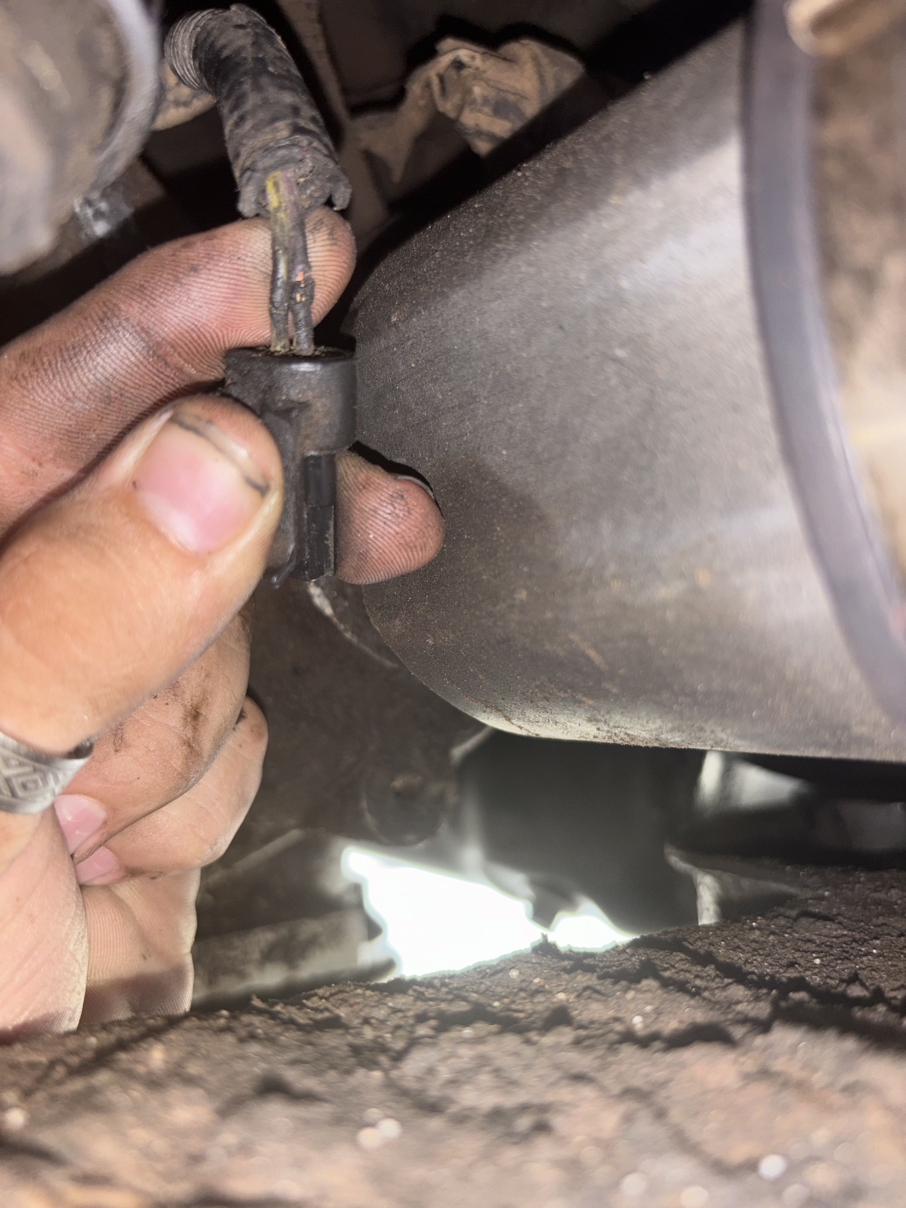

skatey Posted August 22, 2024 Report Posted August 22, 2024 I wanted to ask you a couple questions regarding the vss system, so a couple days ago my Spedo started to jump and the transmission shifts gears while it’s jumping, I’ve replaced the speed sensor on the transmission then I noticed a small cut on the pigtail and put a new one on there too. The problem continued so I checked my abs connectors and cleaned them up and it seemed to get better but still was messing up, now when I let off the thottle that seems to be the time that the car likes to go crazy and usually blipping the gas helps set it back to normal but earlier it seemed to throw itself into neutral and when I pushed the gas the power wasn’t transferring to the wheels when I was moving and the speedometer said 0. I’m having a hard time diagnosing this because I’ve done everything I could have thought of and talked to others about it. What I believe lead to this was an undercarriage wash and maybe water crawled its way up. Now where, I have no clue. If you have some input to throw in that would be helpful. The video attached is only part of what’s happening but it’s around when it started. IMG_1987.mov Quote

skatey Posted August 22, 2024 Author Report Posted August 22, 2024 Just now, skatey said: While working on the sensor i had noticed a small cut in the rubber where the sensor pigtail was and wired a new one to the harness because the cut was too close to the male end to rewire the old one. Also bumps tend to cause it to freak out because I first started seeing symptoms when I was using cruise control and hit a big enough bump it would shut off. Now I did try looking into the pcm but I couldn’t find a diagram that would show me where they ran into it and I’m also not the best at reading them. So far I’m only thoughts left on this are it’s the pcm or as you mentioned the reluctor wheel is loose and not giving accurate readings. I don’t have the funds to take this car to the shop and I’ve always done the work myself so I’m working with what I can, I do appreciate the help Quote
Black92GS Posted August 22, 2024 Report Posted August 22, 2024 If it seems to be affected by bumps, I wouldn't come close to condemning the PCM just yet. Checking the reluctor wheel should be as simple as pulling the VSS and reaching inside the hole with your finger. You should be able to touch the reluctor just enough to be able to feel for any play. It's supposed to be tight and should only want to move along with the rest of the diff. If it feels like you can move it around without much effort...then you have an idea of where to look next. At least pulling the diff on 4t65e can be done by a single person, with the trans in the car using fairly basic tools. If that checks out, you could re-install the VSS and try running the vehicle up in the air and seeing what happens. If the speedometer reading seems fairly stable, you could carefully try playing around with the wire while it's running in the air to see if you can cause it to act up. The reluctor is the silver toothed thing on the right side, and the hole for the VSS would be in the differential carrier directly above it. Quote
