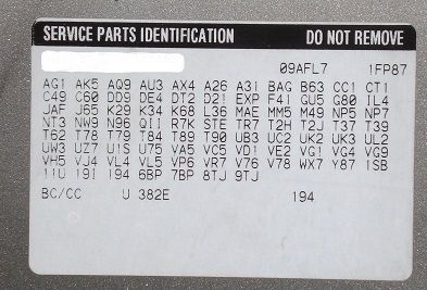

97cutty Posted August 16, 2024 Author Report Posted August 16, 2024 1 hour ago, Amanita said: FE3 should've been available as an option for any variety of Cutlass, as far as I'm aware FE1 is more common for Sedans and FE3 is more common for Coupes. '97 was a weird year though since they were phasing out the Cutlass Supreme, you can check by finding the sticker in the trunk with all the RPO codes. It looks something like this. Can’t find a sticker like that in the trunk there’s one for the tires and towing capacity. Is there anyway I can tell by looking at the suspension itself ? Quote
97cutty Posted August 16, 2024 Author Report Posted August 16, 2024 On 8/14/2024 at 5:57 PM, Amanita said: Making some Frankenstein coilovers is probably the easiest way to do it, but your car will handle worse because of it. That leaf spring in the back gives the car some extra stability that allows it to run a smaller sway bar. Keep that in mind if you want to do any sort of spirited driving with the car. you have any experience with making coilovers for these? parts, specs etc. Quote
Amanita Posted August 16, 2024 Report Posted August 16, 2024 (edited) 35 minutes ago, 97cutty said: Can’t find a sticker like that in the trunk there’s one for the tires and towing capacity. Is there anyway I can tell by looking at the suspension itself ? My car is on the other side of the state currently so I can't confirm this but I think it's under the cover for the spare tire. If it isn't there, @ManicMechanic should be able to tell you what options you have with the VIN. Checking the diameter of the rear sway bar with calipers might be the easiest way to know if you have FE1 or FE3 otherwise. I think FE3 rear sway bars are 12mm, I do not know what size FE1 sway bars are, or if first gens even have them at all. Second gen FE1 cars have massive sway bars in comparison, around 20mm in diameter. My '96 Grand Prix has FE3 suspension and it is pretty nimble, my '98 Grand Prix has FE1 and it is really prone to understeer. 31 minutes ago, 97cutty said: you have any experience with making coilovers for these? parts, specs etc. I do not, there's a thread somewhere on this site that talks about making them but it has been years since I read through it. I'll look for it tomorrow when I get a chance. Edited August 16, 2024 by Amanita Quote
97cutty Posted August 16, 2024 Author Report Posted August 16, 2024 (edited) 9 hours ago, Amanita said: My car is on the other side of the state currently so I can't confirm this but I think it's under the cover for the spare tire. If it isn't there, @ManicMechanic should be able to tell you what options you have with the VIN. Checking the diameter of the rear sway bar with calipers might be the easiest way to know if you have FE1 or FE3 otherwise. I think FE3 rear sway bars are 12mm, I do not know what size FE1 sway bars are, or if first gens even have them at all. Second gen FE1 cars have massive sway bars in comparison, around 20mm in diameter. My '96 Grand Prix has FE3 suspension and it is pretty nimble, my '98 Grand Prix has FE1 and it is really prone to understeer. I do not, there's a thread somewhere on this site that talks about making them but it has been years since I read through it. I'll look for it tomorrow when I get a chance. Ok I’ll need to look into my suspension more after I get out of school to see, really appreciate it lmk if you find anything thank you for the info. Edited August 16, 2024 by 97cutty Quote

97cutty Posted August 17, 2024 Author Report Posted August 17, 2024 23 hours ago, Amanita said: My car is on the other side of the state currently so I can't confirm this but I think it's under the cover for the spare tire. If it isn't there, @ManicMechanic should be able to tell you what options you have with the VIN. Checking the diameter of the rear sway bar with calipers might be the easiest way to know if you have FE1 or FE3 otherwise. I think FE3 rear sway bars are 12mm, I do not know what size FE1 sway bars are, or if first gens even have them at all. Second gen FE1 cars have massive sway bars in comparison, around 20mm in diameter. My '96 Grand Prix has FE3 suspension and it is pretty nimble, my '98 Grand Prix has FE1 and it is really prone to understeer. I do not, there's a thread somewhere on this site that talks about making them but it has been years since I read through it. I'll look for it tomorrow when I get a chance. Looked more and found the sticker, its the fe1 suspension Quote
Amanita Posted August 17, 2024 Report Posted August 17, 2024 (edited) 12 minutes ago, 97cutty said: Looked more and found the sticker, its the fe1 suspension You'll probably want to find FE3 parts first before you even think of switching to coilovers, the 1st gen w-body chassis is already like a wet noodle with the FE1 suspension and getting rid of the monoleaf will make it worse. I don't know if the leaf is different but you'll want the sway bars and front coil springs. The strut bar from a Cutlass Supreme convertible won't hurt either. I feel like I should also mention that not many people have attempted to remove the monoleaf, it's apparently a massive pain in the ass. Edited August 17, 2024 by Amanita Quote
