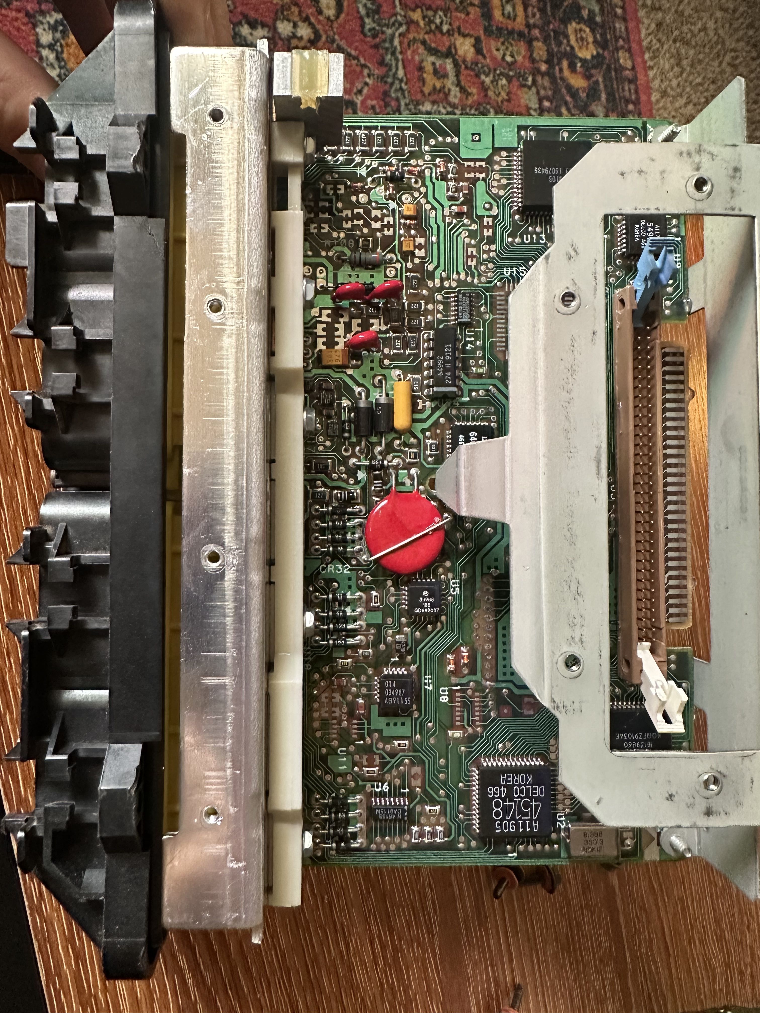

mdpierce8 Posted October 26, 2024 Author Report Posted October 26, 2024 (edited) Been a while since I updated here. Still in the same boat. I’m starting to wonder if capacitors inside the ECM can be replaced. The ecm I have installed will work perfectly for about 2 mins if left unplugged for a couple days then it turns on the SES light, the speedometer and odometer quit working, it quits managing the idle speed, and quits communication through the aldl connector all at the same time. I have another ecm open just to look around and see what I can see. I don’t see anything out of the ordinary. I can see 4 capacitors. I’m wondering if anyone here knows anything about these 1227727 ECMs and can help. Message me. Thanks! Edited October 26, 2024 by mdpierce8 Quote
Schurkey Posted October 27, 2024 Report Posted October 27, 2024 (edited) I am not an electronics expert, and I've had zero training. That said, I've replaced a bunch of capacitors in loudspeaker crossovers, a Bose 901 equalizer, a CD player, a couple of dbx 118s, and so forth. I have a "project" where I'll be replacing electrolytic caps in four different GMT400 ('88--'98 GM pickups) HVAC dashboard controllers. MOSTLY the problem capacitors are the electrolytics. They have a known service life of 20--30 years; (some sources say as little as 6 years!) and multiple ways they can fail. They can leak their electrolyte, which then corrodes the circuit board. They can drift out-of-spec, either the capacitance value, or the internal resistance, or both. And they can sometimes actually EXPLODE. Some years ago, the Chinese did some Industrial Espionage, tried to steal the electrolyte formulation from another capacitor company. They got it wrong, and caused widespread capacitor failure--the infamous Capacitor Plague. https://en.wikipedia.org/wiki/Capacitor_plague What you have look like Tantalum or dipped Ceramic caps, not electrolytic. I'm not saying they "can't" be defective, but the odds are against it. Beyond replacing capacitors, I've fixed multiple electronic devices--remote controls, windshield wiper control boards, and lots of other stuff--by looking at the circuit board with a magnifying glass, and visually verifying the solder joints. Doing nothing more than re-flowing solder on various circuit boards has brought them "back to life". Sometimes I find a printed-circuit copper trace that's melted or cracked, so I solder-in a jumper wire across the break. But doing that on a computer circuit-board seems unreasonably difficult. You'd spend entire days doing nothing but following circuit traces. Edited October 27, 2024 by Schurkey mdpierce8 1 Quote
