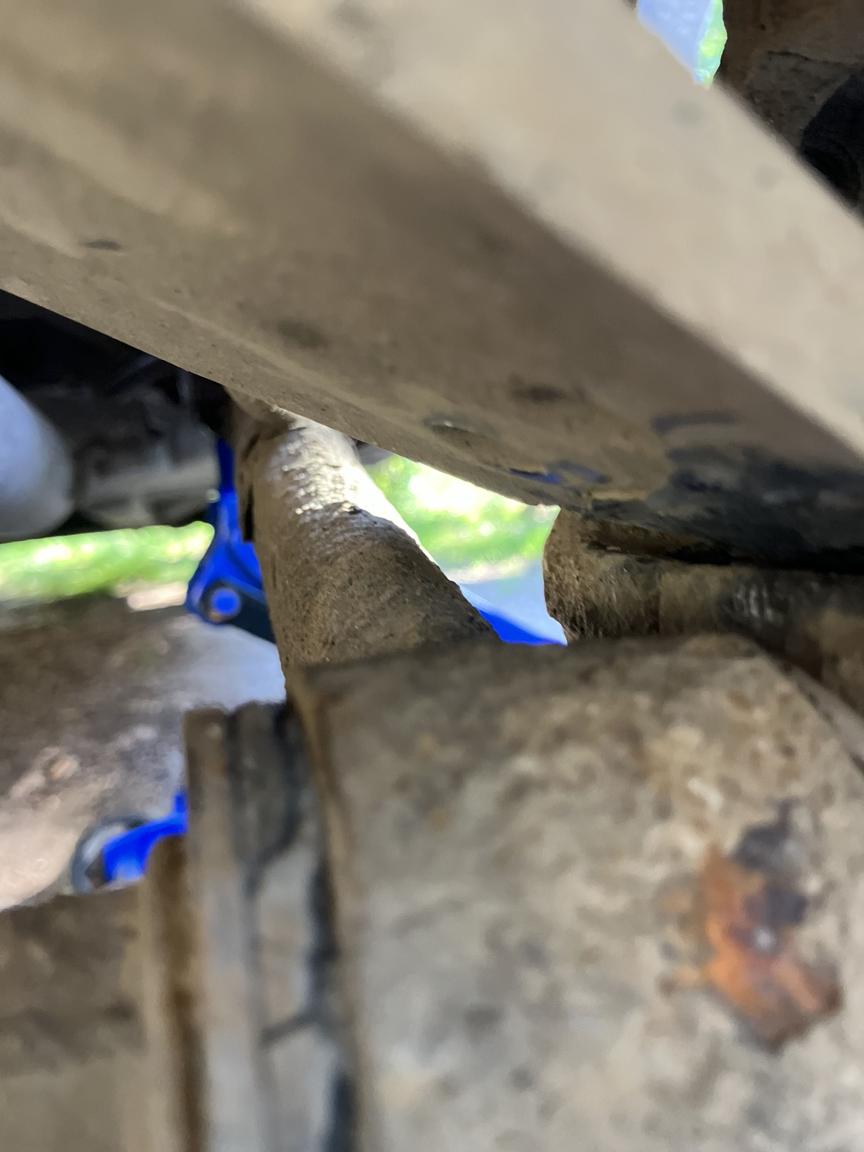

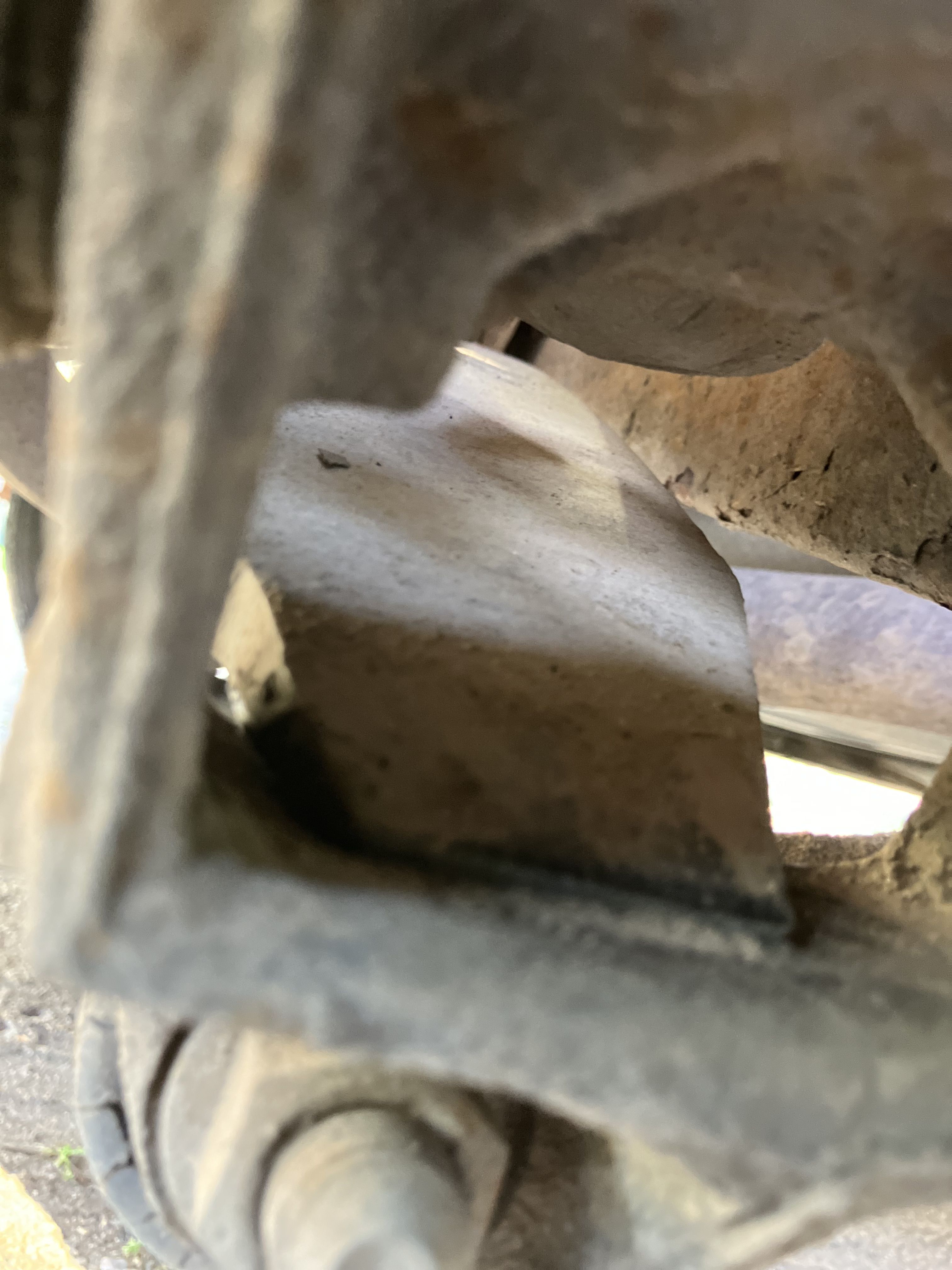

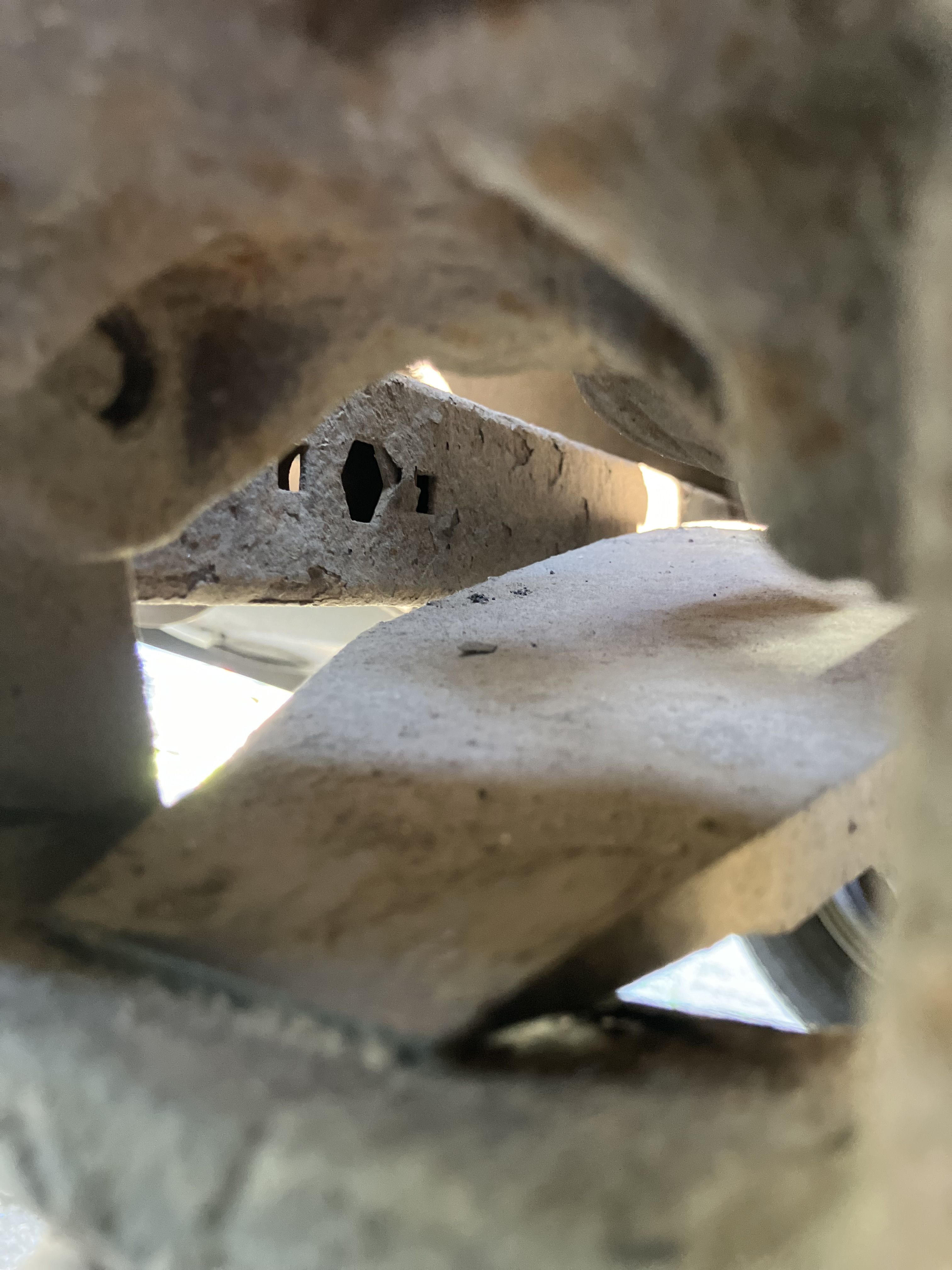

Got home driving it rawdog. Does this look OK or should I consider getting a junkyard spring to replace it withIMG_8546.jpeg.96b4444eacafd6f5b3e55683a32abcff.jpegIMG_8546.jpeg.96b4444eacafd6f5b3e55683a32abcff.jpegIMG_8545.jpeg.ed808cfbe96bb9885b9e2c10ff1751fa.jpegIMG_8544.jpeg.1287d5a554beb25e68ddad2530b09896.jpeg
should be ok once you replace those isolator pads
Do you replace by jacking up on the leaf and putting the pad in or do you have to remove the spring
In a perfect world, you'd replace the rubber pads AND install the hard nylon spacer blocks.

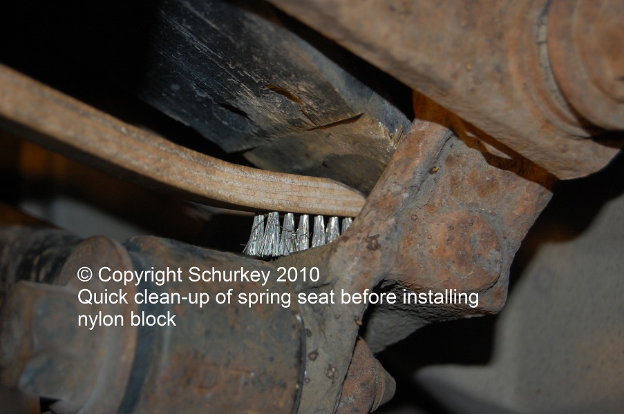

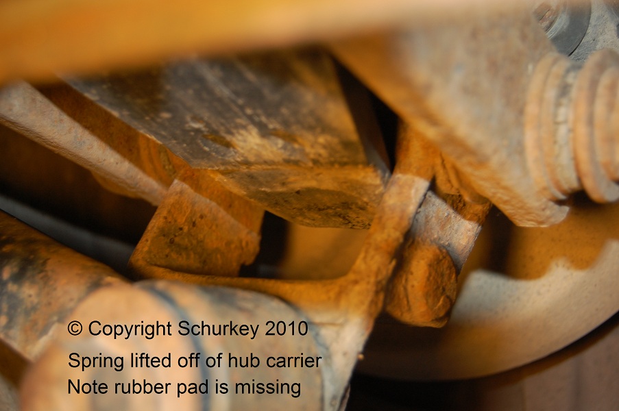

But at least replace the rubber pads.  You'll need to compress the spring for access to clean the spring, apply the SPECIAL glue, and add the rubber pads.

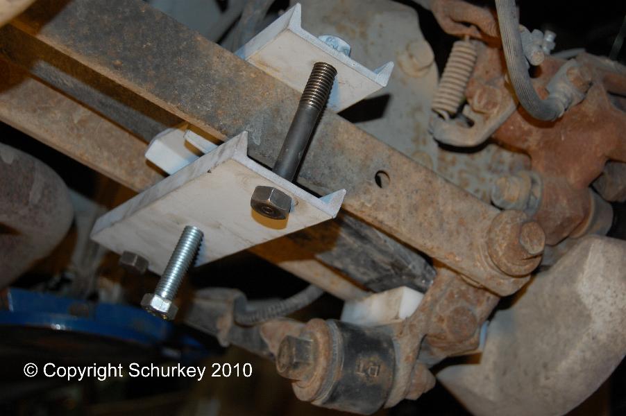

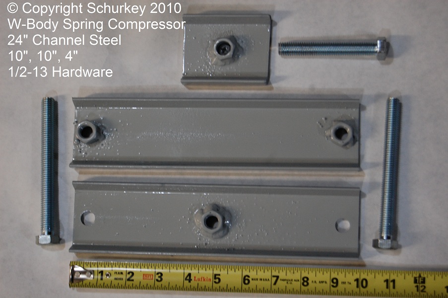

GM/Kent-Moore made a "special tool" to compress the spring.  Another option is to build your own spring compressor.  Cheaper than getting the "real" tool from eBay or wherever, but requires some fabrication.

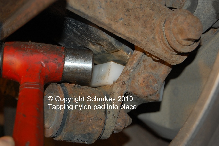

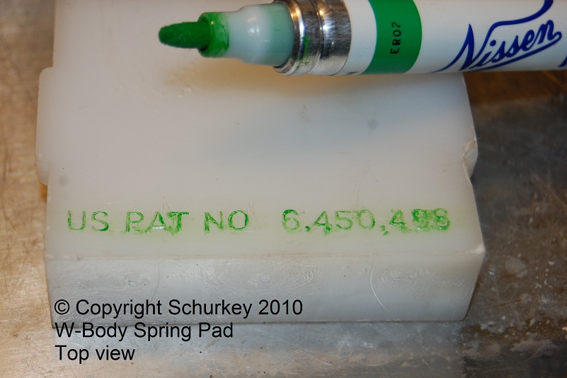

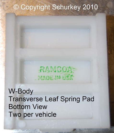

Plastic blocks are NAPA 274-7050 or equivalent.

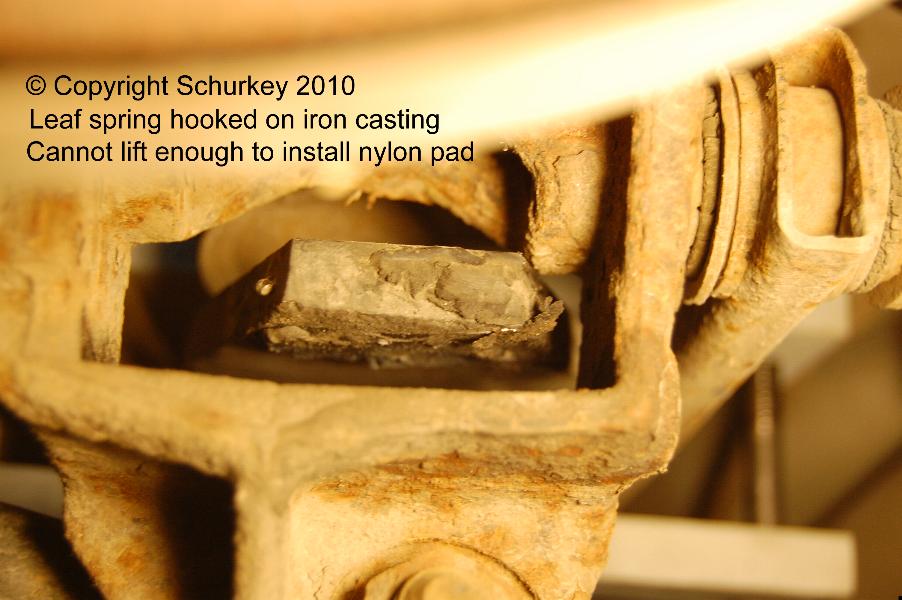

Make sure the leaf spring is centered in the casting, otherwise when you jack it up, it gets caught on the iron.  If this happens, cram the spring over so it clears.W-Spring14.jpg.b446a1b9f540cd314ffa59d47e8aecb6.jpg

Would using a wood block on the leaf and jacking up on it with a floorjack also work? If not could someone provide a link to buy the spring compressor
You might be able to jack the spring up with a floor jack and block of wood.
You can make the spring compressor like I did.
You can MAYBE buy a spring compressor--the genuine GM "special tool" J-35778--from eBay.  That's where I got mine, years after I invented my own.

Dorman does make an OEM replacement for the lost rubber insulator, but there's much to do to get the bottom side of the old spring clean enough so that the included adhesive with stay there.
Your knuckle castings are looking mighty rough, a smooth surface is needed for the rubber isolator to properly flex, all that rust more than likely had something to do with the isolator breaking free.

The plastic blocks DO NOT "replace" the rubber pad, although that was a common misconception when I installed them on my cars.  My cars went years with the fiberglass spring rubbing on the nylon pads--but that's not how they're SUPPOSED to work.
You need the rubber pad on each end of the spring whether or not you have the nylon blocks.  The new rubber pads come with "special" glue, in fact it's so "special" that they won't ship it in the winter because it's not supposed to freeze in the tube.  Once it's applied and dried, it can freeze, but not before then.  (Or the glue is different now...)  The rubber pads protect the spring, and are ESSENTIAL.  The plastic blocks are nothing more or less than a spacer that lifts the back of the car by the thickness of the block, to compensate for the spring settling.
The plastic blocks are held in place by the tension of the spring.  No glue, no muss, no fuss.  Pop 'em into place and you're done.
