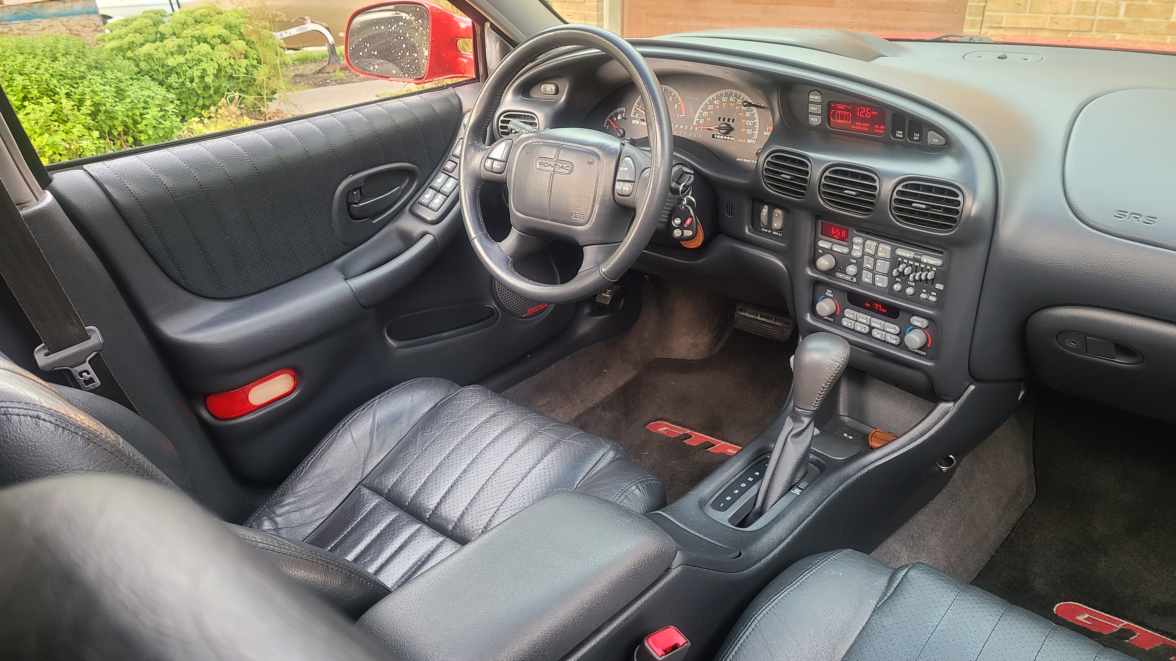

rcLord510 Posted June 1, 2024 Author Report Posted June 1, 2024 Just now, 94 olds vert said: Mine is just 2 dials with buttons. When set to a temp it will automatically adjust the fan speed. First of all beautiful gtp!! Second of all I did a comparison and the only difference between the 2 is 1. It shows inside temp and outside temp on the ecc and doesn’t on mine obviously(no screen) and 2 it has a little different button selection and it automatically adjusts the fans like you said, however since that is done in the unit, I’m wondering if(because I’m guessing mine also has at least the inside temp sensor) that if i connect solder on the connecter for the ecc and confirm that I’ve made the right connections with schematics, in theory everything should work the same, I’m really hoping at least… 94 olds vert 1 Quote
94 olds vert Posted June 1, 2024 Report Posted June 1, 2024 1 minute ago, rcLord510 said: First of all beautiful gtp!! Second of all I did a comparison and the only difference between the 2 is 1. It shows inside temp and outside temp on the ecc and doesn’t on mine obviously(no screen) and 2 it has a little different button selection and it automatically adjusts the fans like you said, however since that is done in the unit, I’m wondering if(because I’m guessing mine also has at least the inside temp sensor) that if i connect solder on the connecter for the ecc and confirm that I’ve made the right connections with schematics, in theory everything should work the same, I’m really hoping at least… First off thank you. That GTP is like my baby lol If you manage to connect the ECC to the proper wires it should work. I don't know exactly what wires are what in these cars for the climate control units. Mine shows outside temp and whatever temp I set the dials to. I would probably go to a junkyard and grab as much wiring harness from a car that has ECC and start figuring out where all those go so you can tap into the correct wires. Quote
