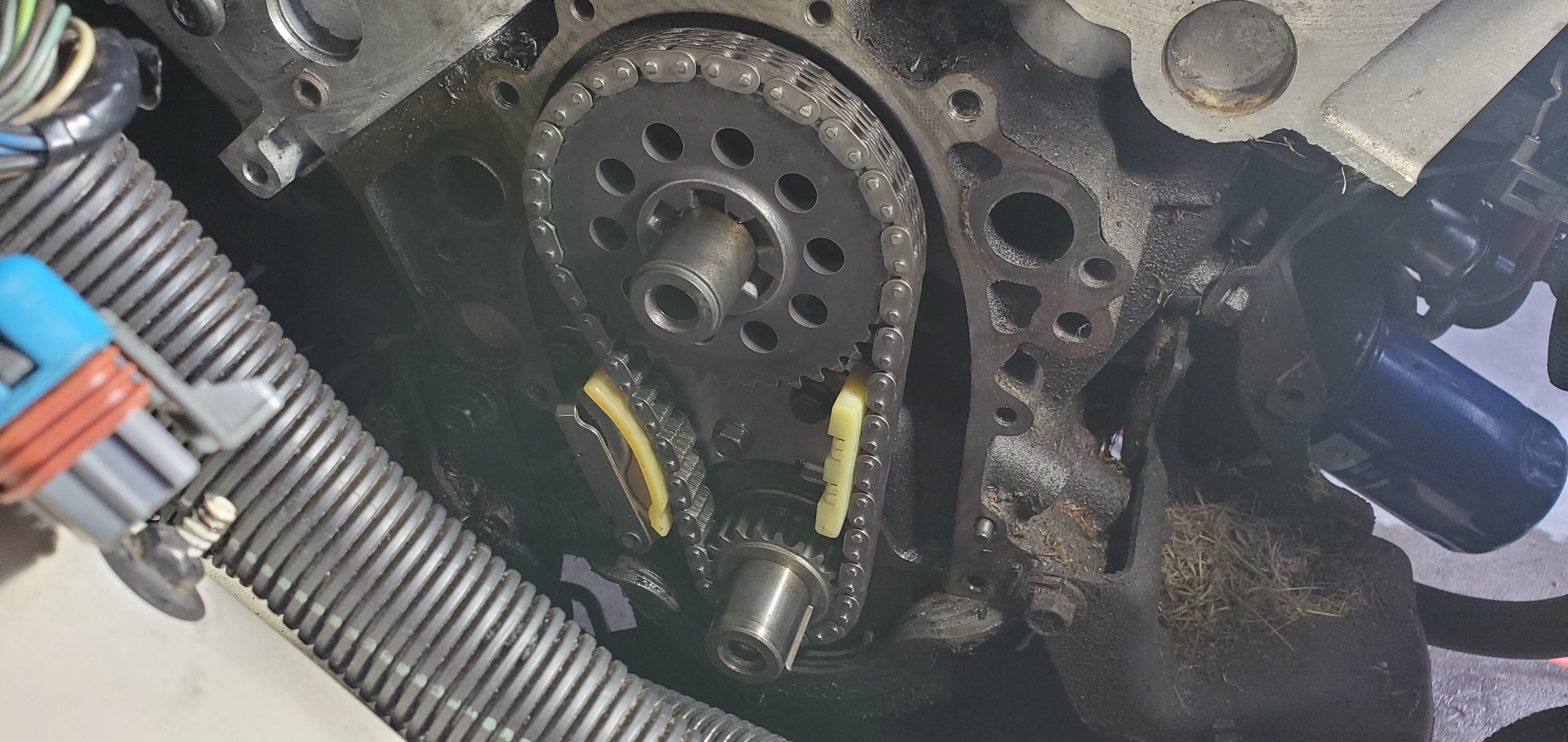

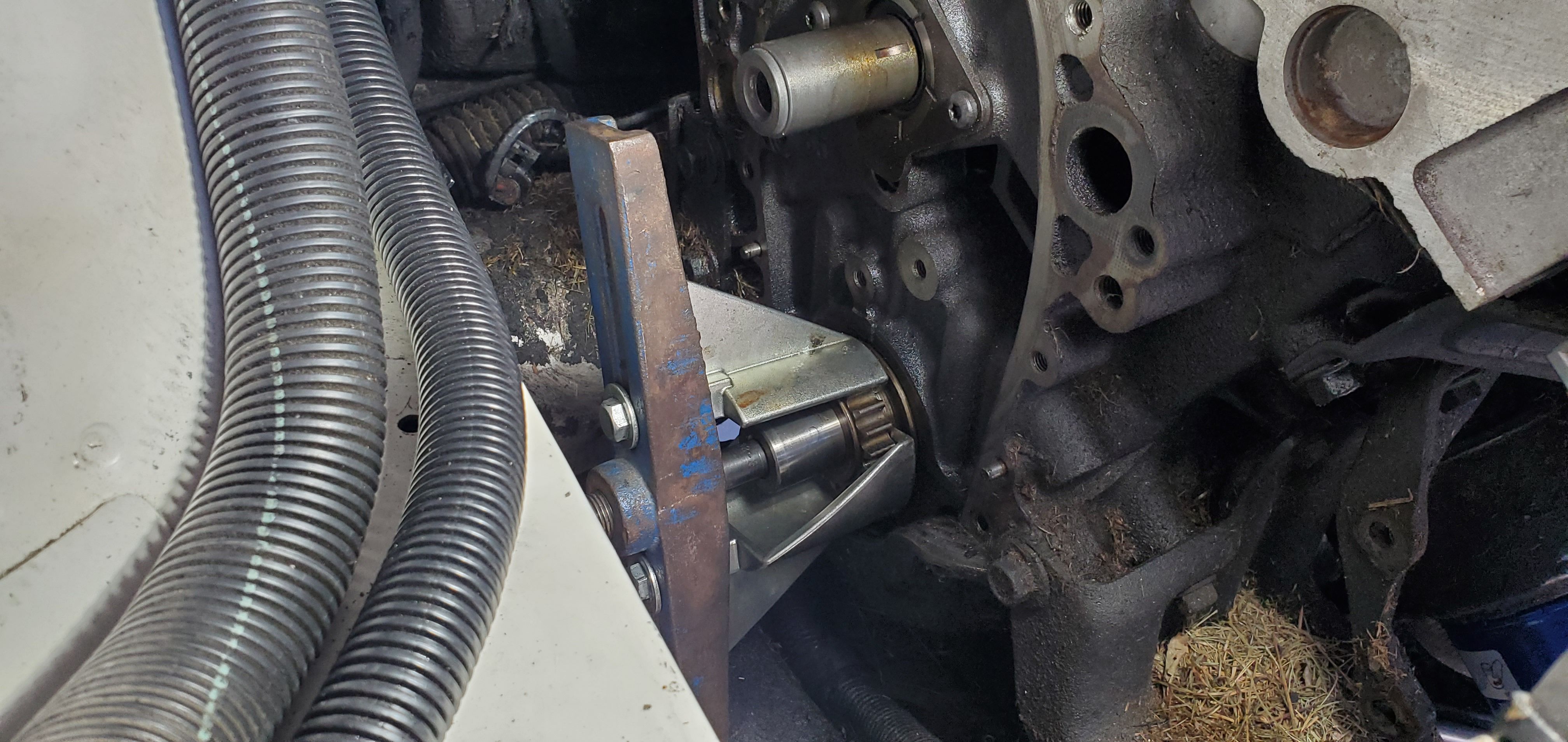

This tool right here, this puller, is an absolute blessing!  After my local GM dealer said my original motor had a timing issue...and I knew the belt was good and timed correctly, I assumed it was the timing chain.  This is a puller for the timing chain and sprockets.  The chain and sprockets have to be pulled as one unit due to how they're designed like most timing chain systems.  Because of the tight tolerances between the dampener/nose of the crankshaft and right side frame rail, a conventional puller to my knowledge won't fit in that area.  I even rented the smallest puller they had a my local parts store and it was still way to big to even try and lock onto the sprockets.  I found this bridge puller I think it's called years ago on Ebay.  SO GLAD I BOUGHT IT!!!!
The GM dealer wanted to either drop the engine cradle on the passenger side or if need be, drop the entire cradle and drivetrain out of my Olds International Cutlass for the repair.  Total bill was going to be estimated between $5500-6500.  This bridge puller allowed me to do the job myself and only costing me about $100 bucks.  This includes the price of the puller, the chain/sprockets, and the guides.  This kit also included the tool to drive the crankshaft sprocket and dampener back onto the crankshaft.
The repair process and bridge puller being used.  You can see the tight tolerances of where this tool needs to work and how beautifully it all fit together.  Again, this specialty tool saved me THOUSANDS of dollars!
