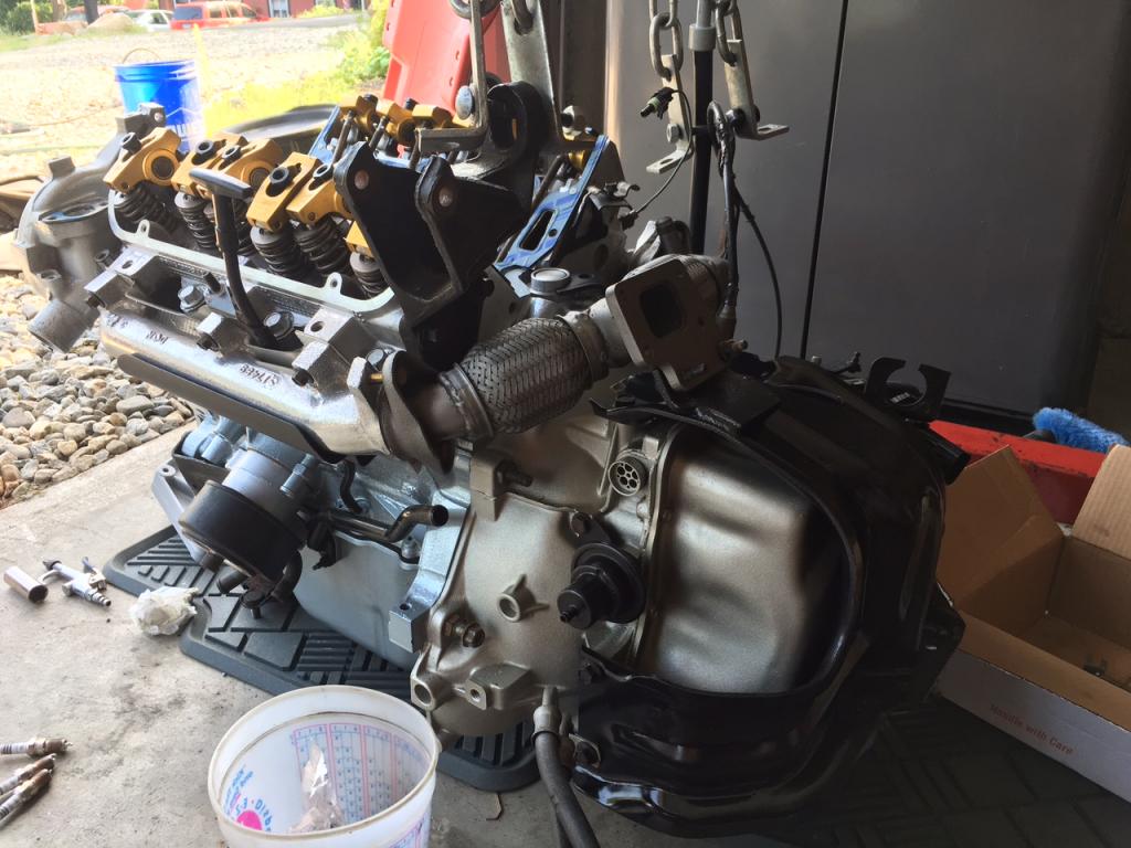

55trucker Posted May 11, 2024 Report Posted May 11, 2024 A repaired crossover will look like this..... I don't personally know where the turbo flange gasket is available from anymore. Where your *lack of boost* issue is concerned remove the actuator arm from the wastegate valve & try to move the valve lever. It should not be seized. Now test the pressure diaphragm inside the dashpot using a simple handheld vacuum pump to see if the diaphragm has not failed, you're looking for no loss in the reading on the vacuum gauge. The wastegate is normally *closed* due to a return spring inside the dashpot. You'll need to test the wastegate solenoid as well, the solenoid is also closed by default which causes the boost pressure from the turbo to open the wastegate to reduce boost pressure to the engine. Sort out your DTC's first, the turbo wastegate being open shouldn't upset the engine at idle as the wastegate is open at idle, as long as the engine is running the turbo is supplying various amounts of boost. johnnynotell 1 Quote
rich_e777 Posted May 11, 2024 Report Posted May 11, 2024 5 hours ago, johnnynotell said: Thank you guys for chiming in. I do need those to diagnose better. The fuel injectors are coming and I did replace the alternator for the high voltage. I must have code 43 wrong 55 trucker. I came up with knock sensor error. I will look into it better. Nice to meet you Rich with the tgp. Not to look too far ahead but how did you go about fixing the crossover? I plan to remove it and take it to an exhaust shop and have them do their magic. Thinking I should buy a couple of these flex pipe things. Not sure the diameter of the pipe yet though. Fortunately my crossover pipe still seems in good to ok shape for now but its something Ive looked into replacing for sure. Going by the supplement the crossover comes off without any specific instructions really aside from rotating the engine to get at the "rear" of the engine. johnnynotell 1 Quote
