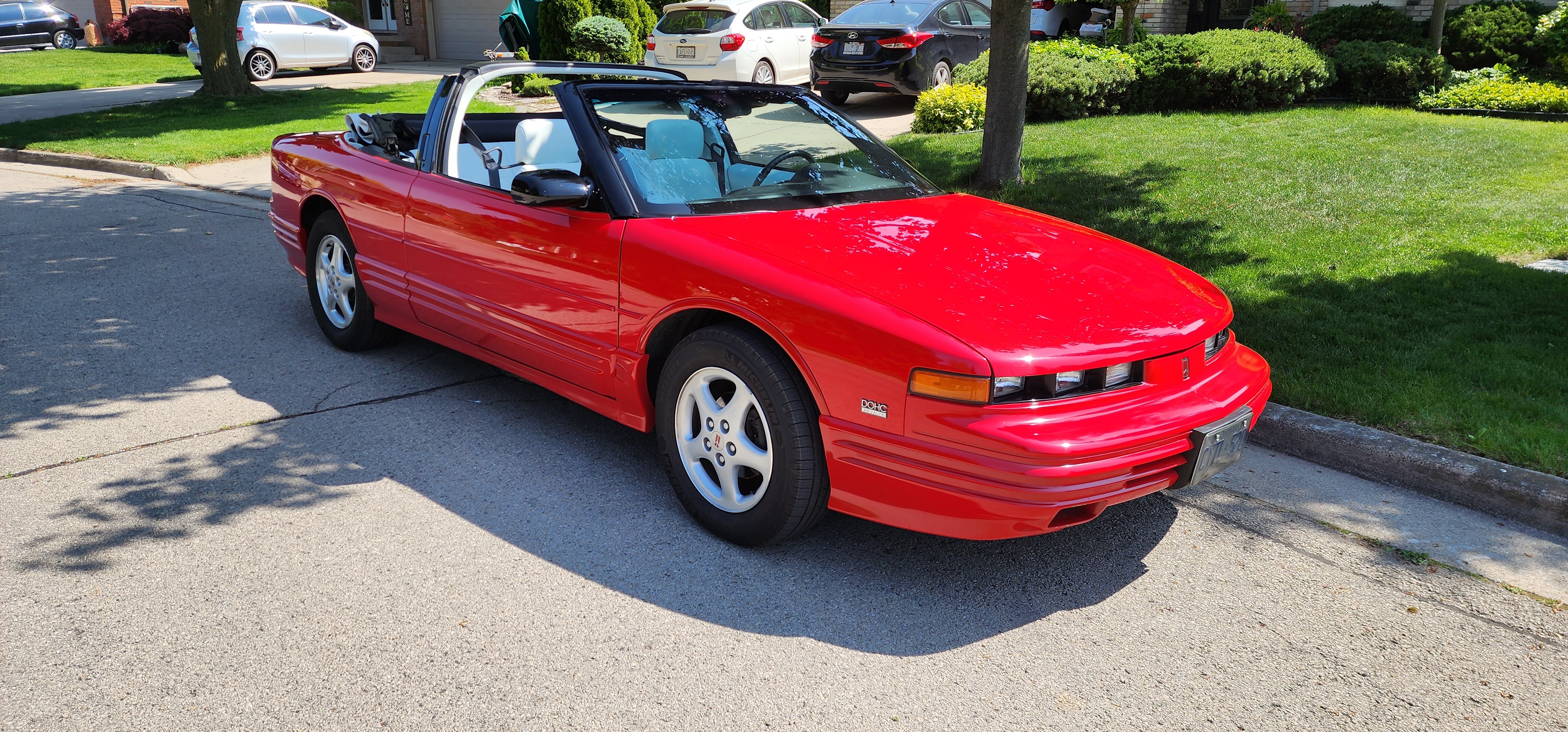

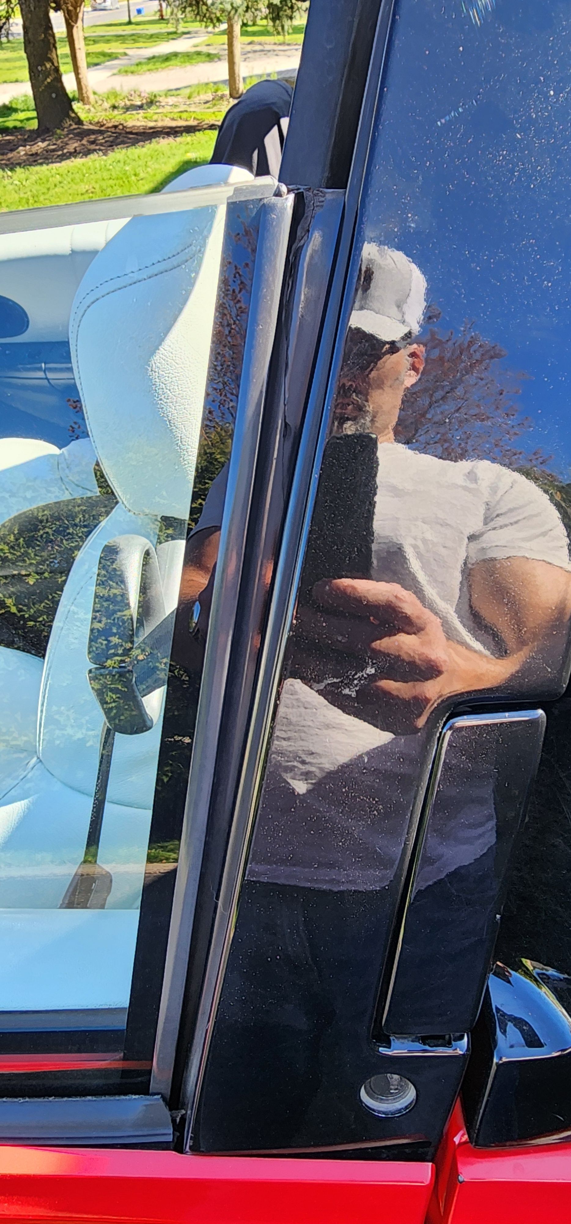

JGP Posted May 2 Author Report Share Posted May 2 (edited) So sorry, here I am asking for help and I go off the radar. Here is the pic...it looks like it's attached to the glass actually. I've attached also a pic of the car - such as shame as everything is perfect on it, 13,000 original miles. Love to get this fixed. Sorry the pic looks so huge. Edited May 2 by JGP jiggity76 and 94 olds vert 2 Quote Link to comment Share on other sites More sharing options...
jiggity76 Posted May 3 Report Share Posted May 3 (edited) Very beautiful car that's for sure! Unfortunately, that part isn't a separate part from the door glass. In other words, that rubber seal or gasket came attached to the door glass and was installed on the assembly line from GM's glass supplier. Whoever supplied the glass for our cars, that was included at their manufacturing facility. GM just gives a part # for the entire door glass and not just for that seal. I'm guessing you'll have to find a door glass with a good seal already attached, or somehow figure out how it's attached to the glass, and swap it over to your vert. It might be better to talk with a glass supply/repair shop or just swap out the entire glass with another one that has a good seal. GM's part # for the entire door glass is 10188181. That number isn't showing that any are available NOS anymore. Again, your only options are glass shops or a good used glass with that seal from a junkyard or parts vehicle. If you're interested, I might know a guy who has a stash of parts convertibles and he will more than likely have a good door glass with that seal. By the way, for 1995, only 338 cars were made in Bright Red, White interior, and White top. Edited May 3 by jiggity76 Quote Link to comment Share on other sites More sharing options...

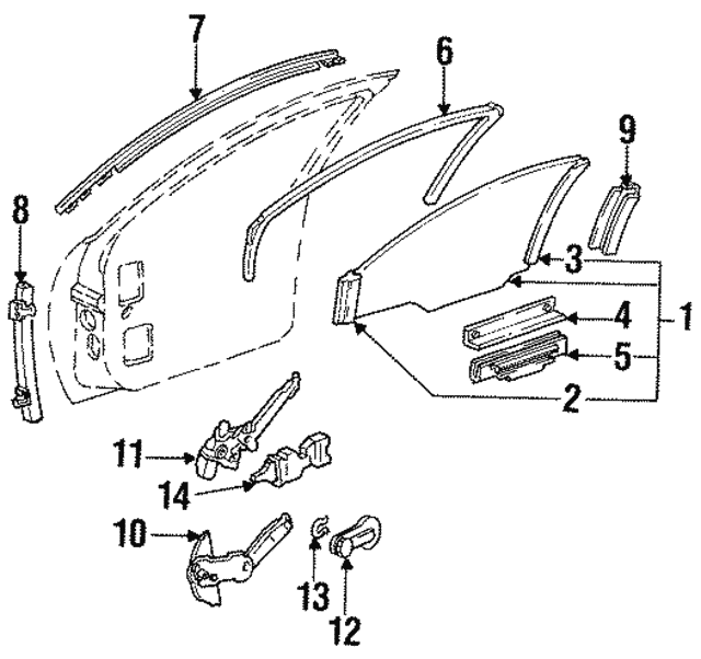

JGP Posted May 3 Author Report Share Posted May 3 Take a peek at this picture, what is part #9? Almost would make you think it's this part that is attached to the glass - no? Quote Link to comment Share on other sites More sharing options...
rich_e777 Posted May 4 Report Share Posted May 4 # 9 is the handle, that part will work on either a hardtop or convertible. I`m into mine now and will get into the manuals as well. Looking at my car I see no difference in the print on either side and I seem to recall an old thread where these numbers where exhaustively searched with no luck. Door Glass: Soft-Ray PPG Saftey Flow-Lite 27 4 AS-2 DOT 18 M504 1 2 4 PPG has flexible coatings and this part couldve been a custom run through an application process during the time the convertibles were being built. Not unlike how a company might send a few hundred parts to be chrome plated. This looks like it falls in line with the on going research into replacement rubber seals specific to the Cutlass Supreme convertibles. Quote Link to comment Share on other sites More sharing options...
rich_e777 Posted May 4 Report Share Posted May 4 #7 looks a little closer but still might not be it. RH#10128048 LH#10128049 Another FSM pic Quote Link to comment Share on other sites More sharing options...

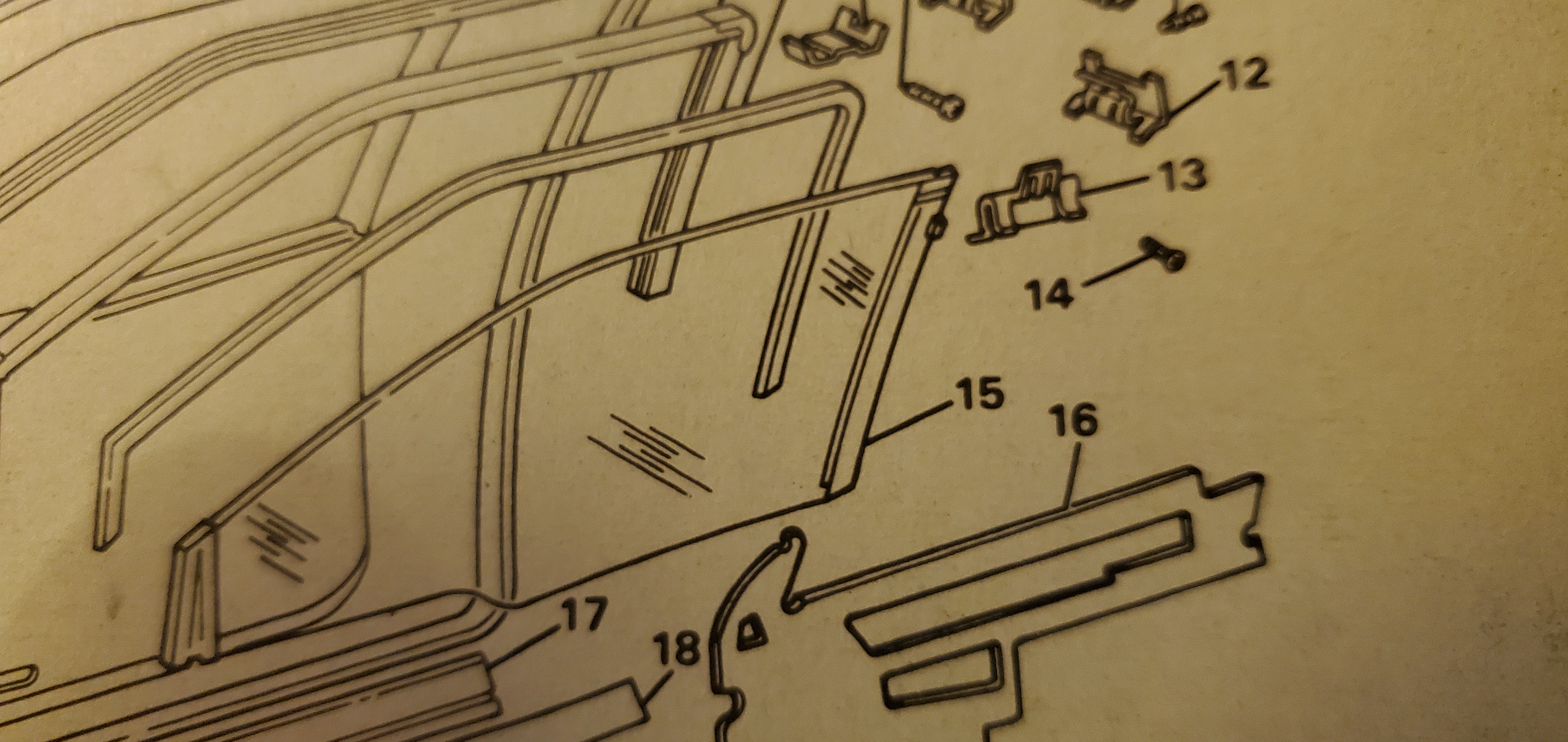

jiggity76 Posted May 5 Report Share Posted May 5 Here's a pic from my book. Mind you, it's from a coupe but we should all know that convertibles started life out as coupes. Number 15 in the pic. rich_e777 1 Quote Link to comment Share on other sites More sharing options...

JGP Posted July 30 Author Report Share Posted July 30 (edited) Any luck contacting your friend? As it would have it, the part has completely cracked and the window slipped out of positioning. I managed to get it back on the track properly, but I am certainly now in dire need to find the window guide or a replacement glass. Problem is most pictures you find on-line depicting parts are not of the 2 door vert. I do believe (however) there is a front and rear window guide, the one attached to the back side of the drivers door glass was referred to as the "rear-guide". I suspect they did (at one point) sell this part separately - a few glass shops seem to confirm this, but I've yet to see a proper part number - even in my factory manuals. Any help is appreciated. Edited July 30 by JGP Quote Link to comment Share on other sites More sharing options...

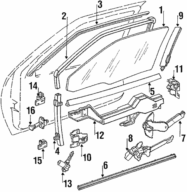

JGP Posted August 1 Author Report Share Posted August 1 (edited) Aside, part #110188185, the guide that sits (as you state) on the glass side near the mirror is identical in construction to the rear guide and is affixed the same way on the glass. Without it, the window will fall out of position. I am thinking there has to be a part number for this somewhere! I found this, showing a front guide and rear guide (#3) on seemingly the side glass(Part number 10180417), but for a 4-door? Pictures of the 2 door don't show this part; However, 10180417 is supposed to compatible. To thicken the plot, the pictures of the part on eBay don't seem right - & they look far too small. Edited August 2 by JGP updating Quote Link to comment Share on other sites More sharing options...
rich_e777 Posted August 4 Report Share Posted August 4 Oh man I see what you mean now. That doesn't appear to be a replaceable part, seems like a piece glued to the glass to support it in the track. Having a 95 Vert and 94 coupe side by side the door glass appears to be the same but a salvage yard is probably going to be your best bet. Even if you find a 2 door Cutlass with the window busted this particular piece might still be intact. Quote Link to comment Share on other sites More sharing options...
