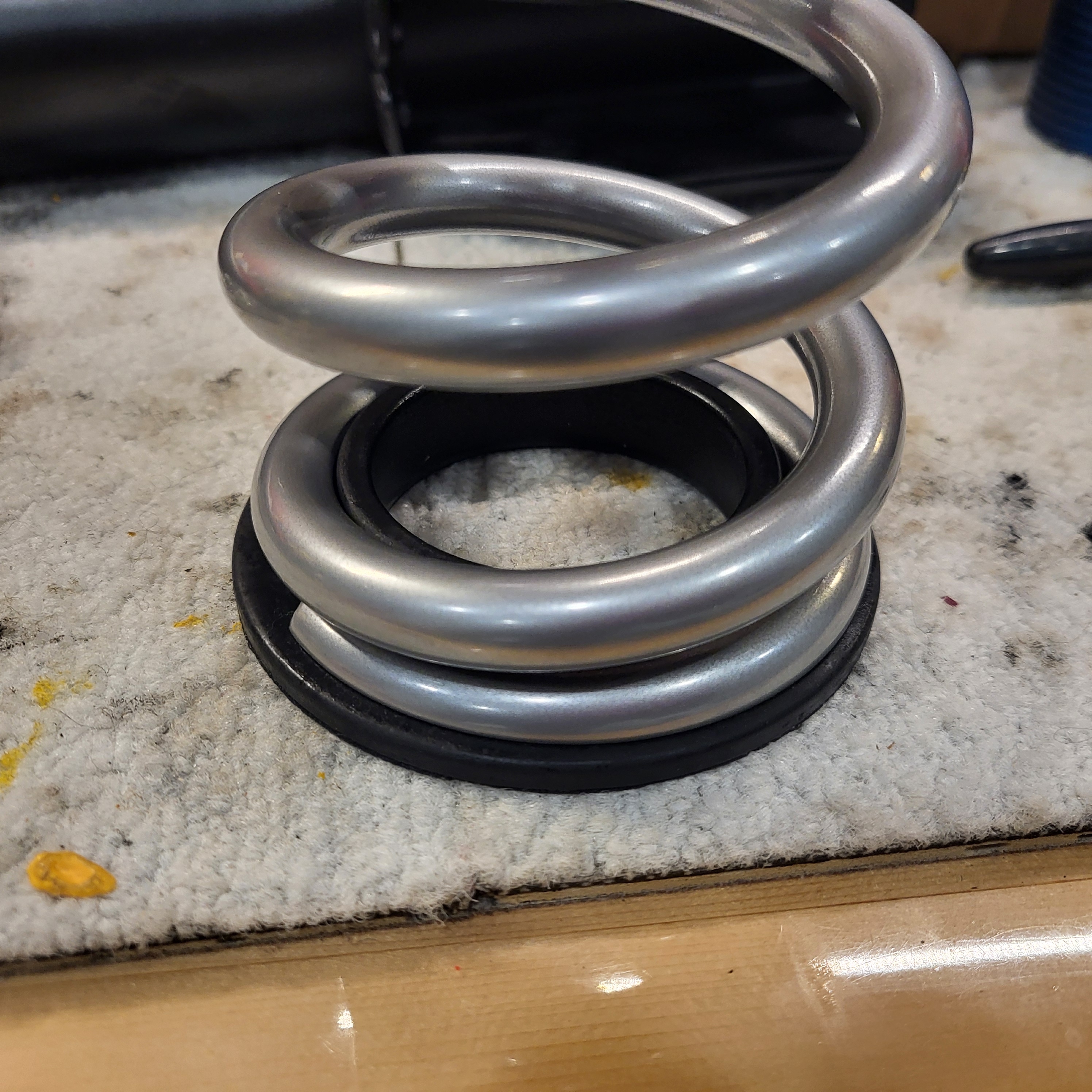

AWeb80 Posted February 10, 2024 Author Report Posted February 10, 2024 On 2/7/2024 at 9:37 AM, Bake82 said: His name is Michael....but don't know anything else.. Does this help? https://www.w-body.com/oldsite/upgrades/suspension-springs.html Not really. But lots of good info there. I found these that are really close....but not exactly what was original. pwmin and Mach 5 2 Quote
White93z34 Posted February 10, 2024 Report Posted February 10, 2024 aside of the inner bit being too big could you find a sleeve or bushing of some sort to take up the slack? Quote
Bake82 Posted February 12, 2024 Report Posted February 12, 2024 That's pretty close! Glad you found something to work! And like chris said, worst case is you could make a small sleeve to make it work. Quote

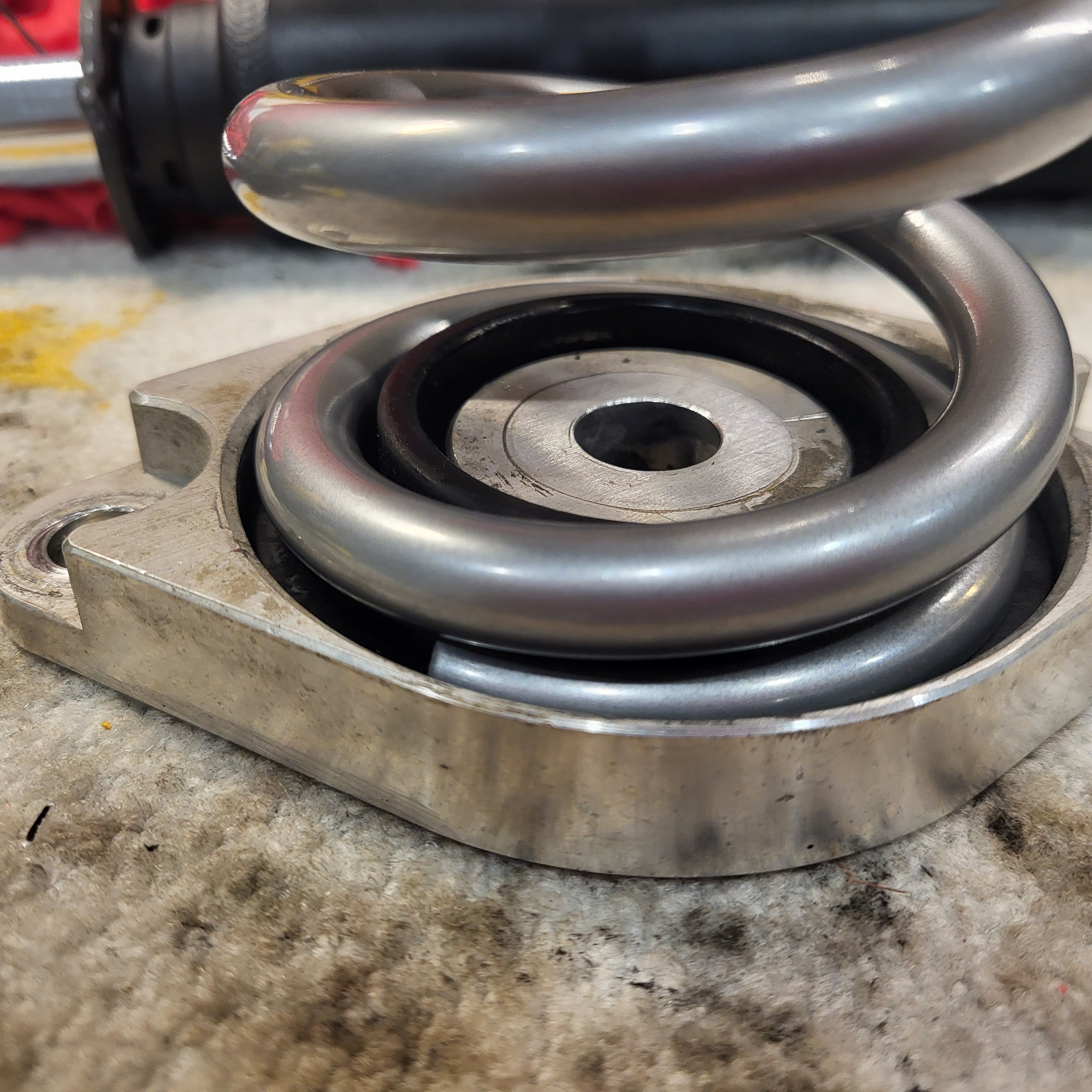

AWeb80 Posted February 13, 2024 Author Report Posted February 13, 2024 On 2/10/2024 at 10:54 AM, White93z34 said: aside of the inner bit being too big could you find a sleeve or bushing of some sort to take up the slack? I'm not sure that'll be an issue. They fit tight against the outside so the pad doesn't move at all. Quote
AWeb80 Posted February 13, 2024 Author Report Posted February 13, 2024 I mean....worst case...you could squeeze some rtv silicone in there I guess... Quote

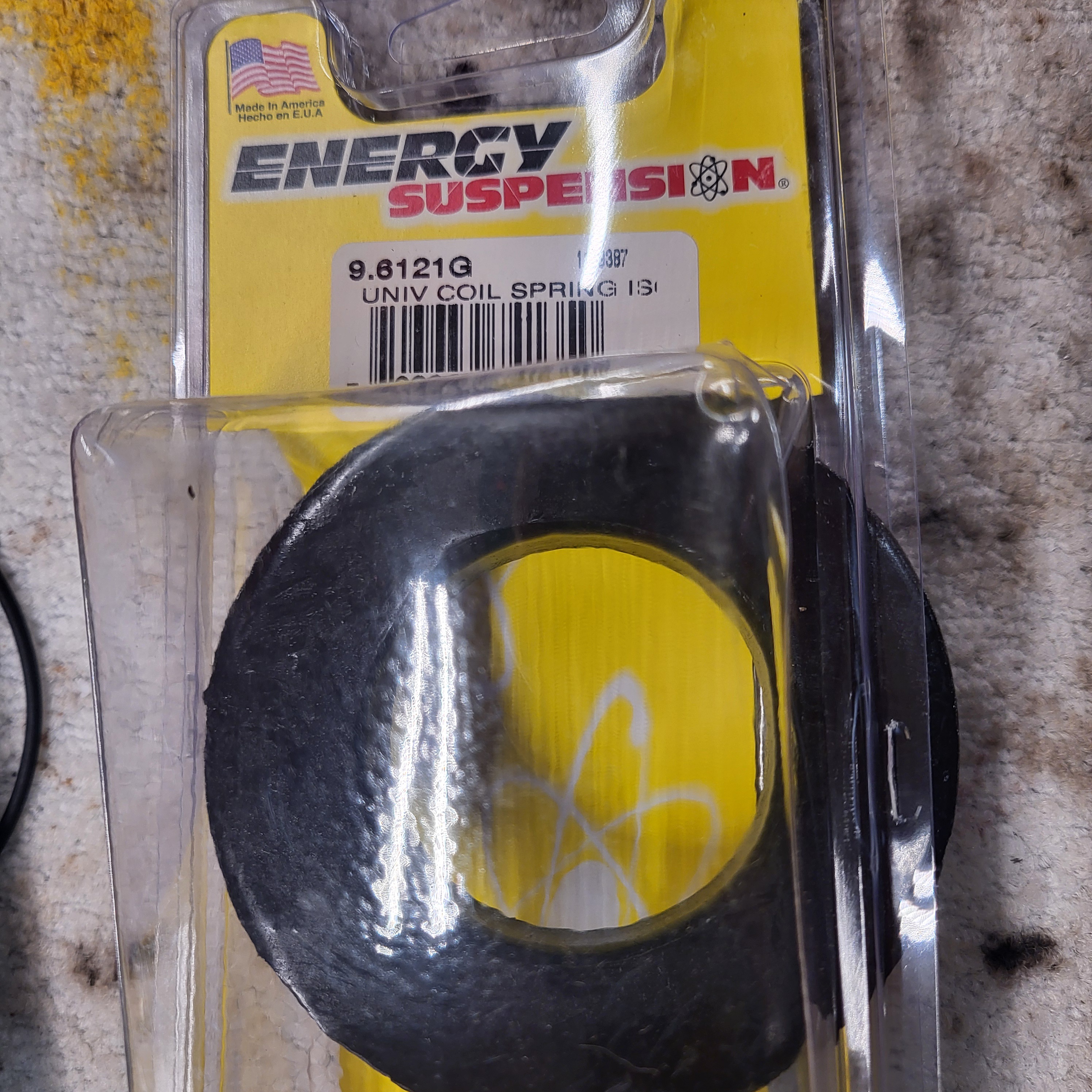

Solution AWeb80 Posted March 25 Author Solution Report Posted March 25 Update. the 9.6121 pads work perfectly. I sprayed them down with silicone during install and not a peep or a squeak out of anything. Bake82, pwmin, SuperBuick and 1 other 4 Quote
