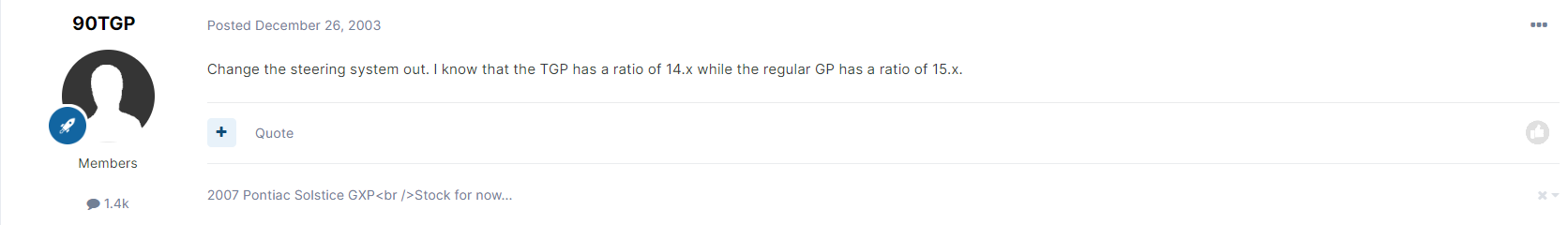

94 olds vert Posted February 8, 2024 Report Posted February 8, 2024 I did some searching through the forums. Not sure if this information is what you are looking for. GranPrix 1 Quote
