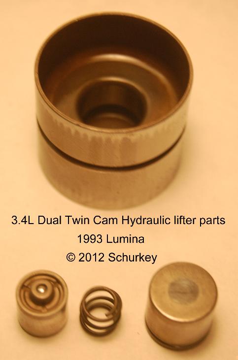

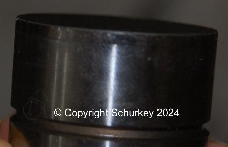

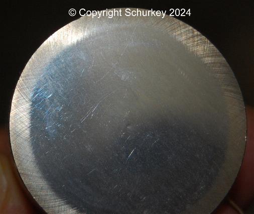

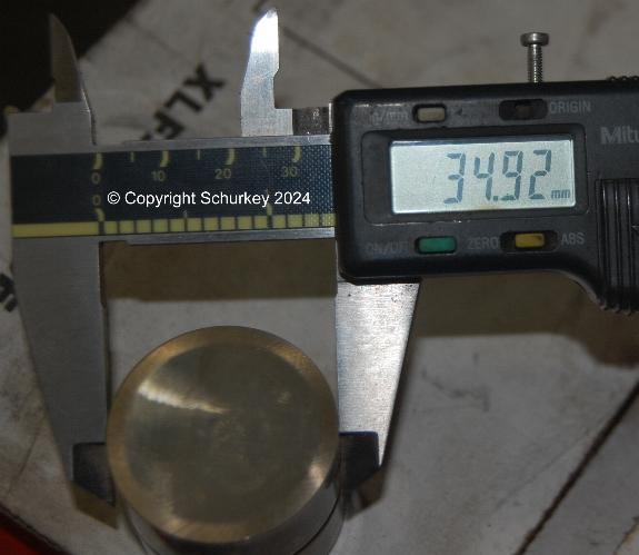

Schurkey Posted February 8, 2024 Report Posted February 8, 2024 (edited) OEM lifters have a hardened-steel wear-cap welded to the camshaft-end of the lifters. The hardened cap has virtually no "wear", but does show some polishing. There's no need to "break-in" these lifters when re-used. The soft valve springs, the lack of rocker arms multiplying valve spring force, and the huge surface area (low psi loading on the cam lobe) make that moot. Not exactly 35mm by my caliper. Measurement varied from 34.92 to 34.91 depending on how I held the caliper. If you get another set of lifters, contact me. I might be willing to buy your "rusty" ones. Edited February 8, 2024 by Schurkey Quote
dukester Posted February 8, 2024 Author Report Posted February 8, 2024 To these lifter even have a crown or are they flat? Maybe I could just get some wet 600 grit and sand off some of bad spots, considering how thick that cap is. Quote
Schurkey Posted February 8, 2024 Report Posted February 8, 2024 1 minute ago, dukester said: To these lifter even have a crown or are they flat? Maybe I could just get some wet 600 grit and sand off some of bad spots, considering how thick that cap is. That was going to be my plan. Piece of glass for flatness, various grades of sandpaper to resurface them. Quote
