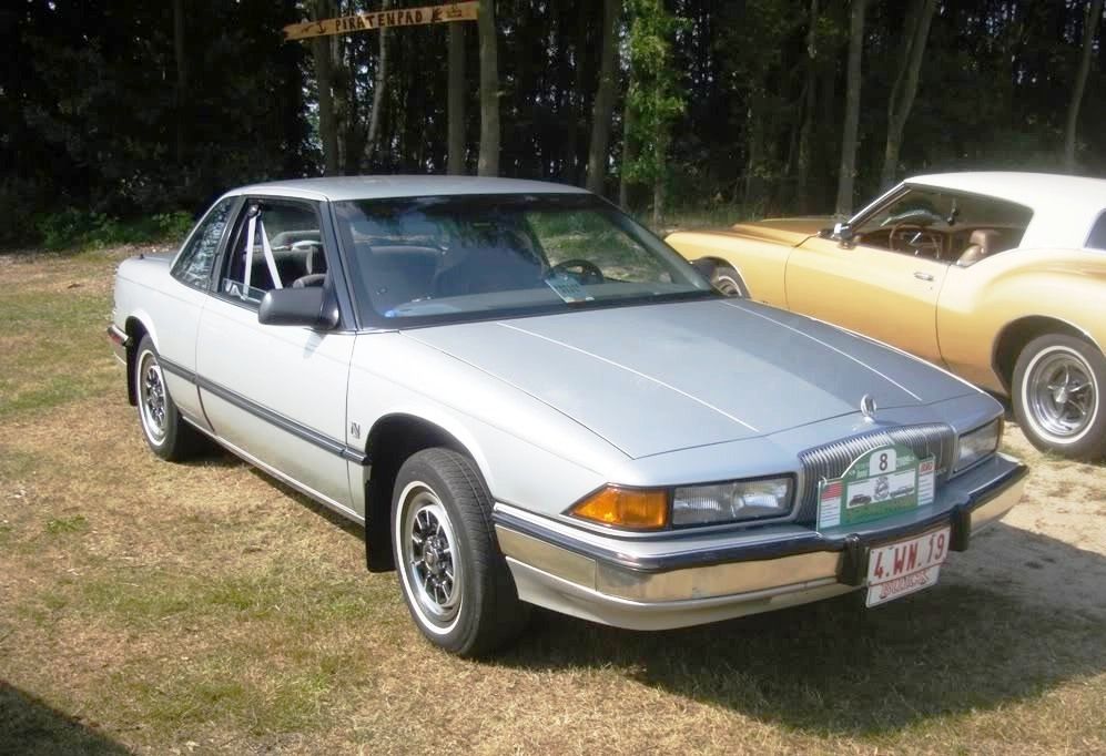

Geeraert Posted February 27 Report Posted February 27 Well well... the same story as in my Buick Regal 1988 Ltd 2.8L.... Bad sensor,bad wires,bad dashboard...? The problem is that car inspectors of the Belgian car inspection stations reject the car when the red light low water sensor is on ! And so, no 'green positive inspection certificate ! Not allowed to drive the car,forbidden..! Stupid ! So,my solution : disconnect the electric plug! Good luck Mr Geeraert, Buick Regal 1988,the last one driving in Belgium at 390.000 kms Quote

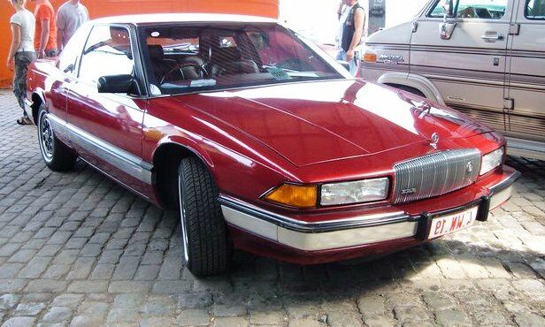

rcLord510 Posted February 27 Report Posted February 27 (edited) 1 hour ago, Geeraert said: Well well... the same story as in my Buick Regal 1988 Ltd 2.8L.... Bad sensor,bad wires,bad dashboard...? The problem is that car inspectors of the Belgian car inspection stations reject the car when the red light low water sensor is on ! And so, no 'green positive inspection certificate ! Not allowed to drive the car,forbidden..! Stupid ! So,my solution : disconnect the electric plug! Good luck Mr Geeraert, Buick Regal 1988,the last one driving in Belgium at 390.000 kms i believe those are normally open circuit, so it makes sense unplugging it with shut the light off, but I could be wrong after that it should pass no problem. also that’s awesome that there is still a w all the way in Belgium, do you have any pictures? Edited February 27 by rcLord510 Quote
rcLord510 Posted March 1 Report Posted March 1 2 hours ago, Geeraert said: Man those are beautiful Quote
