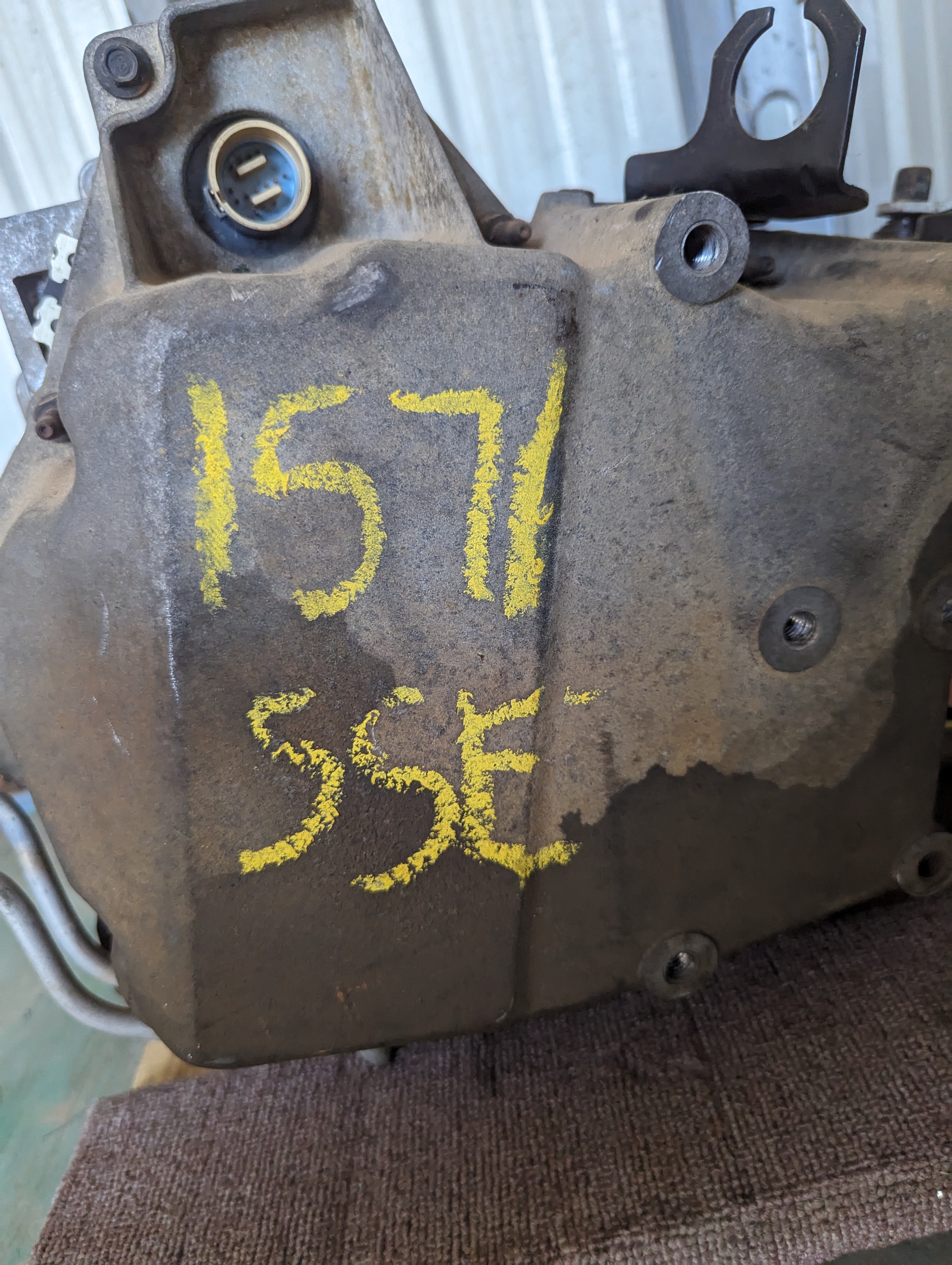

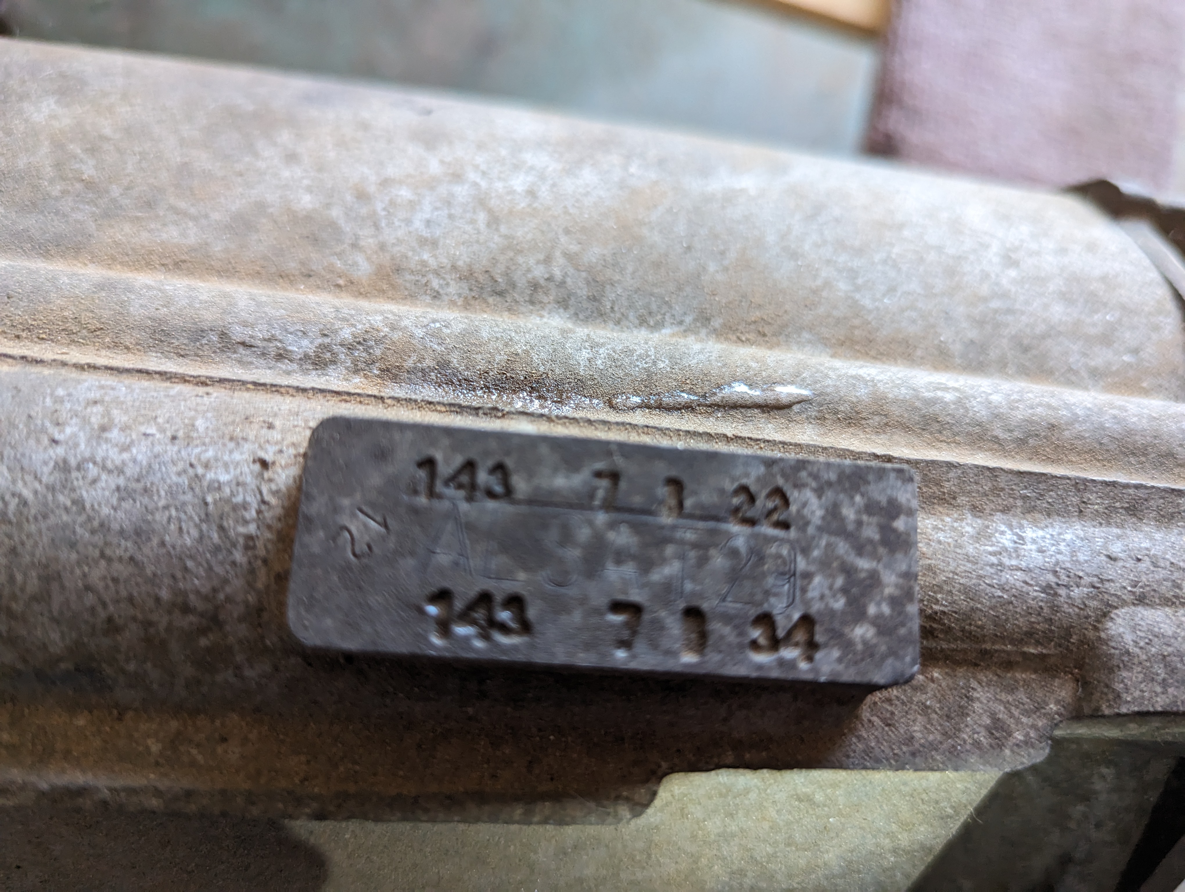

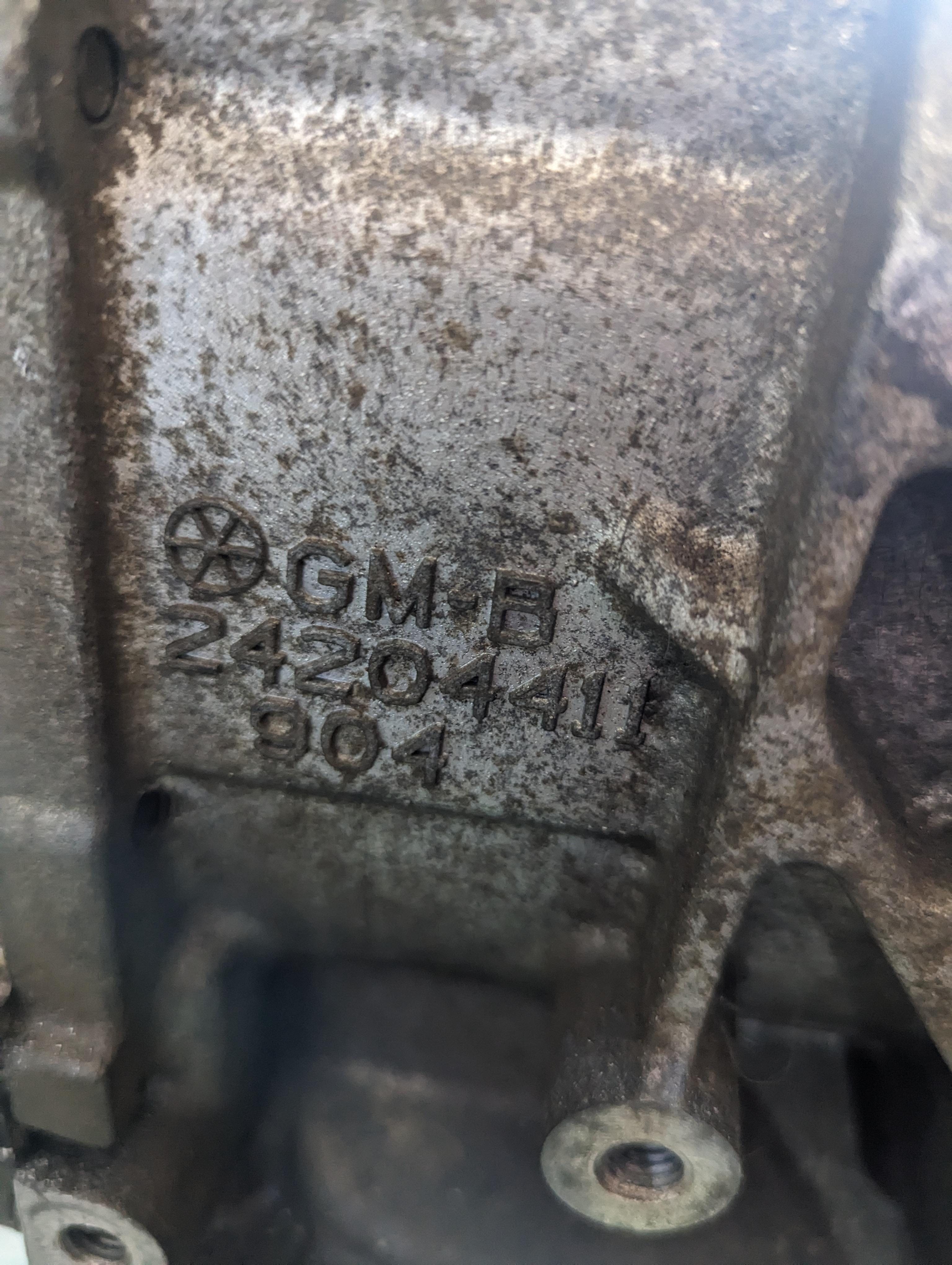

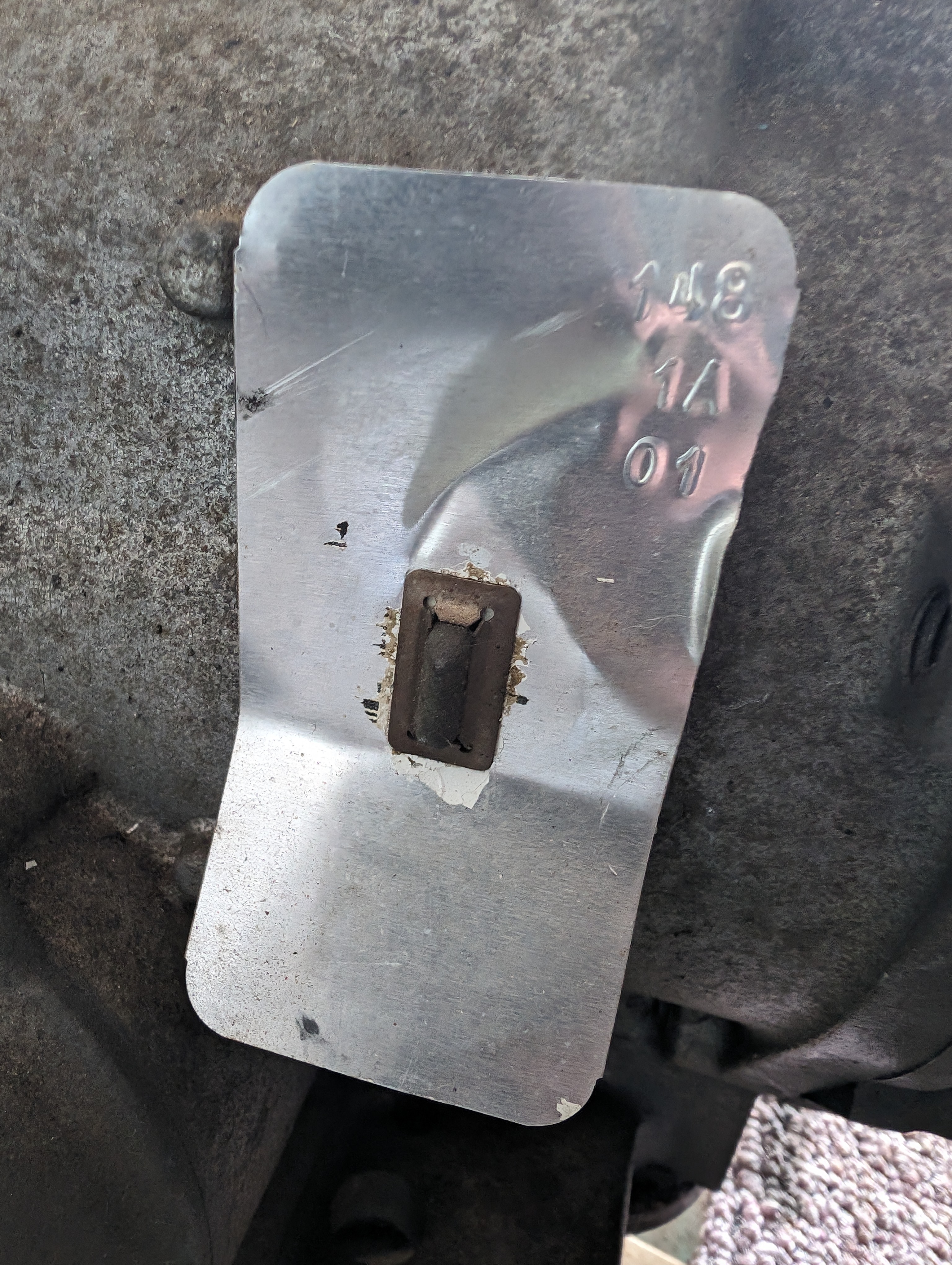

pwmin Posted December 14, 2023 Report Posted December 14, 2023 I'm trying to figure out what transmission i have and what it can be used for. The Hydra-Matic tag is gone and the only things visible on the other tag don't say a lot. It came with the Monte, so I'm assuming it's from a 97 based on the PCM, but I'm waiting to hear back from Tim. I'm hoping to be able to use it to fix up another car since I'm going to be using the 284 to manual swap it. I'll attach some pictures and links. https://www.fastfieros.com/tech/4t65e_transmission_general.htm http://www.gmtuners.com/pda/4T65E-ID.htm Quote
pwmin Posted December 14, 2023 Author Report Posted December 14, 2023 It was probably from a 97 SSEi. Is there a compatibility chart anywhere? Quote
pwmin Posted December 20, 2023 Author Report Posted December 20, 2023 Thanks, did not see the reply. It is supposed to have came out of a 1997 SSEi. From what I'm reading, and please correct me if I'm wrong, it will work on cars from 1997 until they changed the valve body sometime in late 2000. Since it's from an H-body, it has extra mounting provisions, but can still be used in a W-body. Too bad the tag is missing. Quote

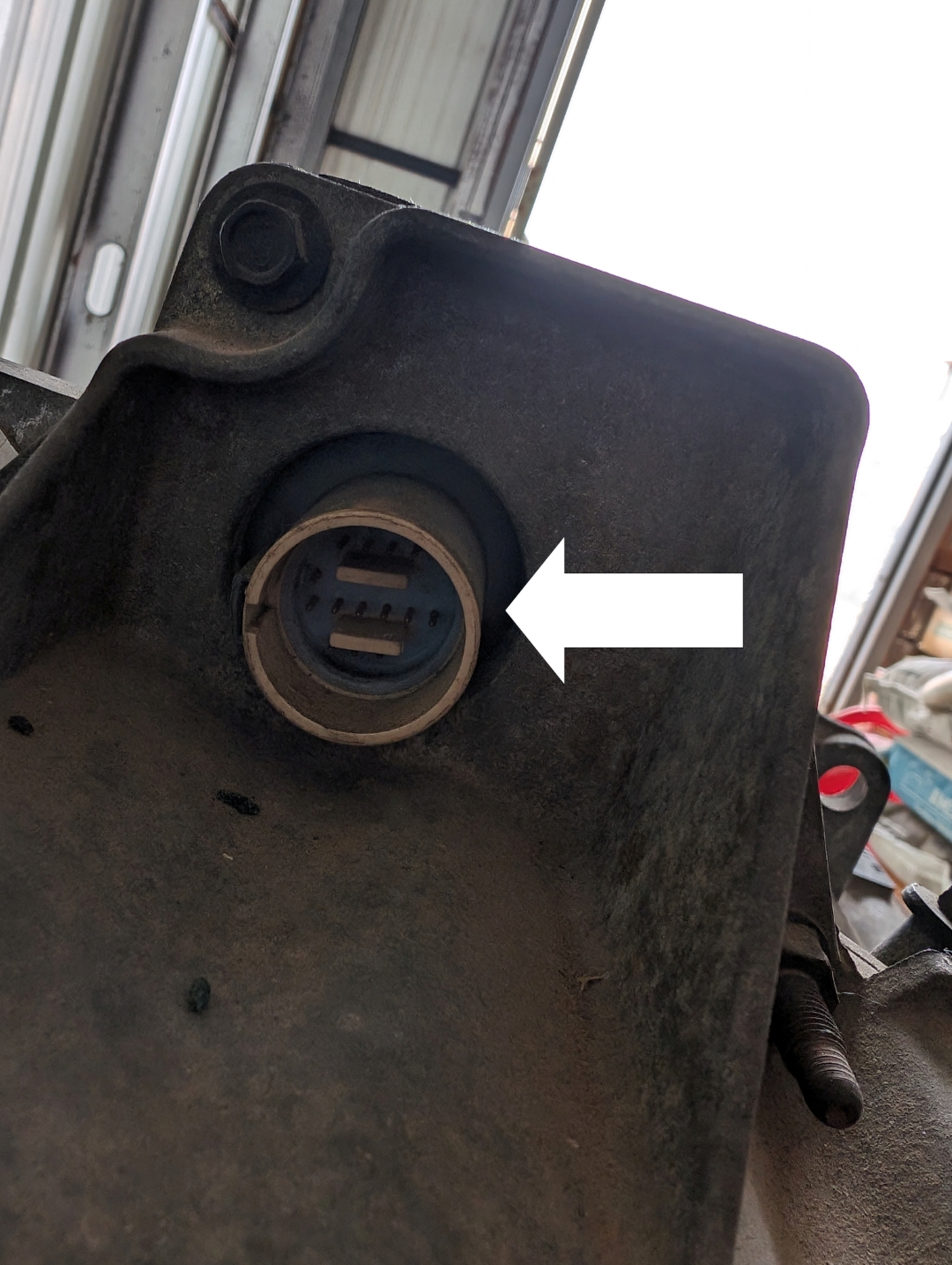

pwmin Posted December 20, 2023 Author Report Posted December 20, 2023 (edited) 39 minutes ago, 55trucker said: If the trans was behind a forced induction engine the trans would be the HD model. Your correct, the valve body was redesigned with the 2002 model year ending. Yeah, it's supposed to be an HD trans. Is there a way to tell without the tag or do you need to pull the pan and look at the valve body? I know this one will have the older design, just wondering how to tell in general. Edited December 20, 2023 by pwmin Quote
55trucker Posted December 20, 2023 Report Posted December 20, 2023 Have a good look at the differential cover size, the 65e is the same as the 4t60e cover, the 65hd cover is considerably larger. Quote
pwmin Posted December 20, 2023 Author Report Posted December 20, 2023 I mean how to tell if it has the revised valve body (I know this one doesn't. Quote
55trucker Posted December 20, 2023 Report Posted December 20, 2023 The only way I know how to identify the later from the older valve body is by the solenoid pressure switch cover. Pull the trans rear cover, older makes use of a plate cover that is almost twice the size of the newer design. Quote
