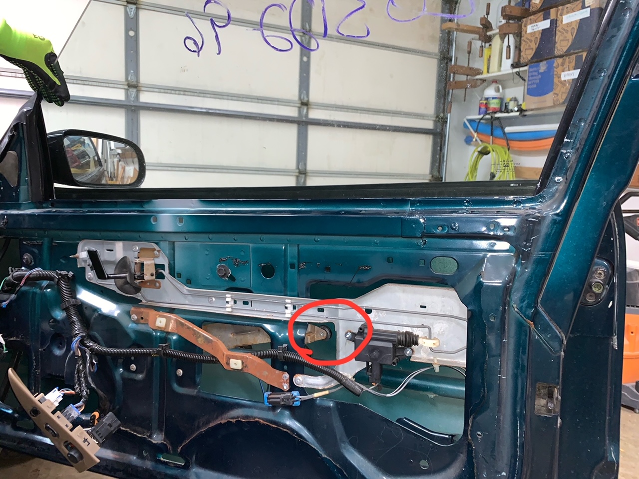

I've nearly replaced the passenger window glass.  Quite a journey to find the glass, get the door panel off, and fit it into the track.
The only thing left:  How do I get the powered window "lift wheel" into the track at the bottom of the window?  Picture below.
I reviewed some more posts and now understand I should have inserted the window at 45deg angle, positioned the lift roller in place, and then rotated it level.
Unfortunately, I got the window inserted and level before the lift roller was in place.  Now that the window is level, I cannot get it out or rotate it at all.  I took it off the front track but the back window guide is firmly in the back tack.  If I could pull the window back out or rotate it, I think I'd be back in business.
Any help would be appreciated.
