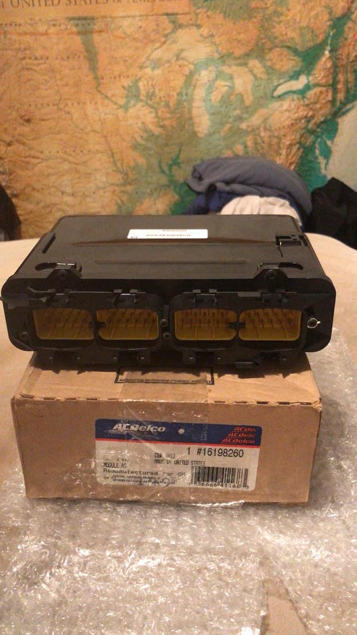

The shop that put my reman engine in for me told me they couldn’t get the low coolant light to go off. I had them replace my coolant level sensor.  They also told me the ecm was full of water so they replaced that with the part I provided. The part number of the ecm I found myself was when GM still reman them back then in house. This unit was an NOS I found off eBay. The shop thought maybe the ecm wasn’t correct for my vehicles options. They said it does fit my application but it could be this ecm was an optional ecm which would be optional on these models back then. Mine being a base model, they think this was the higher end ECM and mine was different. But they said everything seems to be working fine with that ECM. It’s just the low coolant light that is staying on. I don’t think the ecm has anything to do with the low coolant light does it? I know clearing codes and having them come back would indicate a bad ecm. But I don’t think a low coolant light would be related. The shop says just drive it and see how it drives with the new engine in it. Bring it back in a couple of weeks and we can check that light out.
The part number of the ECM I got will be shown in the photo. My original ecm from the factory was replaced in 2007 with a cardone industries one that was complete shit. I wanted one from back then when GM done their own reman. So I got an nos one that the dealers supplied when the cars were still new. The GM parts catalog says the part number for the original ecm that came from the factory is 1227727 and that part number was interchangeable with the part number you see in the photo which fits my application.

As I recall... the ECM has nothing to do with the coolant light on the dashboard, at least I'm 90% on that
That said, water in the ECM is not good for sure replace that.
From what I can see the 16198260 is a direct replacement for the 1227727. Just make sure to change over your Memcal (chip, PROM whatever you wanna call it) so the computer has the right calibration.
