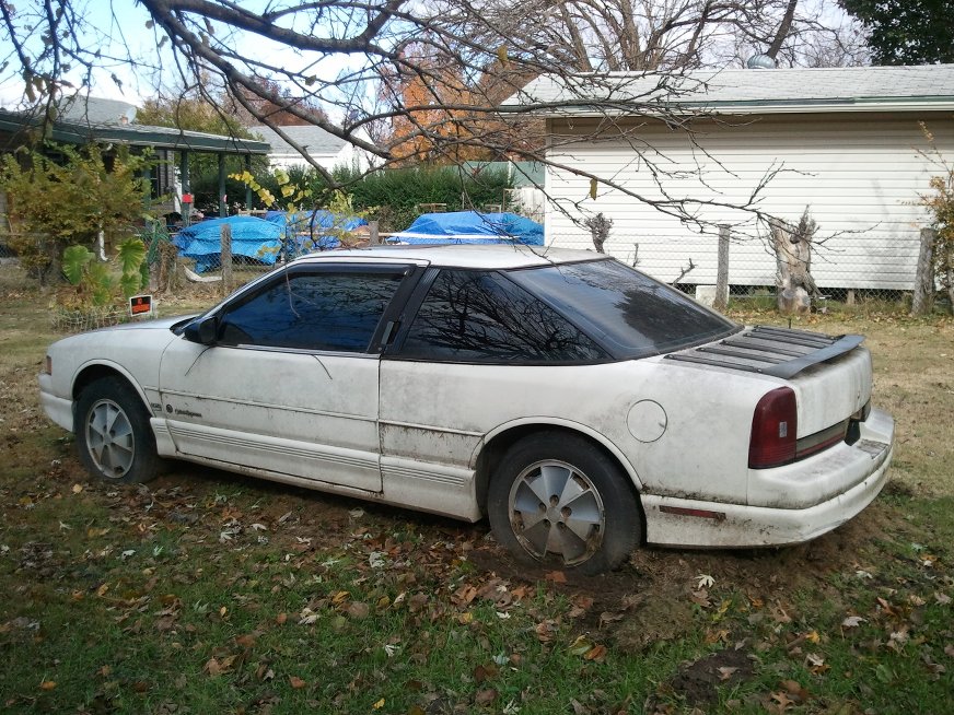

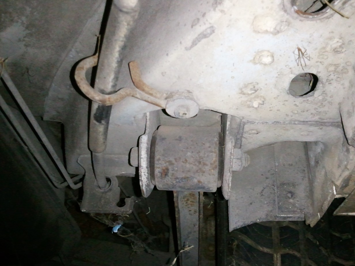

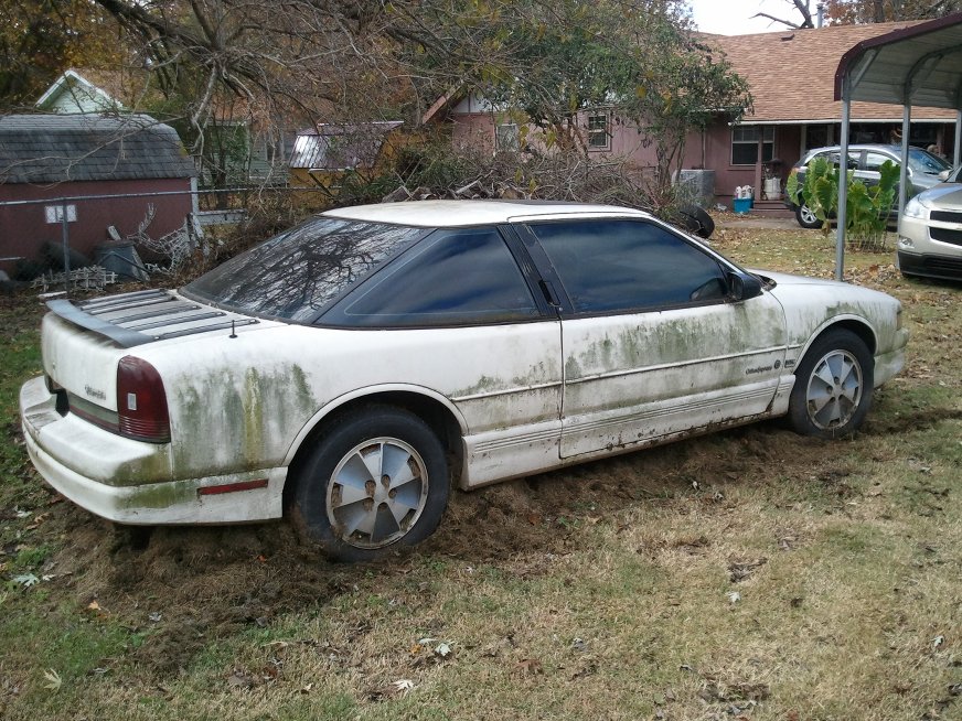

jiggity76 Posted November 14, 2023 Report Posted November 14, 2023 (edited) 15 hours ago, 55trucker said: Being a *TGP* the car will have the PMIII abs system. To repair that will cost you more than it's worth & it was a troublesome system........ is this a southern rust free car? has it been sitting on a concrete pad or in the dirt? if sitting for 20 years expect a mountain of work to put it right..... post up a few photos of the car, especially the underside. Well said and I think the region from which a car lives in more important than whether it's been sitting in the dirt or on a pad. My Cutlass sat up in the original owners backyard for at least 9 years if not more. It being a Southern Oklahoma car is the reason why it's not rotted as they don't use any salt in that area thank God. Also, hello 55! Edited November 14, 2023 by jiggity76 Quote

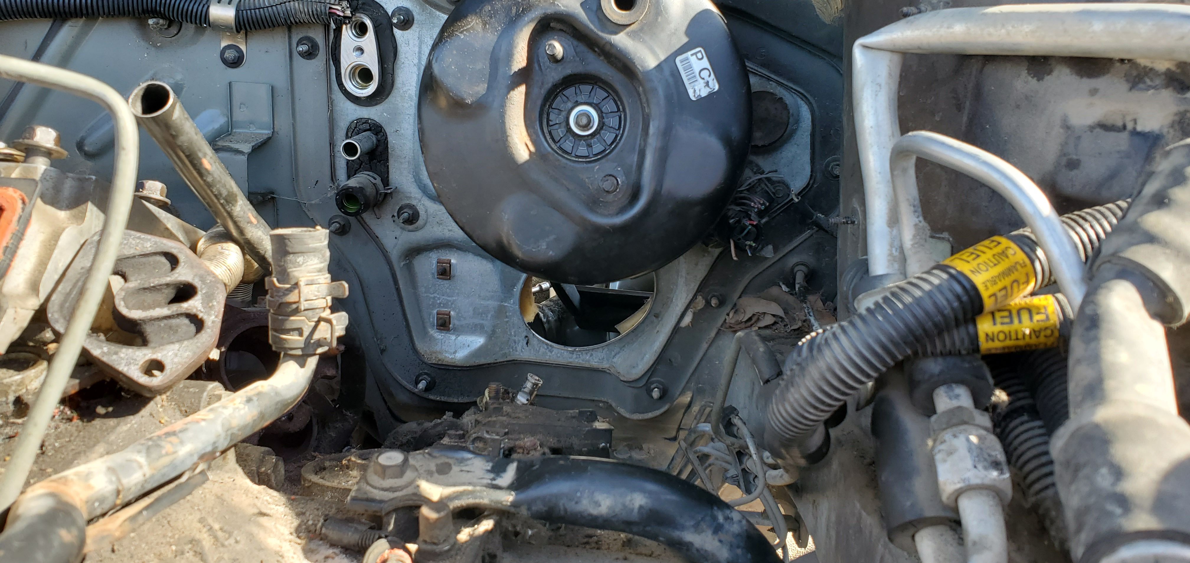

55trucker Posted February 15, 2024 Report Posted February 15, 2024 (edited) Not an easy job to do........ the entire W body brake system is unique to the W body. No components transfer to or from any other carline. If one wants to convert from ABS to non-abs you're going to find yourself hand fabricating all 4 sets of lines to all 4 corners. The non ABS cars make use of 4 independent brake lines right off the master going to the 4 corners of the car, the ABS system doesn't follow this same procedure. There are 3 main lines off the ABS module, 2 to the front, 1 to the rear where at the back end of the car one will find a proportional splitter to feed the 2 rear calipers. The masters themselves are not interchangeable, one is dedicated for ABS one is dedicated for non ABS. The booster is another hurdle, the vacuum booster can be readily had but what it is fastened to is another story. As I stated in a prior thread one has to go to the effort to remove the heavy plate bracket that is part of the firewall that the ABS system, part of the A/C system & the steering rack column passes thru & go out & find a plate in a non ABS car such as this one in Jiggity's photo shows & pull it out to replace the one in your car. It's not a job for the faint hearted. Edited February 15, 2024 by 55trucker SuperBuick 1 Quote
White93z34 Posted February 15, 2024 Report Posted February 15, 2024 I converted my 1990 TGP to Vacuum I've previously converted a 1989 TGP to Vacuum done it 2 different ways, the "right" way on the 1989 - Full OEM factory brakes with the correct firewall plate and 2 new rear brake lines. Be advised, this results in the location of the master being VERY close to the turbocharger - my idea was to use a N body master as its basically the same one just kicked up at a different angle. never got around to trying that you can re-use the front lines in all situations. and on my own 1990 I used a 4g F body booster and master, mounted to an aluminum plate I made bolted to where the PMIII used to mount You have to use the pushrod off the TGP and weld or otherwise attach it to the F body booster. I modified the front brake lines into a splitter and then made a line to go from the f body master to the splitter and then made a reducer of some sort for the rear line. Doing this is OK if doing a f body setup, NOT ok for a factory setup. understand the differences between F/R Split and Dual Diagonal brake systems and use extreme care to ensure all lines go to the proper places on their respective master cylinders. All this said I think both solutions are safer then using PMIII in the present era. It was a idea that was ahead of its time. Its full of single failure parts (that have been getting baked by a turbocharger for 30 years) that can leave you without brakes in the event of a failure - also parts are simply not available anymore Quote
SuperBuick Posted September 22, 2024 Report Posted September 22, 2024 Question here - this topic and details have been so helpful. @jiggity76 and I are chatting right now on this very subject… My question is - if (or when, really) converting a car that is powermaster 3 manual transmission to vacuum brakes, and knowing i have to swap that firewall plate (which I will have access to as I’m picking up a 1992 non abs car, but automatic), how do i make the 1992 firewall plate accommodate the manual. Is it just drilling a hole? Or maybe the hole is already there? thank you Quote
Bake82 Posted September 23, 2024 Report Posted September 23, 2024 On 9/21/2024 at 9:01 PM, SuperBuick said: Question here - this topic and details have been so helpful. @jiggity76 and I are chatting right now on this very subject… My question is - if (or when, really) converting a car that is powermaster 3 manual transmission to vacuum brakes, and knowing i have to swap that firewall plate (which I will have access to as I’m picking up a 1992 non abs car, but automatic), how do i make the 1992 firewall plate accommodate the manual. Is it just drilling a hole? Or maybe the hole is already there? thank you A hole is already there. However it’s not correct in shape or angle on the plate. Many have cut the hole and made it work. (Auto is round and I believe angled slight upwards, manual has squared corners and is flat). I actually have a vacuum booster, manual plate I’d sell if you’re interested in it. PM to chat more if you want! unfortunately you’d still need to dig into the dash as you’ll need a few pieces from vacuum setup I don’t have (mainly the rubber boots the vacuum booster push rod goes through). SuperBuick 1 Quote
