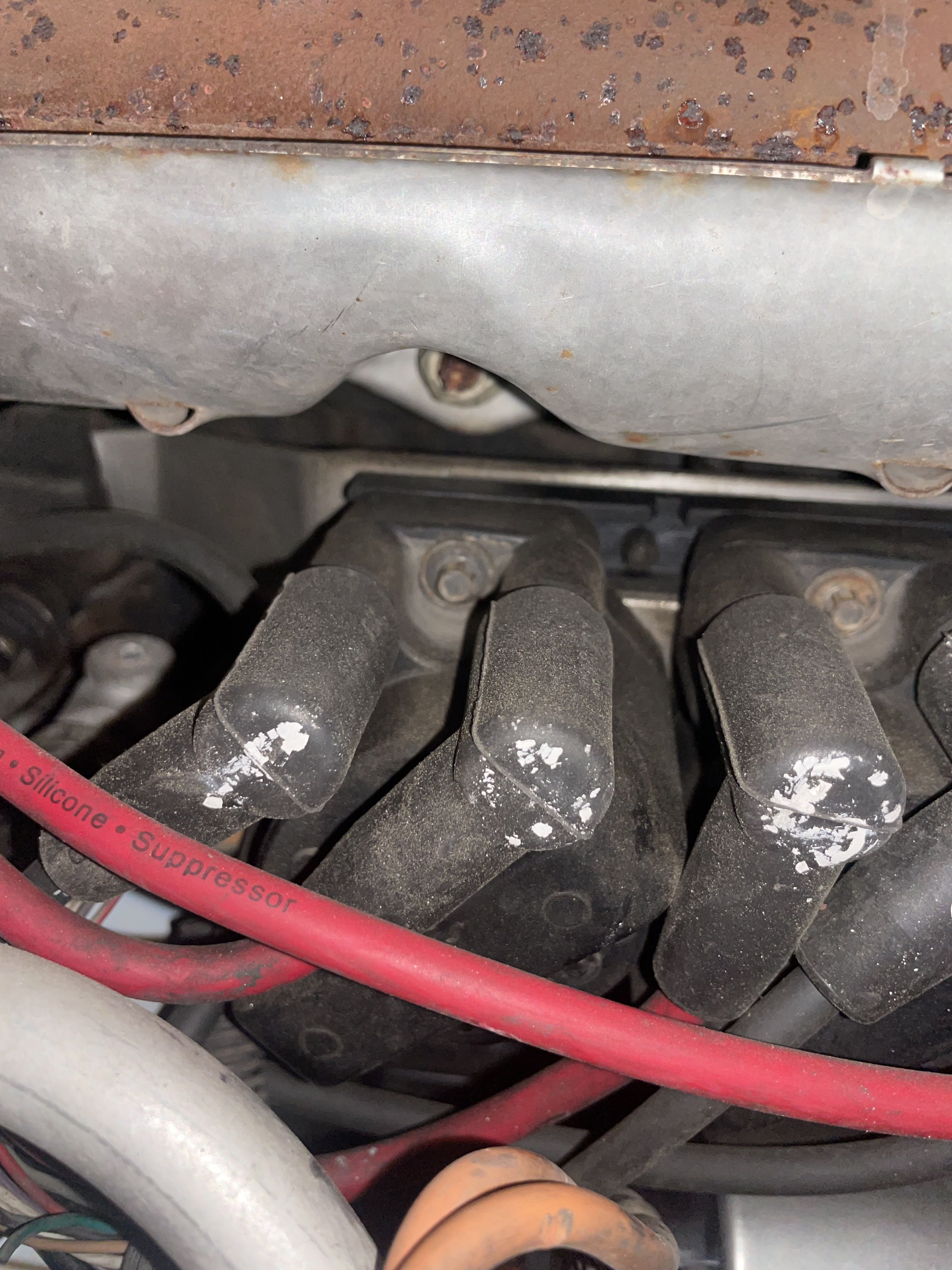

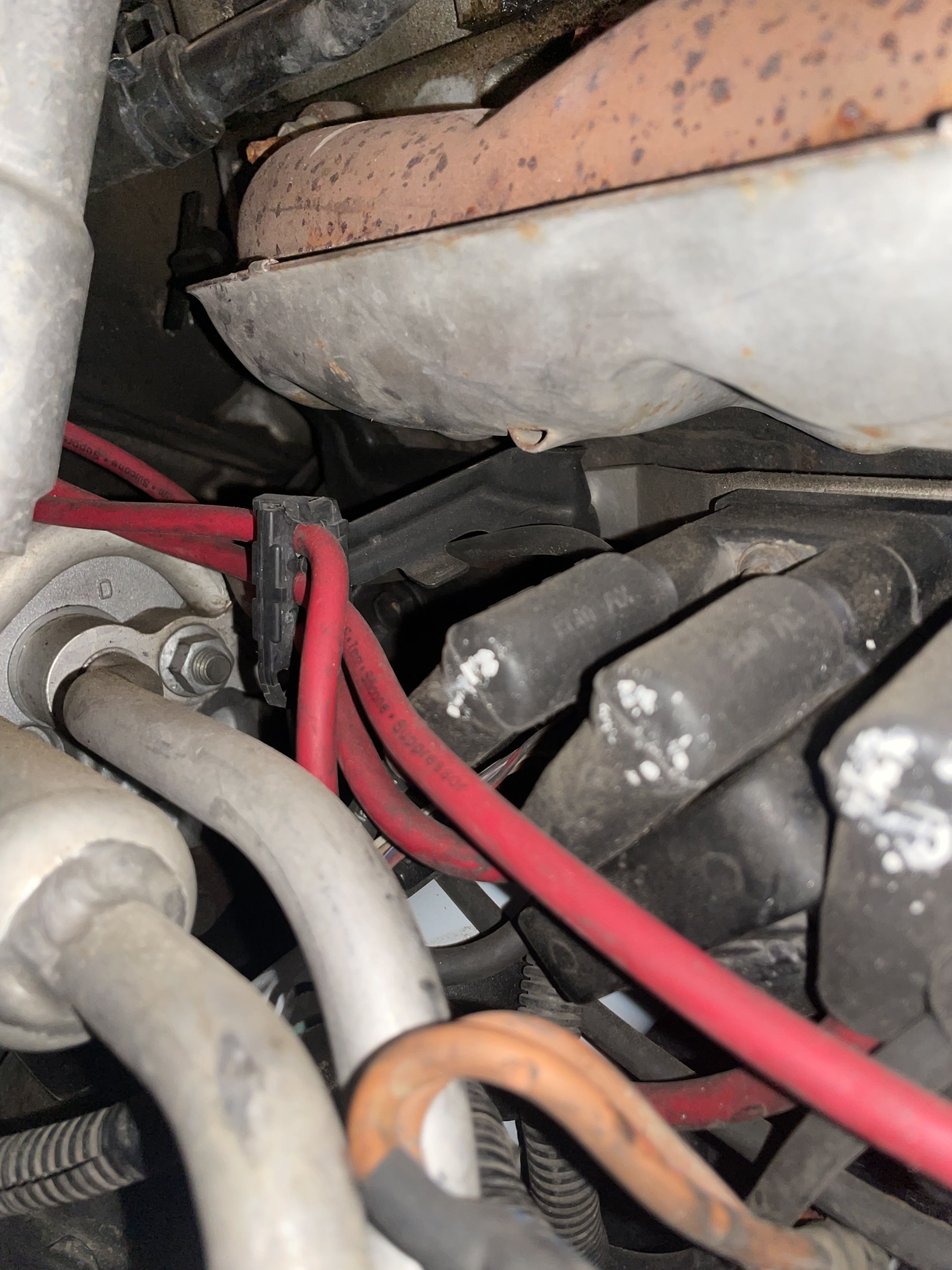

55trucker Posted December 23, 2023 Report Posted December 23, 2023 (edited) Curious... I've been thru the *incorrectly timed* engine B.S. ...took place back when the engine was still under warranty, the exhaust cams were improperly timed to the crank (late) by the GM shop mechanic who (way back then) had next to no experience on this engine, engine would start, run, but lacked overall power. There was no undue noise, no backfiring.......what was the actual source of the noise that could be heard? *looking at the video you made I see that when the engine was reassembled the mechanic didn't properly route the front bank plug wires to where they should be... Edited December 23, 2023 by 55trucker Quote
94CSC Posted December 23, 2023 Author Report Posted December 23, 2023 30 minutes ago, 55trucker said: Curious... I've been thru the *incorrectly timed* engine B.S. ...took place back when the engine was still under warranty, the exhaust cams were improperly timed to the crank (late) by the GM shop mechanic who (way back then) had next to no experience on this engine, engine would start, run, but lacked overall power. There was no undue noise, no backfiring.......what was the actual source of the noise that could be heard? *looking at the video you made I see that when the engine was reassembled the mechanic didn't properly route the front bank plug wires to where they should be... Do you have a pic of how they should be routed? This mechanic didn’t mess with plugs so I’m thinking this is from someone who was in it before I got it. He said something with the timing about having to move it 180 degrees. Basically the way it was installed would show that the car was in time when previous mechanics checked it but really it wasn’t. I’ll have to call him for a better explanation. But no more noise, fires right off. Quote
55trucker Posted December 23, 2023 Report Posted December 23, 2023 Ok, think I'm getting the picture here, when timing the 4 cams the rear bank are done 1st (#1 is at the back), at this stage the cam sprockets are free, the 2 cam locks are in place, one brings the crank up to top dead for #1, then one tightens the 2 rear cam sprockets to lock them into place, one then removes the cam lock for the rear bank & now one rotates the crank another 360 degrees to bring #4 up to to dead centre & one repeats the timing process again. Now all 4 cams should be timed correctly. The plug wires are routed behind the coolant manifold, all 6 come very close to the A/C piping, the rears go up & out of sight across the front of the engine, the fronts are held together in that oval shaped split loom & fastened to the clip on the corner of the carrier cover. Are the short sections of split loom still covering the wires down near the coils? Quote
94CSC Posted December 23, 2023 Author Report Posted December 23, 2023 2 hours ago, 55trucker said: Ok, think I'm getting the picture here, when timing the 4 cams the rear bank are done 1st (#1 is at the back), at this stage the cam sprockets are free, the 2 cam locks are in place, one brings the crank up to top dead for #1, then one tightens the 2 rear cam sprockets to lock them into place, one then removes the cam lock for the rear bank & now one rotates the crank another 360 degrees to bring #4 up to to dead centre & one repeats the timing process again. Now all 4 cams should be timed correctly. The plug wires are routed behind the coolant manifold, all 6 come very close to the A/C piping, the rears go up & out of sight across the front of the engine, the fronts are held together in that oval shaped split loom & fastened to the clip on the corner of the carrier cover. Are the short sections of split loom still covering the wires down near the coils? Looks like I need to reroute. I can just pop off 2/4/6 and move them. Also appears I need to buy some covers as well. Assume auto parts store will have. Quote

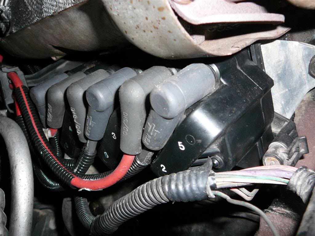

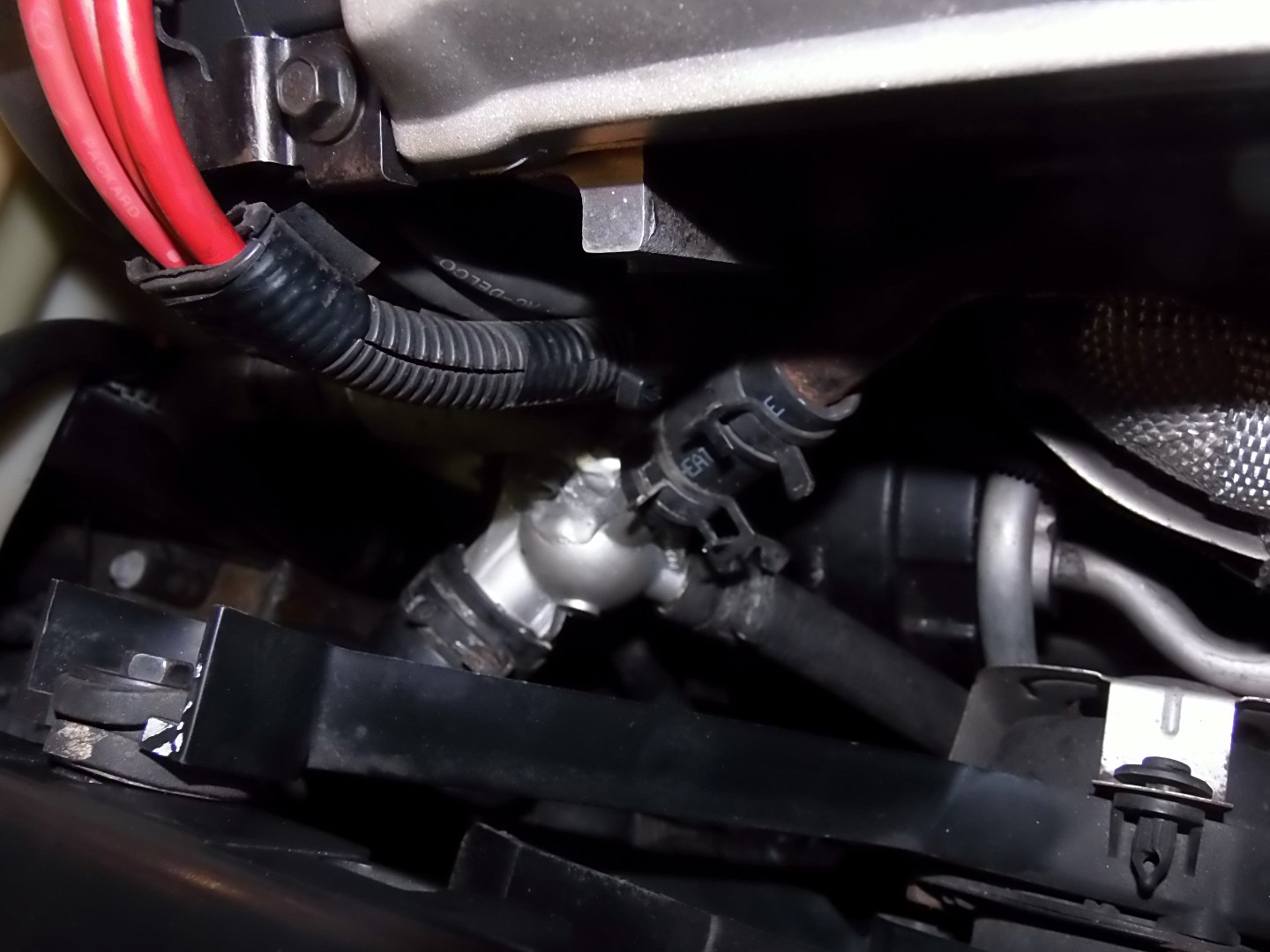

94CSC Posted December 23, 2023 Author Report Posted December 23, 2023 Also, can someone show me how these should be placed? Quote
94CSC Posted January 3, 2024 Author Report Posted January 3, 2024 Does anyone have a pic they can share that will help me determine how these should be placed? Quote

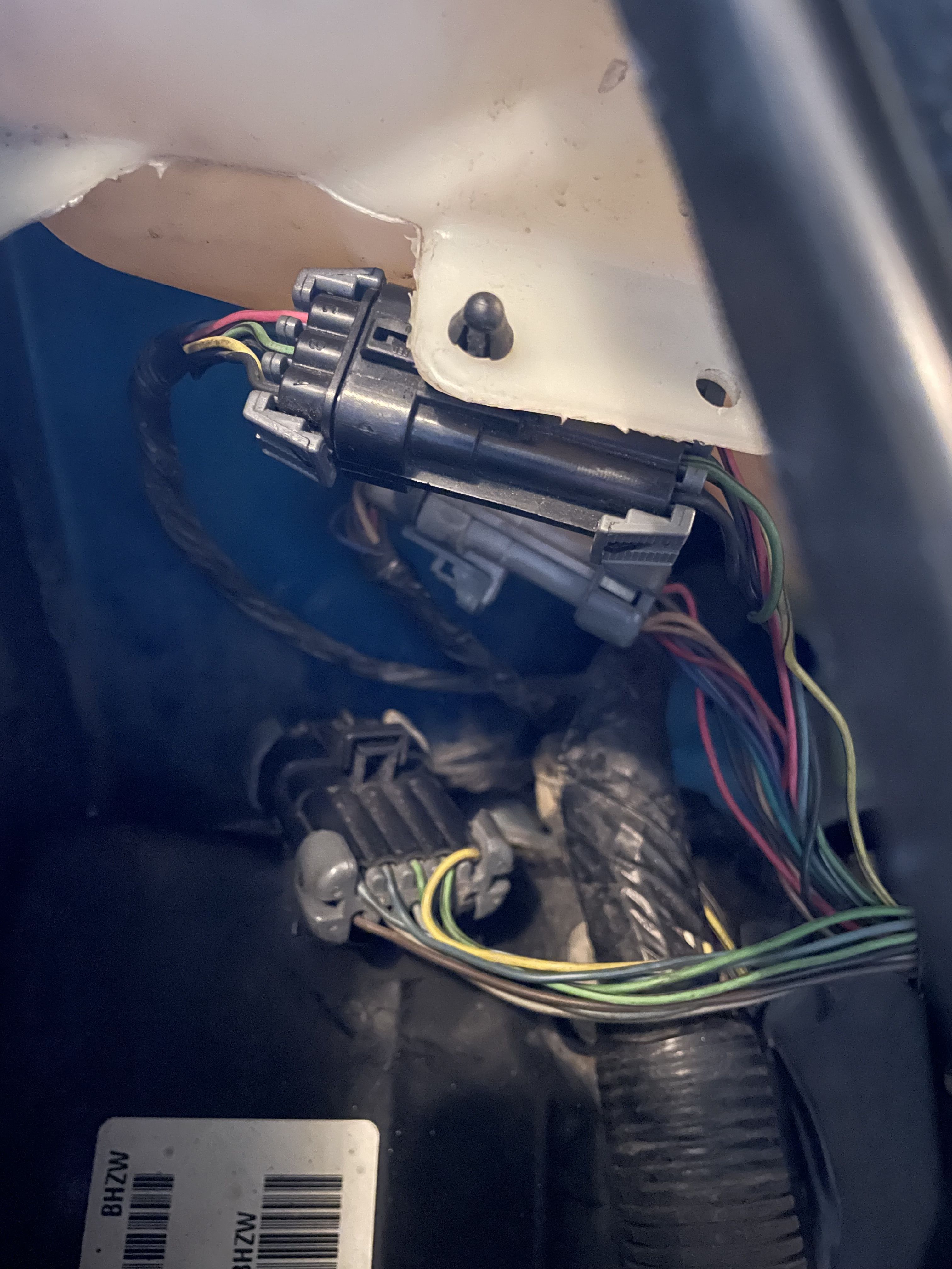

55trucker Posted January 3, 2024 Report Posted January 3, 2024 I didn't respond to this pic earlier as I do not own a 94 or later car. What I see looks like the forward end of the coolant recovery tank, I take it that your engine bay has a wiring harness protruding from the top of the engine just forward of the power steering pump that goes over to the electrical centre just in front of the coolant recovery tank? Quote
94CSC Posted January 4, 2024 Author Report Posted January 4, 2024 Yes I think so, thank you. Looks like one clips into coolant overflow tank as I have it and then others might just be resting there-harder to see those. Quote
