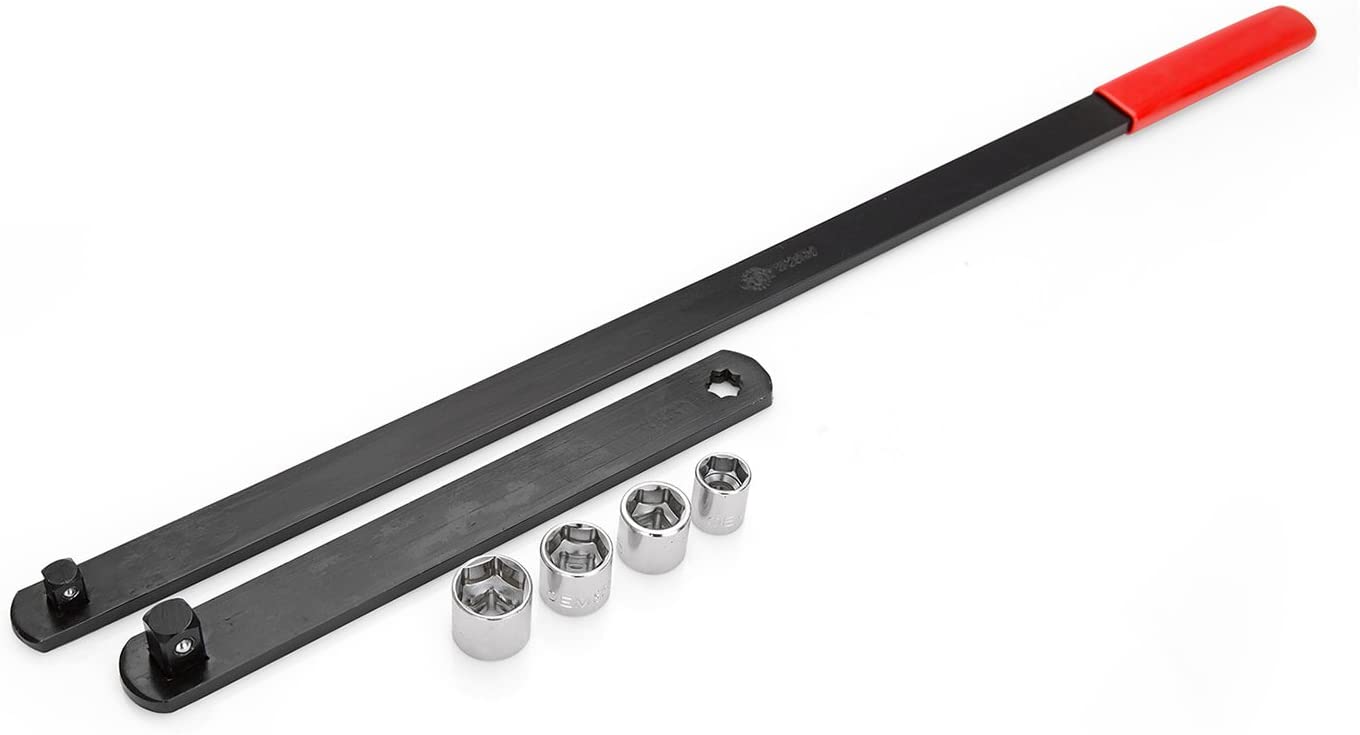

55trucker Posted October 9, 2023 Report Posted October 9, 2023 Getting the belt off?...relatively easy, the easiest tool is a *serpentine belt tool kit, that will supply one with a long flat bar(lever) with the proper socket that fits over the tensioner pulley bolt head. Even with the coolant recovery tank removed there's not a lot of space down there, using a regular 3/8 ratchet may cause scraped knuckles. As for why the lifters are *talking to you* .....most common reason is poor oil pressure, too thin a multigrade oil etc. When you state the pressure is good what are you basing that on? When the engine is running at temp & idle the pressure gauge should not be lower than 25 lbs., at speed ( 2,000 rpm +) the gauge should near pegged at no lower than 60 lbs. I don't personally use oil as light as 5w30, but seeing as my car never sees cold weather it has always been run on 10w40, just offers better viscosity protection at hot temps. Quote

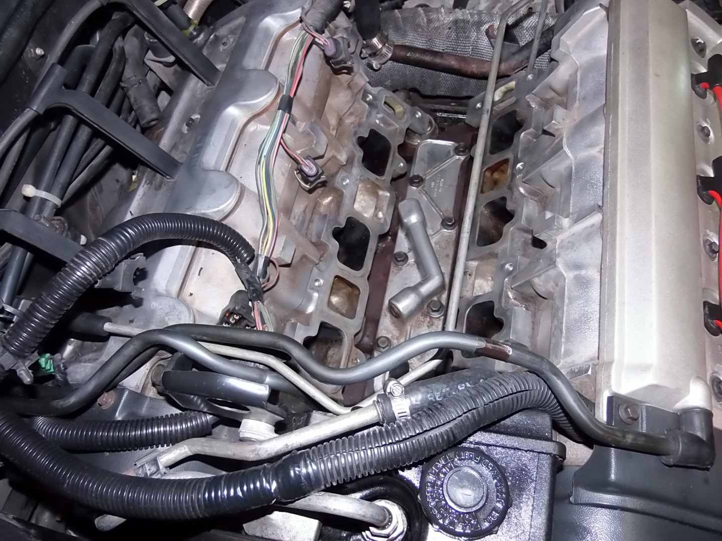

55trucker Posted October 12, 2023 Report Posted October 12, 2023 There is another outside possibility.. this engine makes use of an oil anti-drainback device to keep the oil in the cyl heads after the engine has been shut down. Because of the size of the heads & # of oil passages in them GM built in this anti drain back function. It's called the *oil distribution cover* & it's bolted to the block in the valley area under the intake manifold. Not knowing what that engines history is it's possible that the passages in the distribution cover are clogged and there is not enough volume/pressure delivered to the cams. Quote
94CSC Posted October 13, 2023 Author Report Posted October 13, 2023 Good to know. I will be taking it in to the shop soon and will let them know about this. Quote
