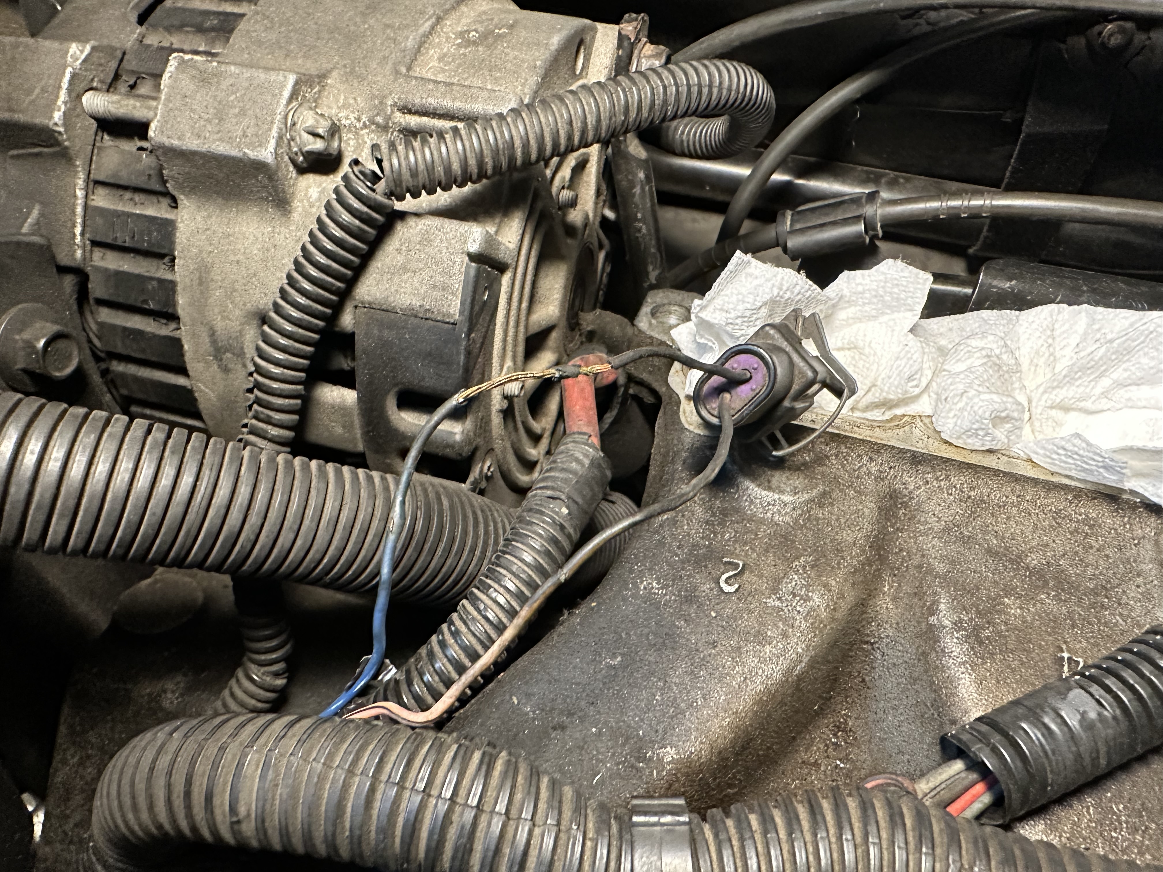

I swapped out the fuel injectors with reman Rochesters, but the no-start problem was likely caused by the frayed pigtails on this injector harness. I replaced the harness and pigtails and the car fired right up. 😁
