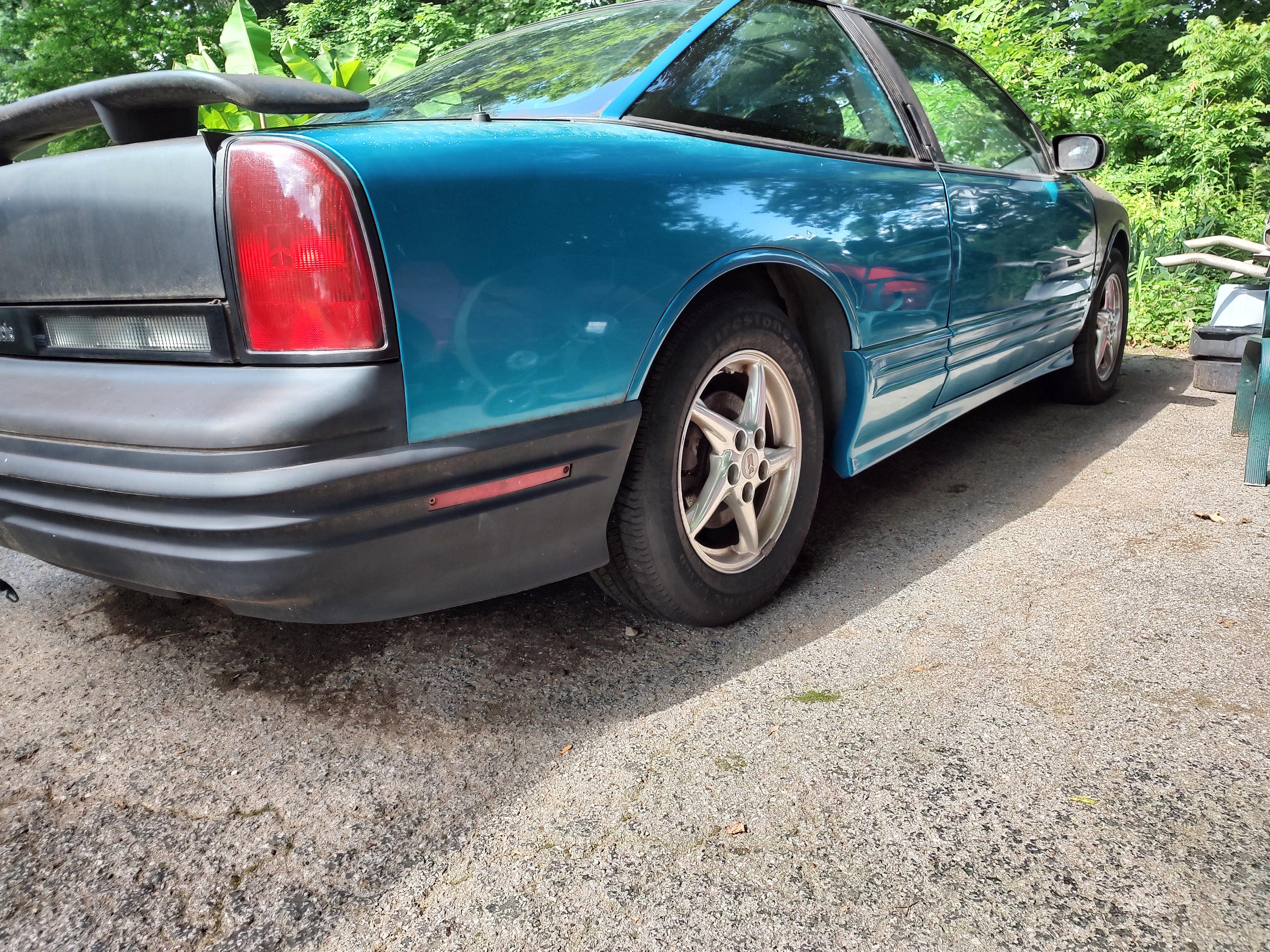

I have `99 GTP rims on my `94 Cutlass. I had to use 1/4" spacers to clear the front calipers but IIRC the rears were fine. If our cars are measuring 115mm I recall reading years ago there was a desirable Mustang rim in 113.5mm that was close enough to work. I never mounted them to see for myself though.
