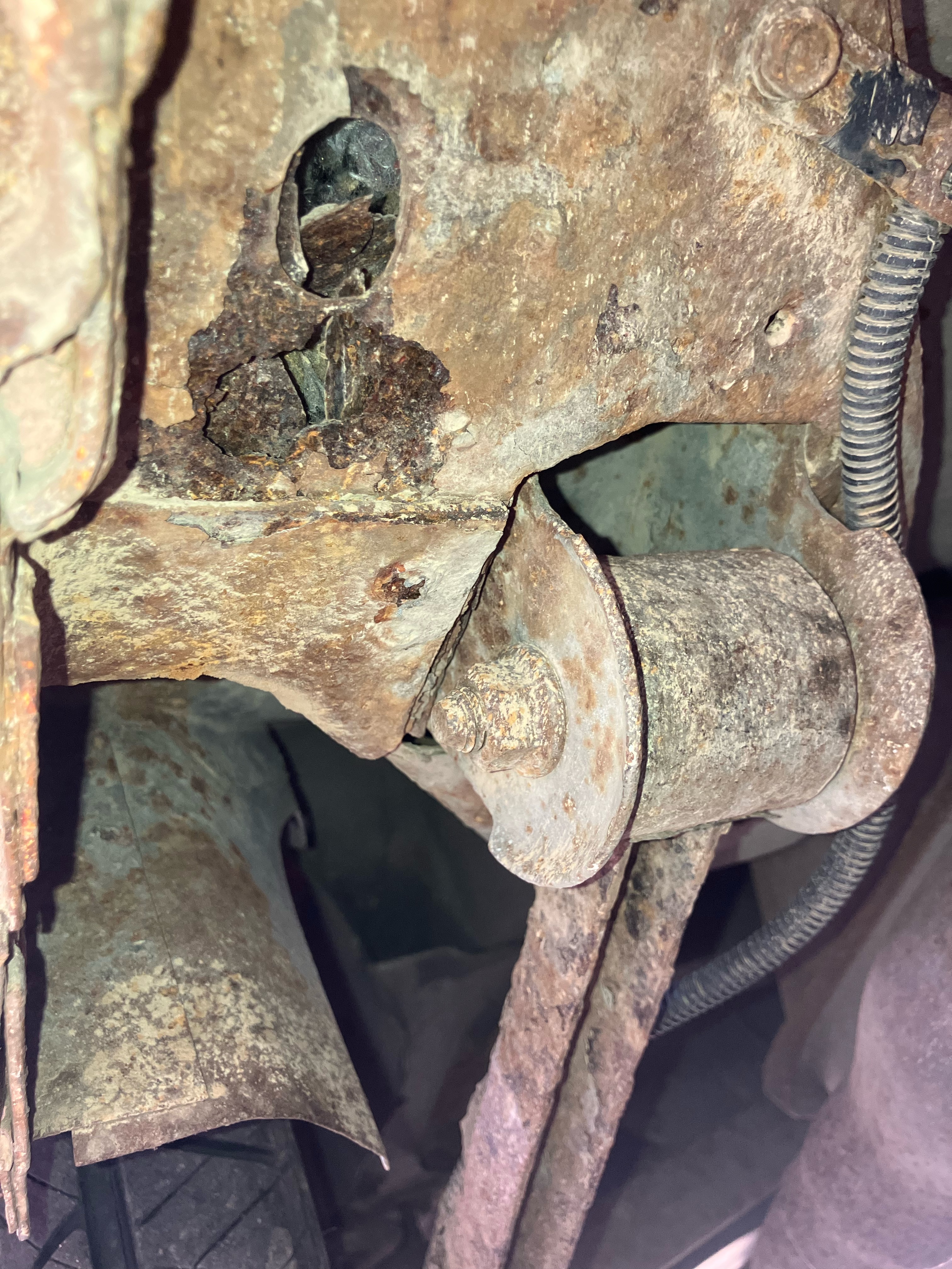

Is this too much trailing arm rust?
Go to solution Solved by 94 olds vert,
I bought a 95 grand prix sedan as my winter car. I was poking around with a screwdriver when I poked through my rear trailing arm where it mounts into the U body. Everywhere else on the mount seems solid. Its just below that little oval where it is rusty. Is this too dangerous to drive on for a winter before I get it fixed in the spring?IMG_7083.jpeg.c5976eeeed636fdc01b6ab59b01d47c9.jpeg
  • Solution
I've seen worse than that. I would just spray it with fluid film and move on that will slow the rust down. I've seen these fail and usually they have way more rust than that.

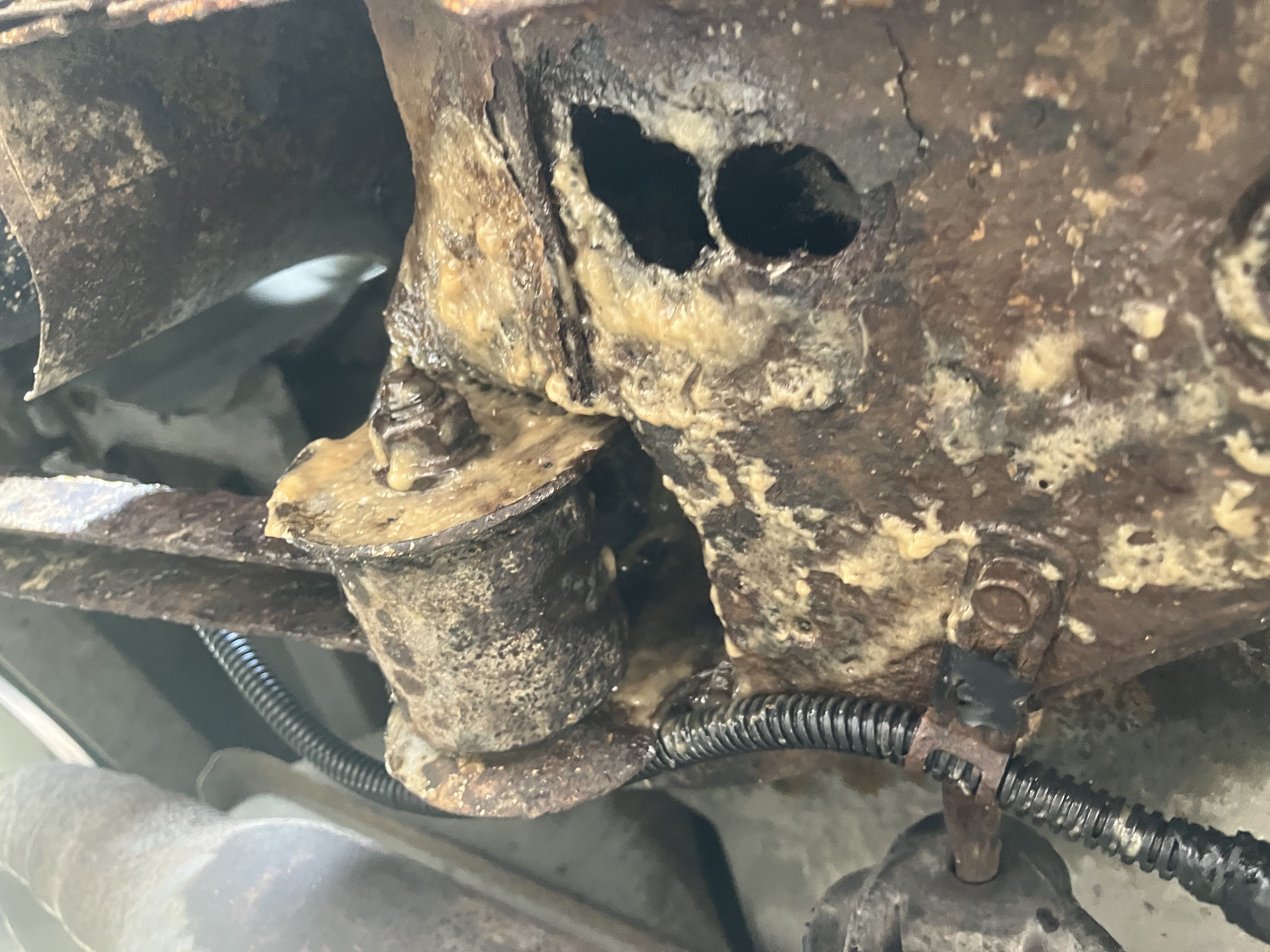

There was a mouse nest inside the mount. I removed the nest and fluid filmed it. Hopefully it lasts me the winter
