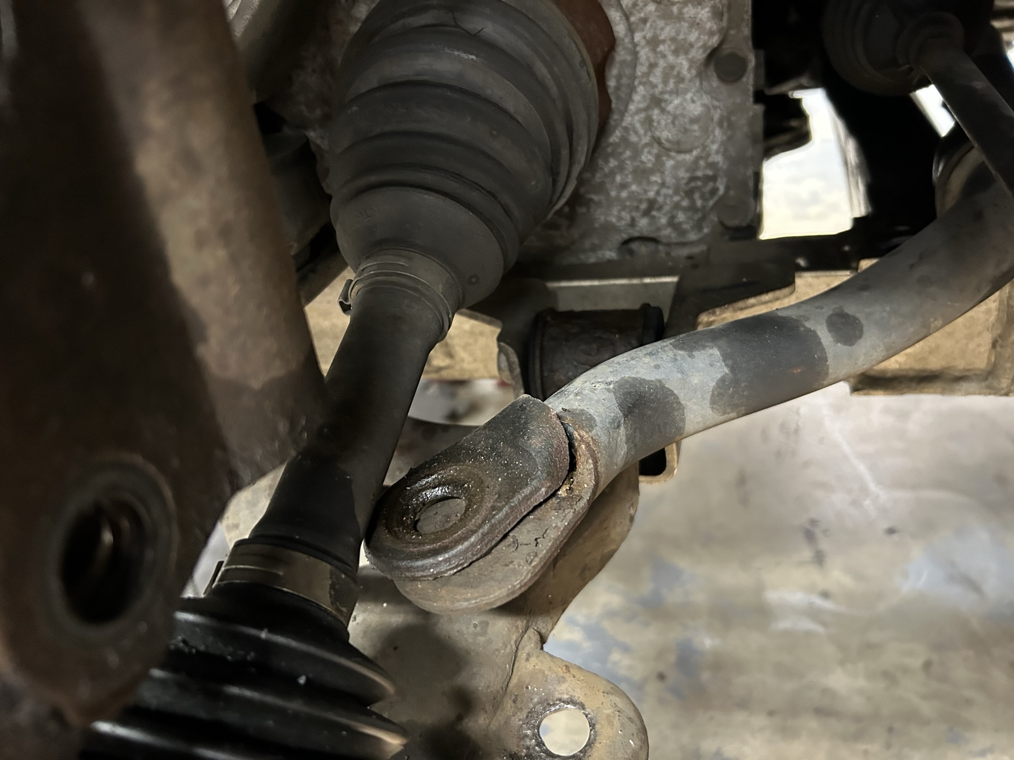

front   FE3   34mm
second in the last three years (((
Why???
Thats a new one to me Ive had the subframe where it mounts rust out but never the bar itself.
The entire area where that issue has developed is due to corrosion. One can see the rot in the tube right there.....they ARE hollow, a common occurrence with the gen 2 front anti roll bars.
If you can find a new one I’d suggest you sandblast it and powder coat. Then pour some paintable rust converter inside and coat it all around. That should stop your issues. I’ve never seen that happen before myself on any vehicle either.

Post is a little old, but I just swapped out my front sway bar with a solid 33mm one from ZZP about a month ago.  My stock bar was broke at the end (see image).  ZZP one is way beefier.
