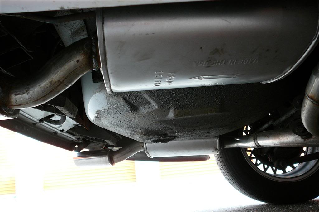

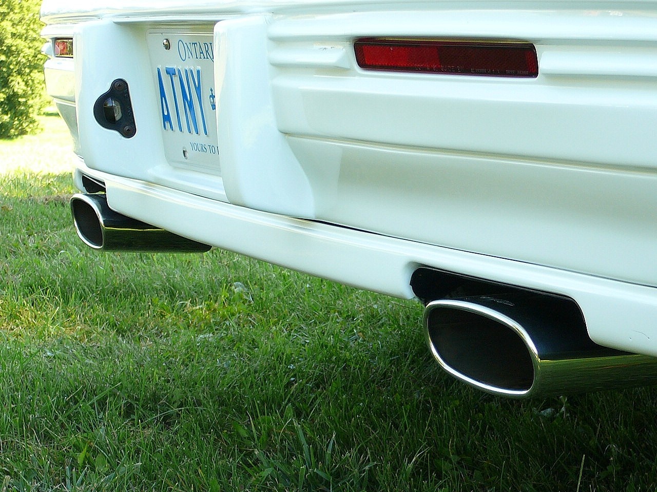

55trucker Posted December 14, 2022 Report Posted December 14, 2022 (edited) Why would you want to restrict the larger engine with the smaller engines exhaust tubing? What I would suggest is a Magnaflow cat 2.5 in 2.5 out, 2.5 tubing back to the split under the rear suspension (if you wish you can add a resonator in that length pipe alongside the fuel tank to calm down the noise ...I did), from there you can still use 2" tubing into the mufflers. You won't see a loss of cfm by using 2" dia pipe at the rear seeing as a pair of 2" pipes flow more cfm than a single 2.5" dia pipe. As for the tips....... try these.....I DID custom weld them to a pair of dog-legs that exit the mufflers up under the chassis Edited December 14, 2022 by 55trucker Quote
bluecalais79 Posted December 14, 2022 Author Report Posted December 14, 2022 Very sharp, nicely done! Quote
55trucker Posted December 14, 2022 Report Posted December 14, 2022 If memory serves the Supremes were not fitted with polished tailpipe tips, the tubing was the same 409 stainless that the mufflers were made from & the aftermarket mufflers included the welded on exhaust tip. As far as I know the inner ports at the back end of both mufflers were dummies like the GP mufflers were. rich_e777 1 Quote
bluecalais79 Posted December 15, 2022 Author Report Posted December 15, 2022 You are correct, those dual tips are black, I'm wondering about the feasibility of cutting them off, repainting them and re-welding them onto whatever I buy. Probably too much trouble and this car is a driver so I won't be waiting too long to get something done. I sure wish I had bought the AP 700444 and 700355 when they were available. Quote
55trucker Posted December 15, 2022 Report Posted December 15, 2022 From a personal standpoint I wouldn't even bother with the OEM replacement Supreme mufflers, they were huge, a gigantic 7x9 shell, and I'm reasonably sure the inner rear ports were non functional (dummies). I'd just get a pair of the GP (non GTP) left side small muffler (or equivalent) & fit those under the car, pick up a pair of short S-bends (dog-legs), fit a pair of tips onto the ends, weld those to the outlet ends of the mufflers, add a resonator upstream. I'm not suggesting that you need to do what I did (18 years ago), but this arrangement works well and sounds decent (not loud, no braaappp) rich_e777 1 Quote

55trucker Posted December 16, 2022 Report Posted December 16, 2022 At the time I redid the exhaust I purchased Maremont general purpose mufflers, Maremont no longer exists, your only avenue for AN OEM style muffler would be AP. Both of what you see are 13" shell, 2" in/2" out, inlet offset, outlet centred, back then stainless was a just a dream. Seeing as I have the old paper catalogs from both Walker & Maremont I had to search the listings by *size* & find a muffler number that would do what I wanted. Below is the weblink to AP's online catalog for entire systems. https://showmetheexhaust.com/ Quote
