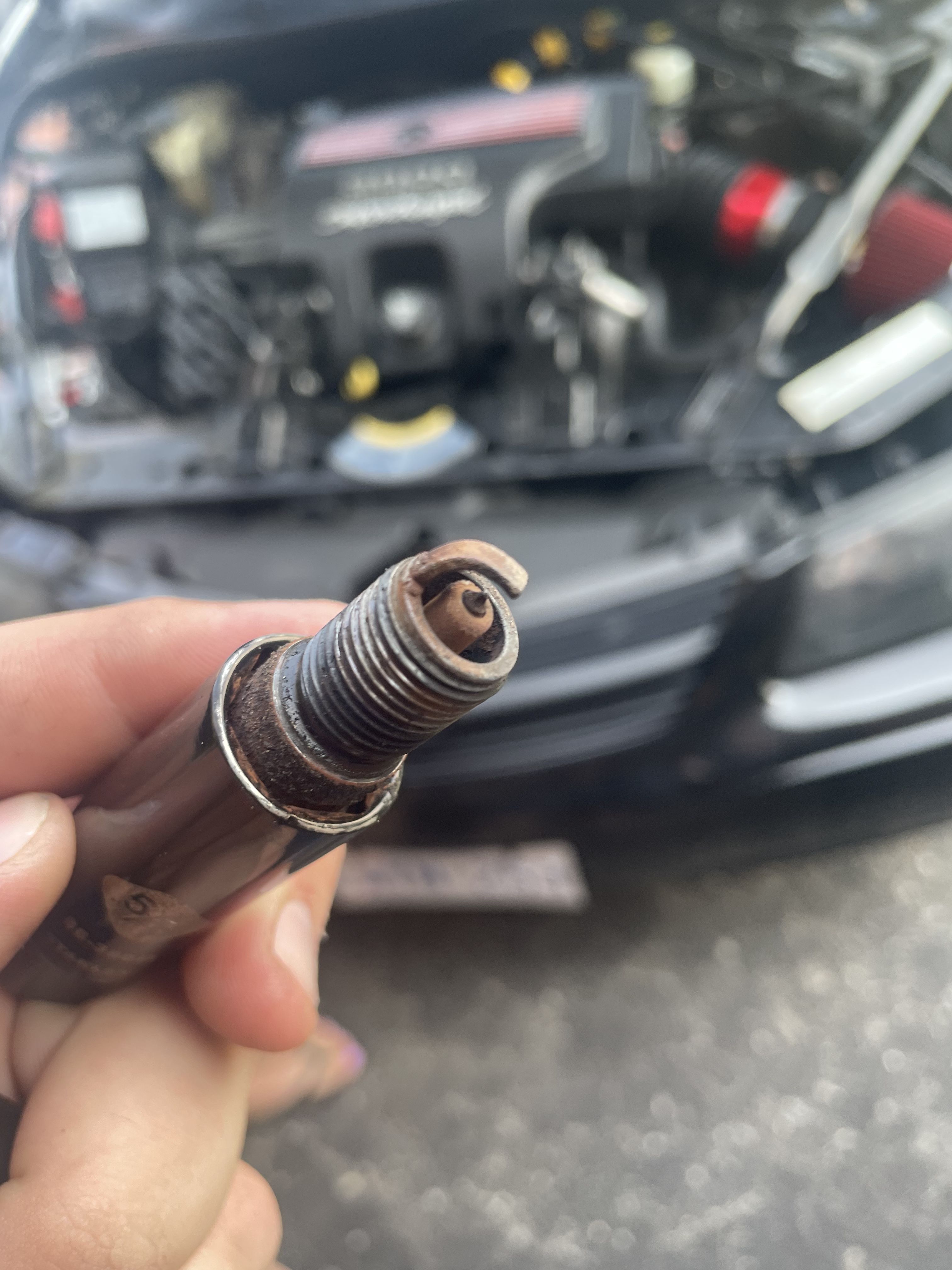

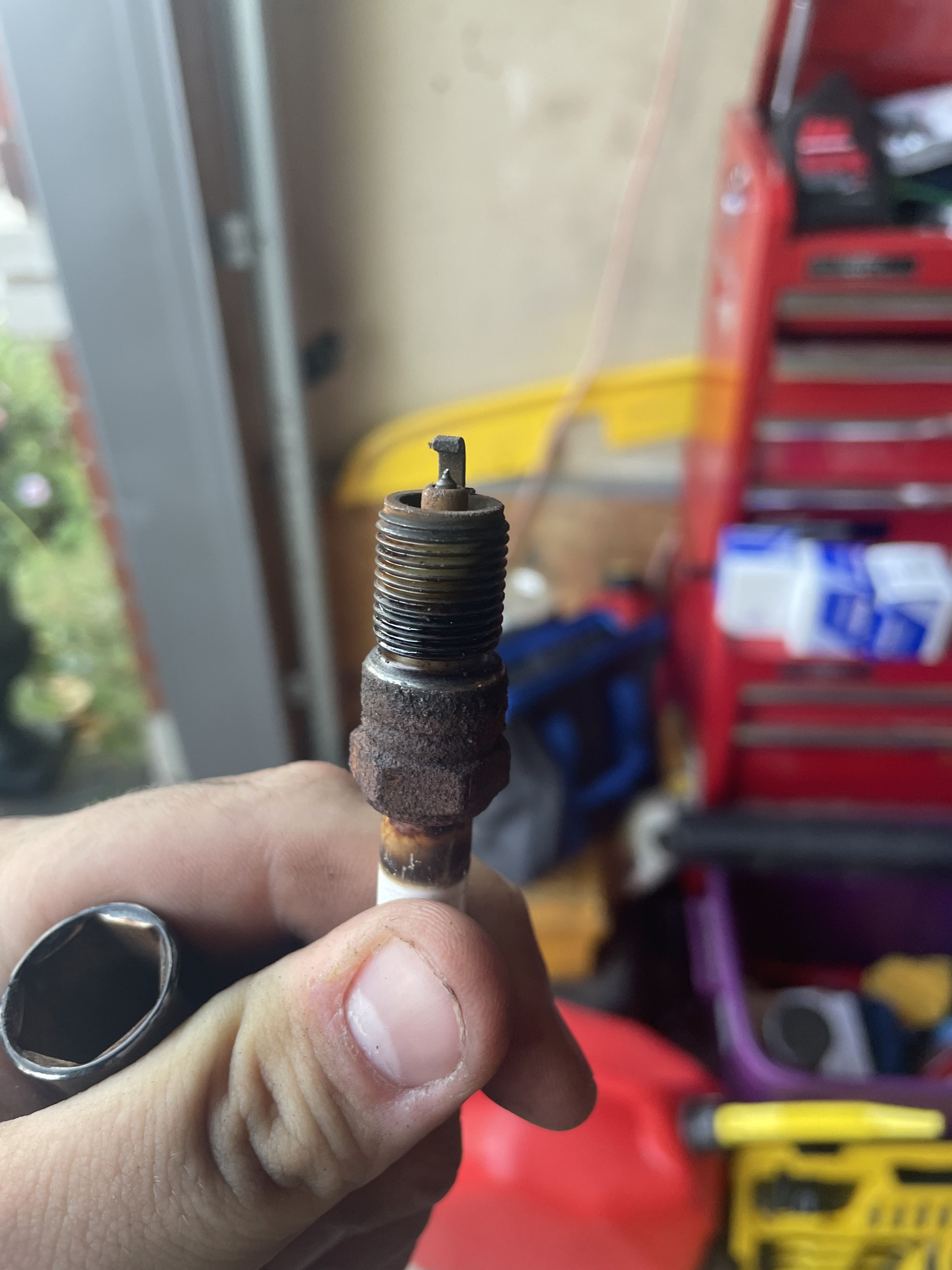

Impalass04 Posted October 10, 2022 Author Report Posted October 10, 2022 Now that i think about it they are the single platinum plugs the old plugs all looked the same but I was chasing the misfire before aswell which is why I changed them these pics are what all the old 6 looked like I’ll take it back to my buddy’s shop to put the scanner on it again I ordered a new set of autolite cooper plugs which zzp recommends I went with the 104s Quote
