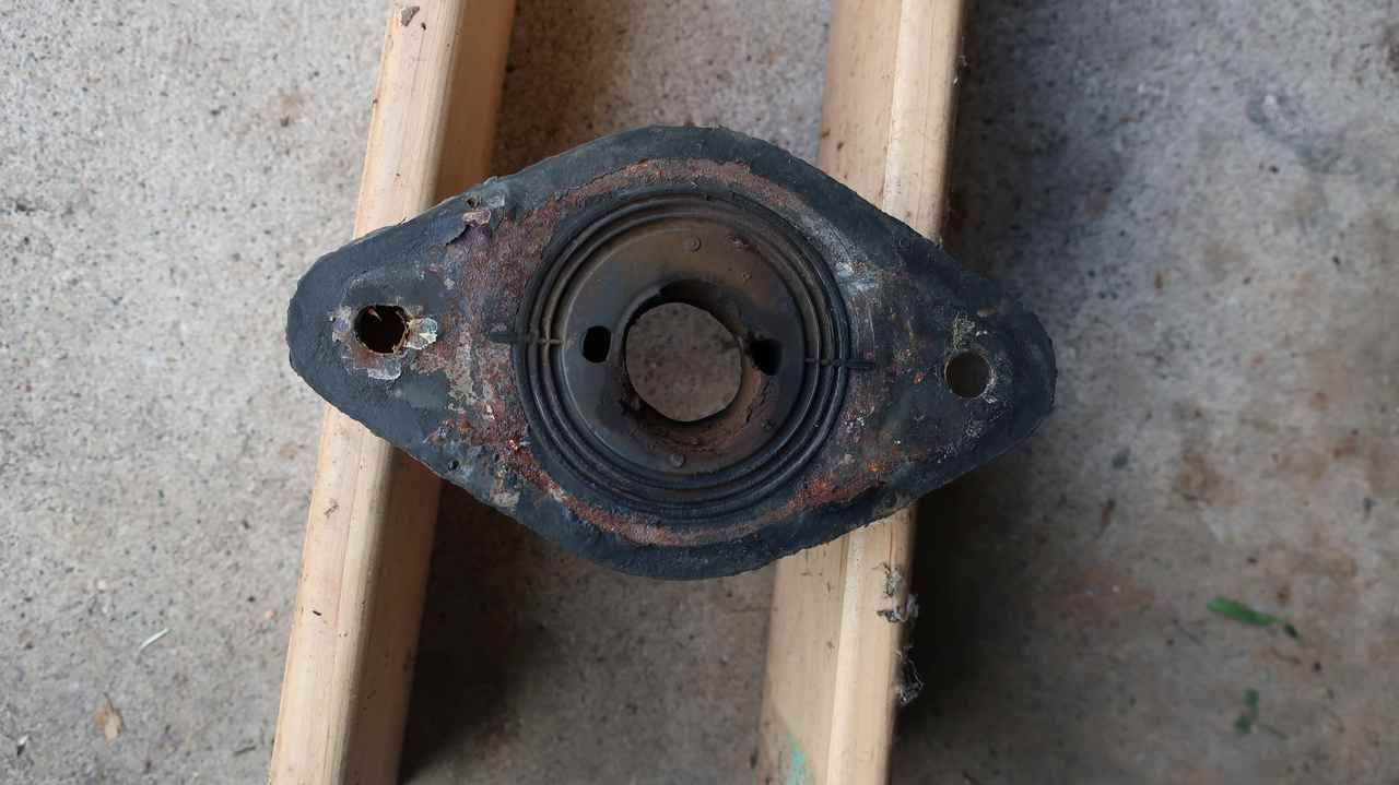

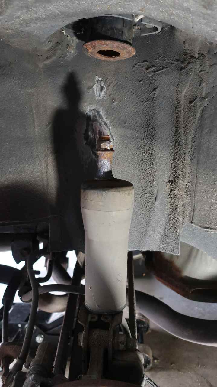

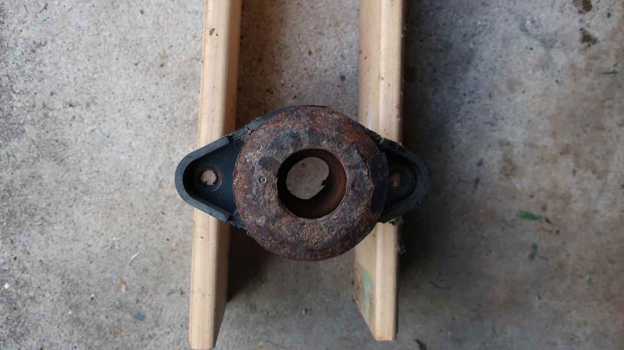

kcac Posted July 29, 2022 Report Posted July 29, 2022 The right rear strut let go on my 1995 Cutlass. Looking at the attached photos, do I need a new strut or just the upper mount? The struts are 15 years old and have have about 10,000 miles on them Thanks for any advice on this. Kenn Quote
GTP091 Posted July 30, 2022 Report Posted July 30, 2022 (edited) You definitely need a new mount. The strut pulled right through it, hope this didn’t happen at speed. Looks like it scored the inner fender well up as well. I’d remove the bolt and take off the leftovers of the mount and inspect the strut itself. Hit the nut now with PBblaster, there should be a torx or hex up top to keep it from spinning. If the strut is in good condition still, then use it? You should really change suspension parts in pairs so if one is replaced you should do the other side as well. Certainly get two mounts on the way quickly. The other mount is probably not far behind and next time could cause an accident. Rockauto! Edited July 30, 2022 by GTP091 Quote
55trucker Posted July 31, 2022 Report Posted July 31, 2022 You need a new shock(s) as well, the gas charge has evaporated from that one. Quote
55trucker Posted July 31, 2022 Report Posted July 31, 2022 Be sure to keep a jack under that side when the wheel is off & don't allow the spring to droop low enough to rip the brake flex line open. Schurkey 1 Quote
