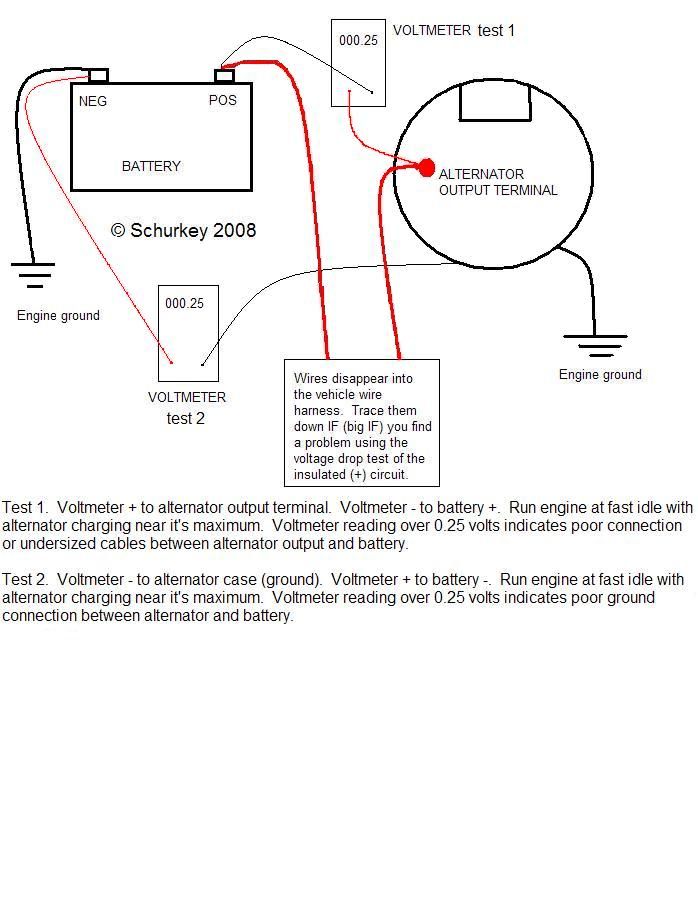

What is the charging voltage when the engine runs?  Typically, a GM will show 14+ volts at the alternator output stud, with the ground for the meter touching the alternator housing.

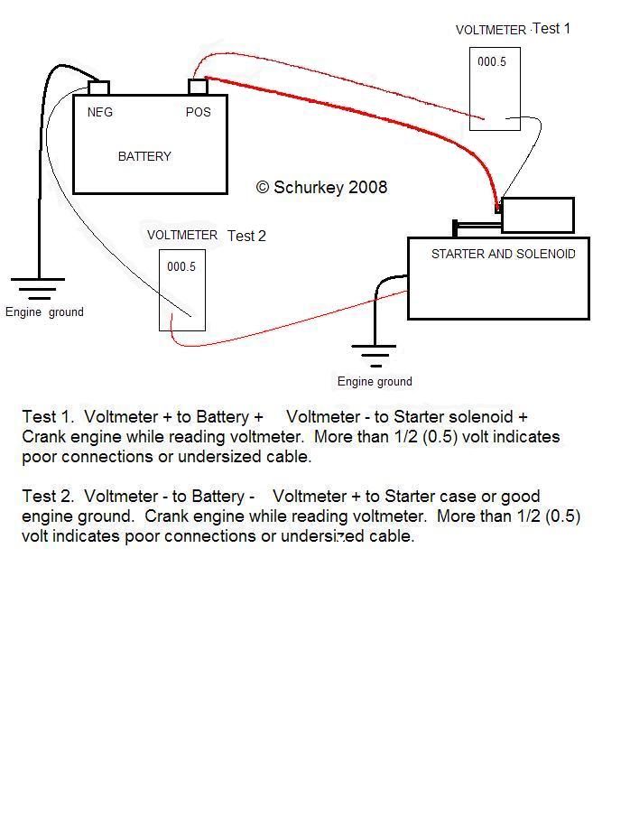

Loose/corroded battery cables, and/or defective cables are a strong possibility.  Cables are known to corrode under the insulation leaving almost no copper "conductor" in place.  But it looks fine from the outside.  Voltage-drop testing can find those problems.
