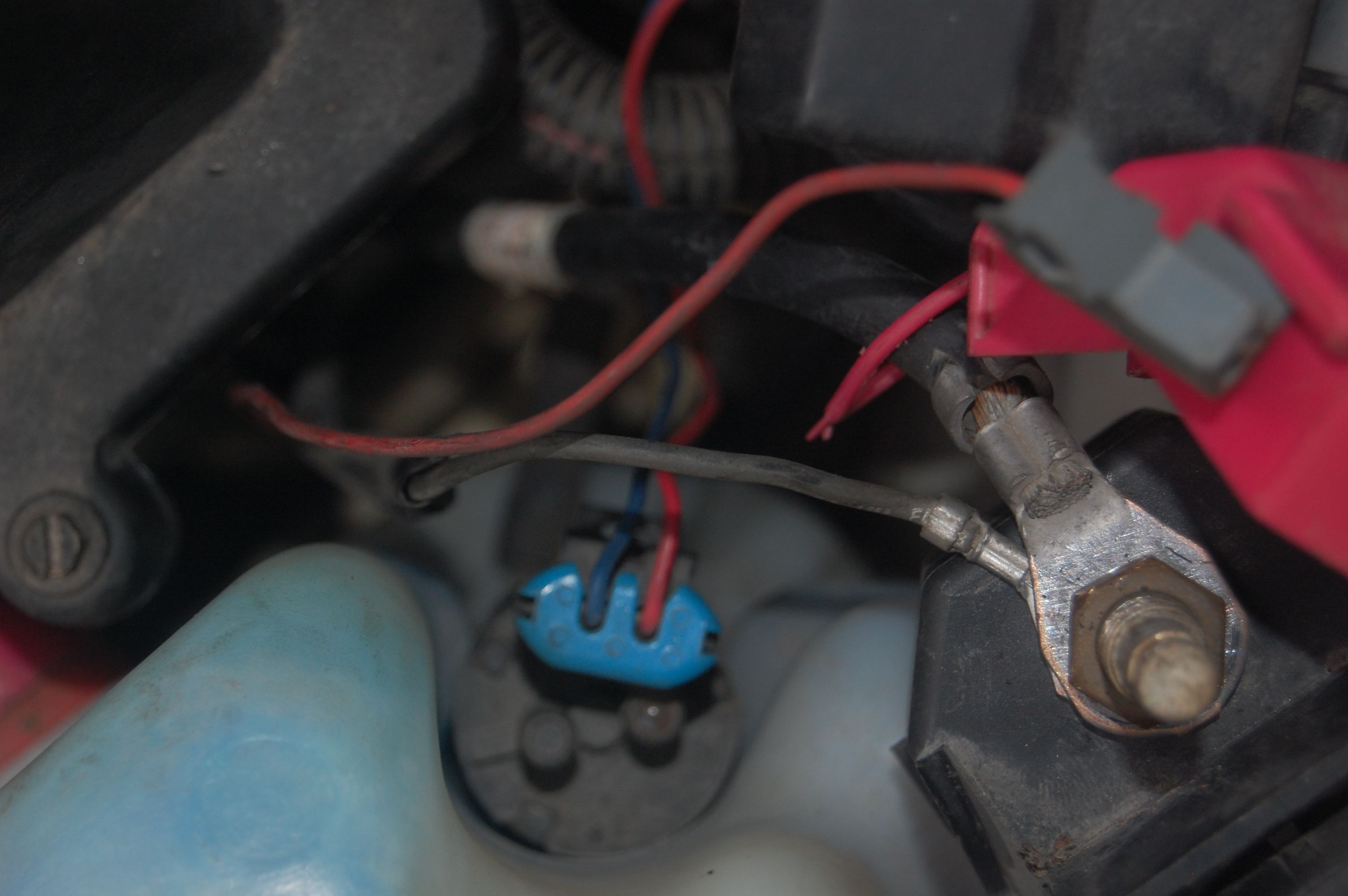

Does the fuel pump have power and ground?  Will the pump run if you provide power to the fuel pump bypass wire? On my '92 and '93 Luminas, the bypass wire is a single, red wire with a grey plastic connector end.  It is next to the accessible battery-power stud near the battery, but not connected to it.  Photo shows it laying to the side of the windshield washer tank/pump, on top of the red plastic stud cover.  Cram a jumper wire into the grey connector so that it gets battery power.  Pump should run, for testing.
