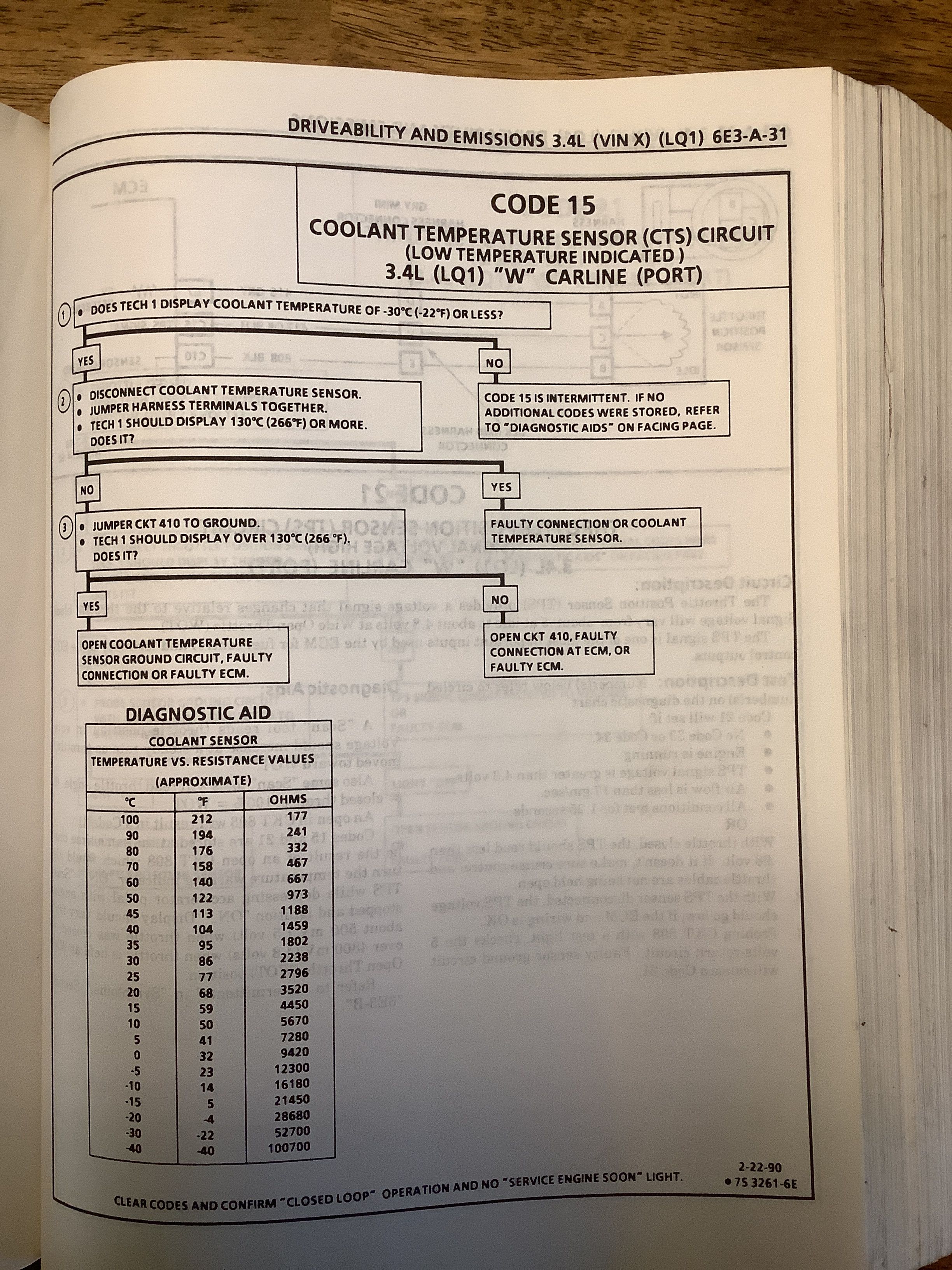

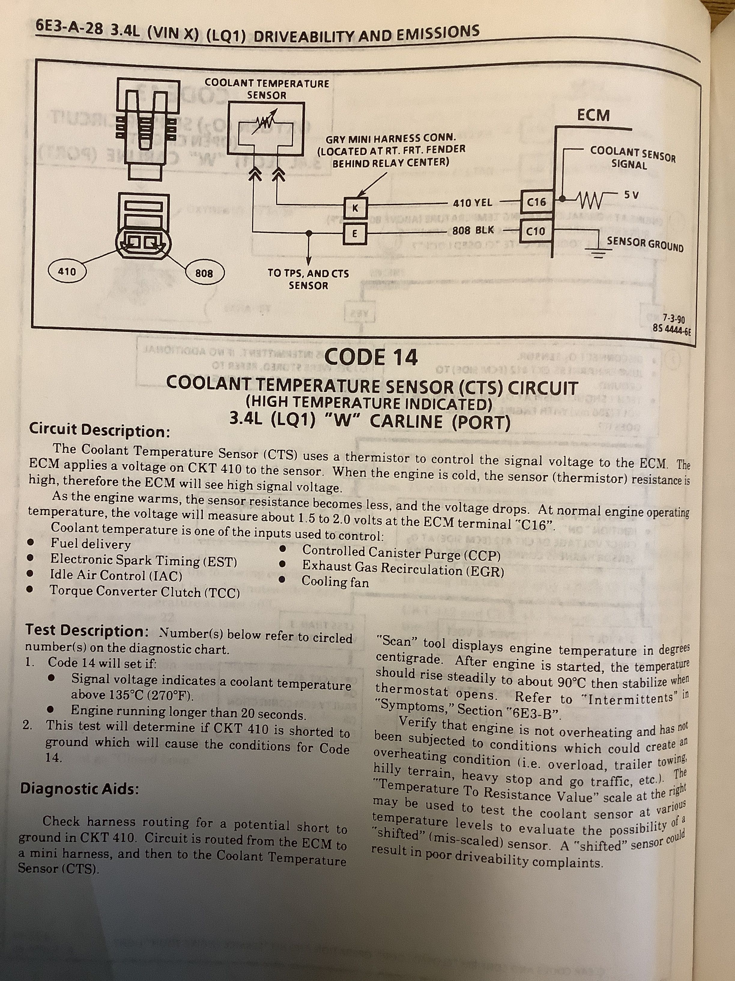

Schurkey Posted July 11, 2022 Report Posted July 11, 2022 On 7/8/2022 at 9:15 PM, Bjankins1 said: my coolant temperature sensor does not work, There's one sensor for the dash gauge, and one for the computer. I'd be looking at the sensor AND THE WIRE HARNESS for the dash gauge. That's more likely than a failed gauge, although that's a possibility. On 7/8/2022 at 9:15 PM, Bjankins1 said: Now this should be throwing a code 14 or 15 I think, but the service engine light will not come on for it, it will come on when the car is in accessory, but not when it's running, the OBD 1 reader does work, but throws only a code 12, like normal, Forget "code readers". Connect a real scan tool, look at the data stream. Verify every sensor, find out how hot the computer (not the dash gauge) thinks the engine is running at. On 7/8/2022 at 9:15 PM, Bjankins1 said: and the radiator fans kick on normally too which leads me to another huge problem The radiator fans do not operate correctly, Which is it? The fans work normally, or they don't operate correctly? On 7/8/2022 at 9:15 PM, Bjankins1 said: I've seen this car run really hot and what's scary is it's still going but I'm watching the cooling lines literally look like they are about to explode, and it's not one hose, no no no, it's almost every single hose on my car, so the pressure is insanely high, which is just great, and the fans won't work when they need too How old are the hoses? Hoses get weak when they're old enough to have deteriorated. Go to a parts store that has a loaner-tool program, rent/borrow their radiator pressure tester. Find out how much pressure the system has when it's hot. About 15--16 should be normal--it'll say on the radiator cap. The cooling fans won't come on until about 220 degrees. That's normal. Kinda thinking one should come on with the A/C, though. On 7/8/2022 at 9:15 PM, Bjankins1 said: I will mention that there is some coolant loss Pumping up the radiator pressure tester should help locate the leak. Sometimes the leak is INTO the cylinder(s), so you'd want to remove the spark plugs during this test. When the system has been pressurized for awhile, crank the engine and see if any coolant blows out of one or more plug holes. If this is a 3.4L DOHC engine, pay special attention to coolant entering #1 and #6 cylinders. I don't know of any particular weakness of the 3.1L engine. The Iron Duke four-popper is a friggin' nightmare. On 7/8/2022 at 9:15 PM, Bjankins1 said: I've noticed a hose that just looks it drips right under the front passenger control arm Coolant, or condensed humidity from the A/C evaporator box? Water coming out of the A/C evaporator box is entirely normal when the A/C is working. On 7/8/2022 at 9:15 PM, Bjankins1 said: I need a block test What is a "block test"? On 7/8/2022 at 9:25 PM, Bjankins1 said: Also I have the strangest issue that my gf and I cannot figure out, the car is blowing hot air constantly, it's California summer out here and it's unbearable in the car alot Does the A/C work? WHERE is it blowing hot air? From the radiator fans? From the HVAC fan/ducts? 22 hours ago, Bjankins1 said: I plan on getting a block test and when I get home I'm gonna bleed the cooling system I don't know what a "block test" is. The 3.4L DOHC engine has cooling system bleeder screws, I don't know about the 3.1 or 2.5 engines. Quote
Bjankins1 Posted July 12, 2022 Author Report Posted July 12, 2022 A block test is a pressure test, just used to calling it that cuz that what folks on the Cadillac forums say, I'll have to check under the dash when I get home, it's the 3.4L, where can I get a scan tool and where are the wires located that sends data from the engine to the ECM? I mean this is the strangest thing but I got it to work one time and it read a code 15 and the service engine light stayed on while driving but it has never came back after shutting the car off, the radiator fan issue is a mystery, correct me if I'm wrong but when the fans kick on when the OBD1 reader is being used, isn't it being used from a different relay, that is what i have at least read but I could be wrong Quote

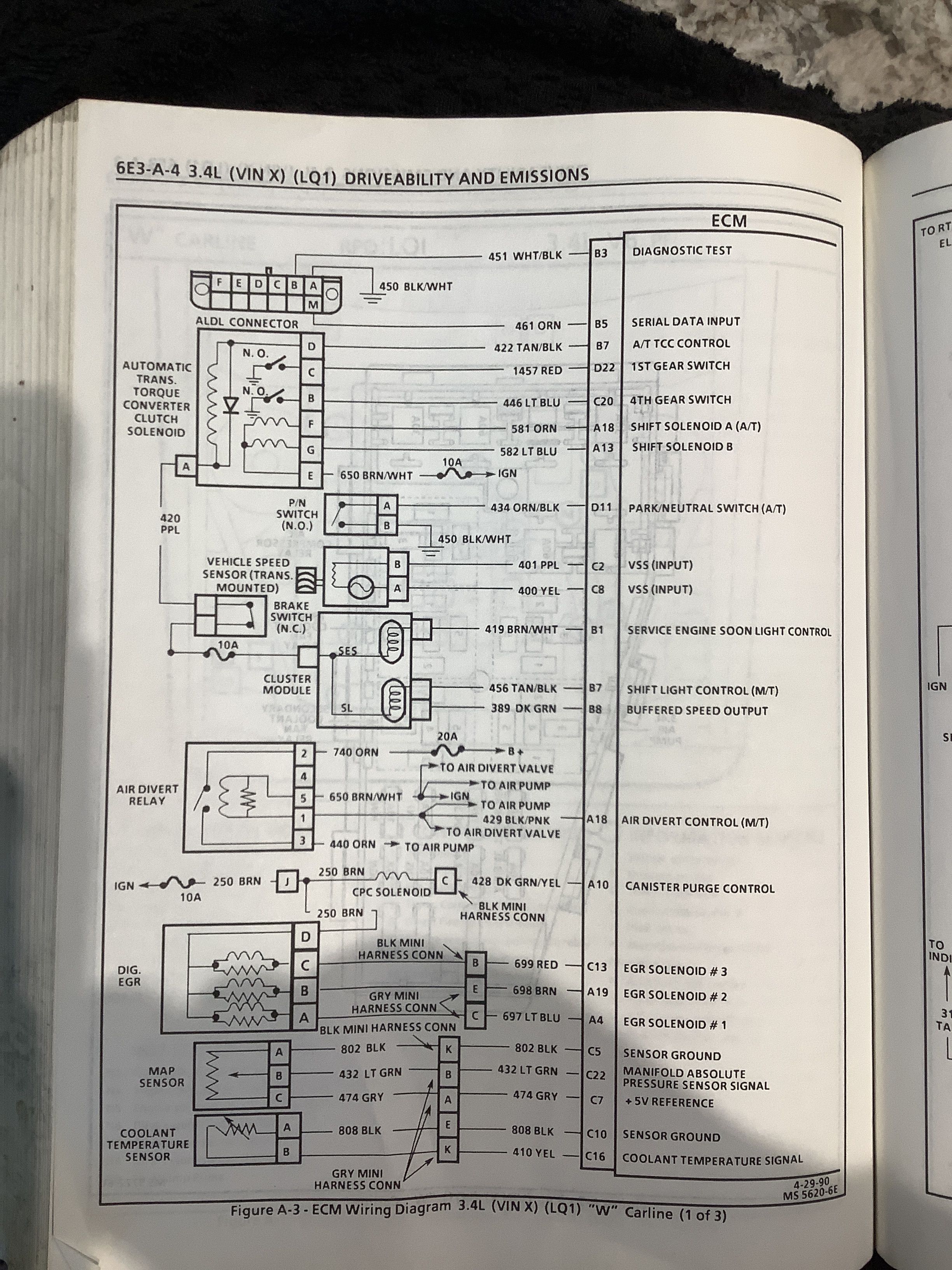

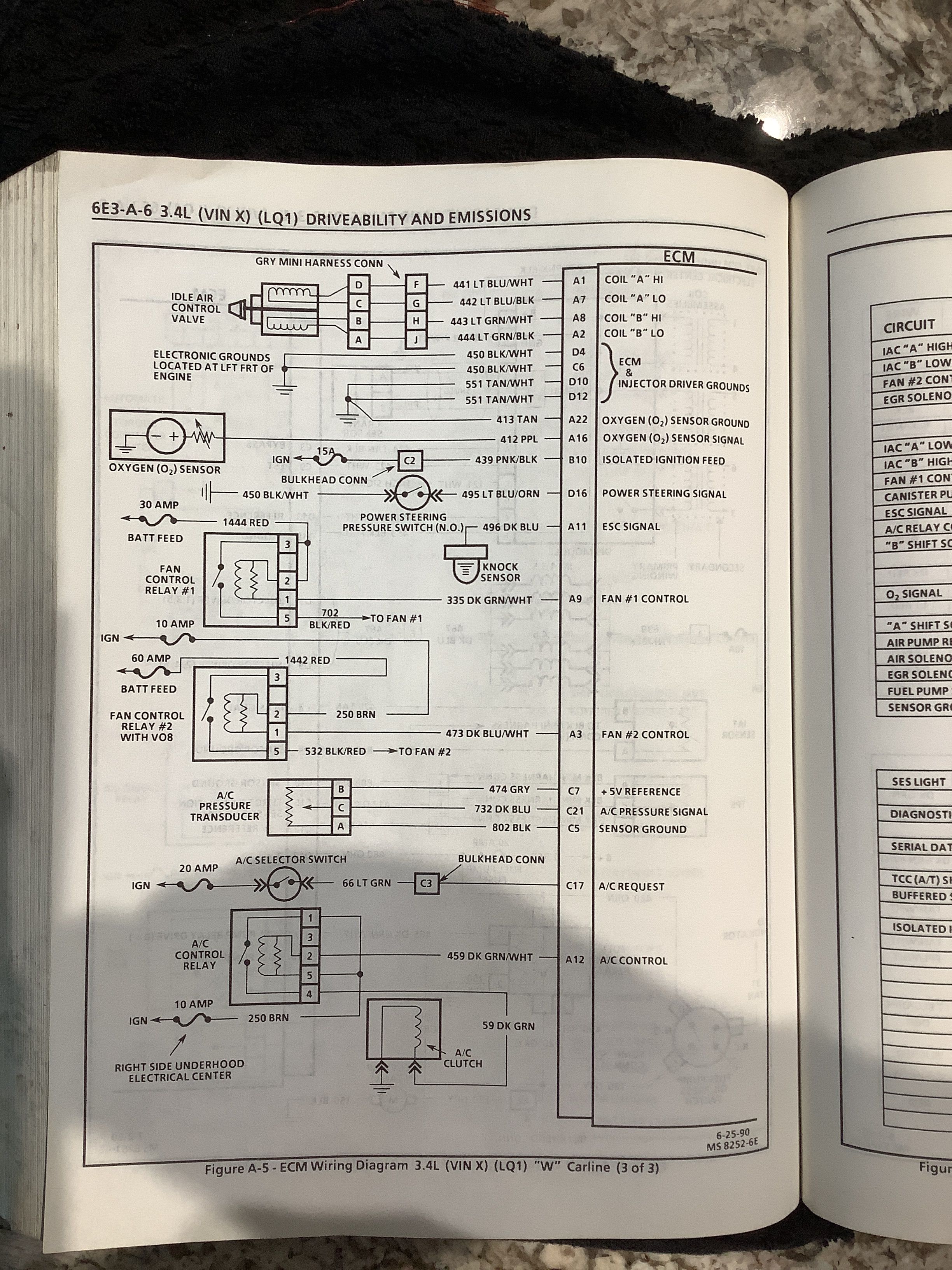

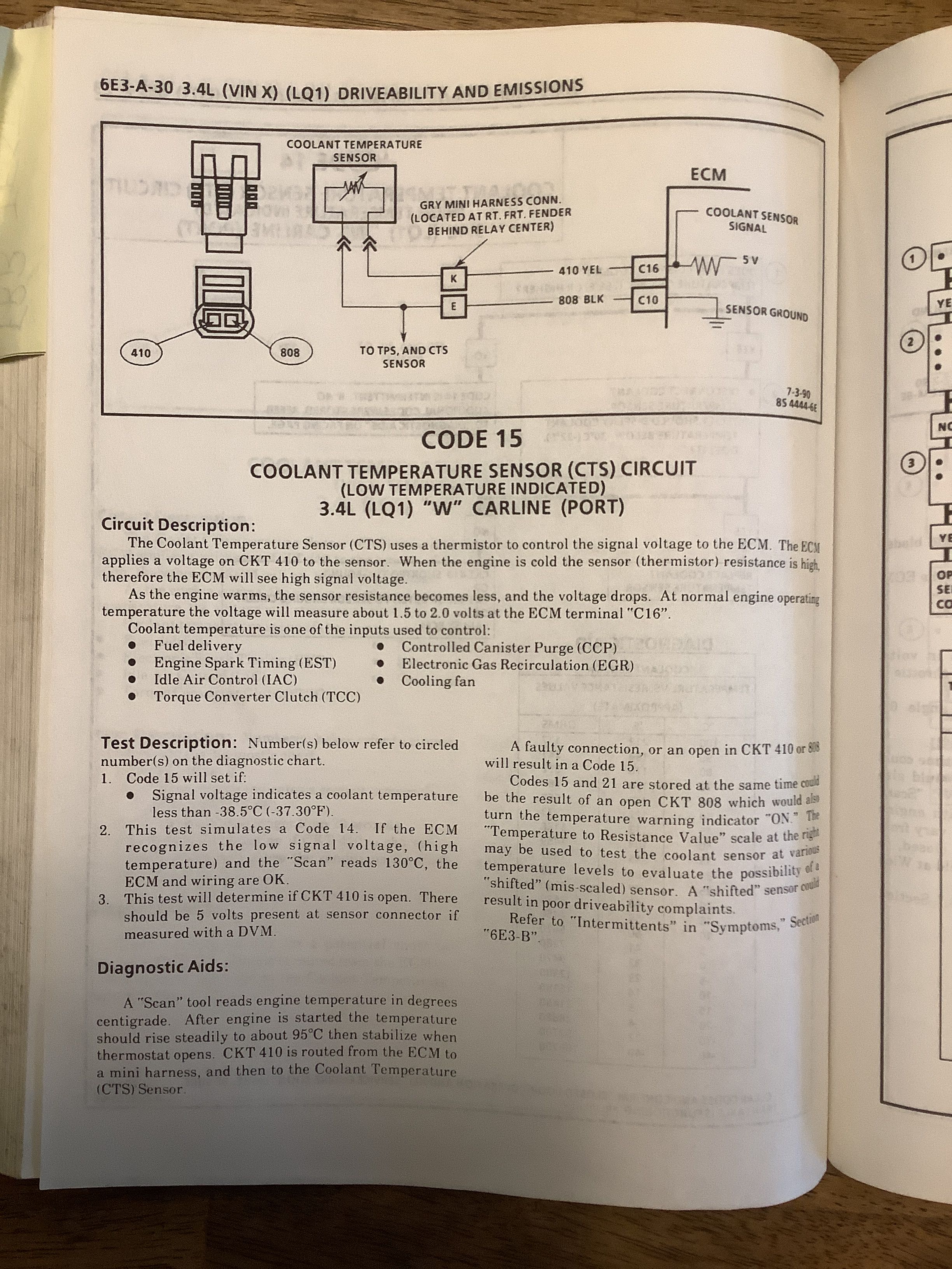

GTP091 Posted July 25, 2022 Report Posted July 25, 2022 (edited) From what I’ve read of the issues your car is having my thoughts go toward you needing to do a thorough coolant system service. Your rad cap is stuck/corroded on, the car overheats, it’s thrown a code 14 which is high temp. If it runs alright I wouldn’t worry much about the ecm or cluster wiring yet. If it’s throwing a code 12 and the fan comes on when reading the codes your ecm is good. id suggest buying a new rad cap, taking the old one off and see what’s up in there. It could be the previous owner was a nimrod and mixed coolant types and you have a gelatinous mess in there, it’s really old, not the proper mix, your thermostat is pooched, etc who knows until you take a look. Hopefully it just needs a service. The fact it ‘ballooned your hoses’ and over pressured could indicate a head gasket leak but start with the coolant system itself. the ALDL port will tell you what the ecm is doing with a proper scan tool instead of a code reader(paper clip). I have an ALDL to usb cable that connects to your laptop with tuner pro. Much easier and cheaper than a proper scan tool. Go to moats.net to get one. I’d say your wasting your time there though check the cooling system first. I’ve attached the troubleshoot for code 14 and 15. Won’t be much use though if you can’t see the actual temp readout from the ecm. Edited July 25, 2022 by GTP091 Quote

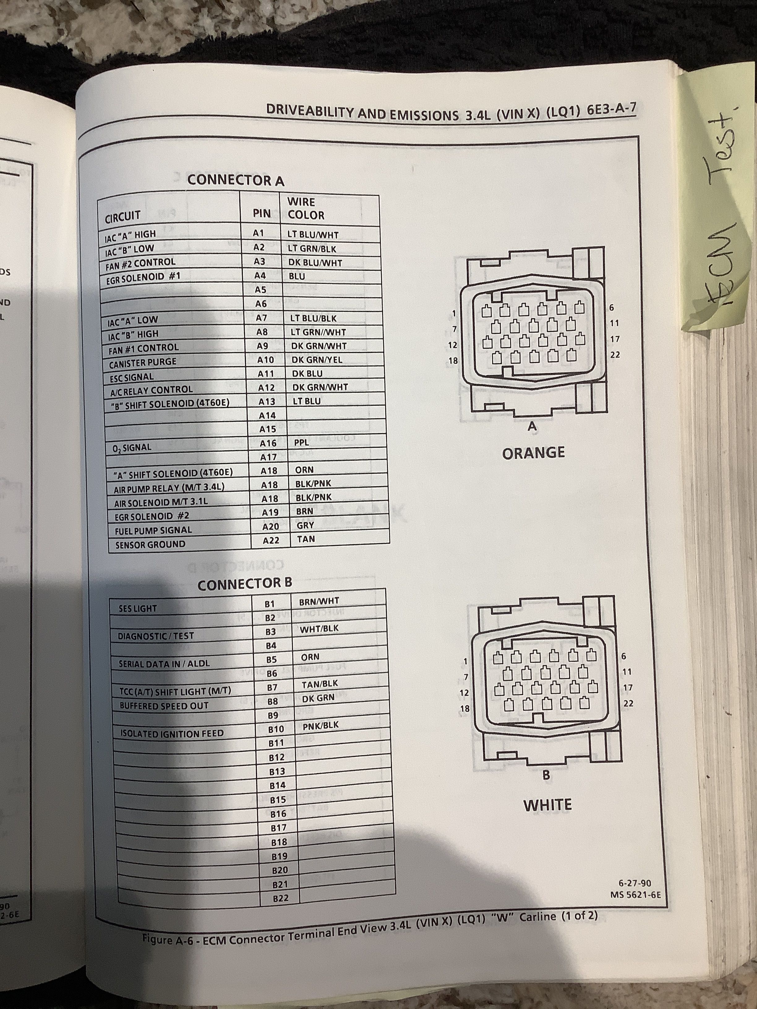

GTP091 Posted July 25, 2022 Report Posted July 25, 2022 Round 2… after you service the cooling system. It’s not likely there’s anything wrong with these wires unless some monkey messed shit up. So you’ll be r time and possibly breaking stuff if you don’t do the easy part first. Provided you have a digital voltmeter. You can check the continuity of the wire from the ecm to the coolant temp sensor to check for short or open circuit. Circuit 410 is yellow. Do this with the battery disconnected. 1. Unplug the coolant temp harness. 2. Probe the black wire for continuity. If you get nothing you have a broken ground wire from the sensor to the ecm. 2. Unplug green harness from the ecm ( getting to the ecm is a chore in itself) 3. probe the yellow wire from the sensor harness and C16 of the ECM harness with your voltmeter. If you don’t get continuity you have a broken wire. 4. Probe C16 on the ecm side and put the other lead to ground. If you get continuity you have a short. Pictures of the ecm and harness are below (from a 91) The first and last are all you need for this test. Be very careful handling the wires and harnesses they’re old! after you put everything together and reattach the battery remember to reset the IAC valve by cycling the key on and off 3 times. Engine may start and die immediately if you don’t. Quote

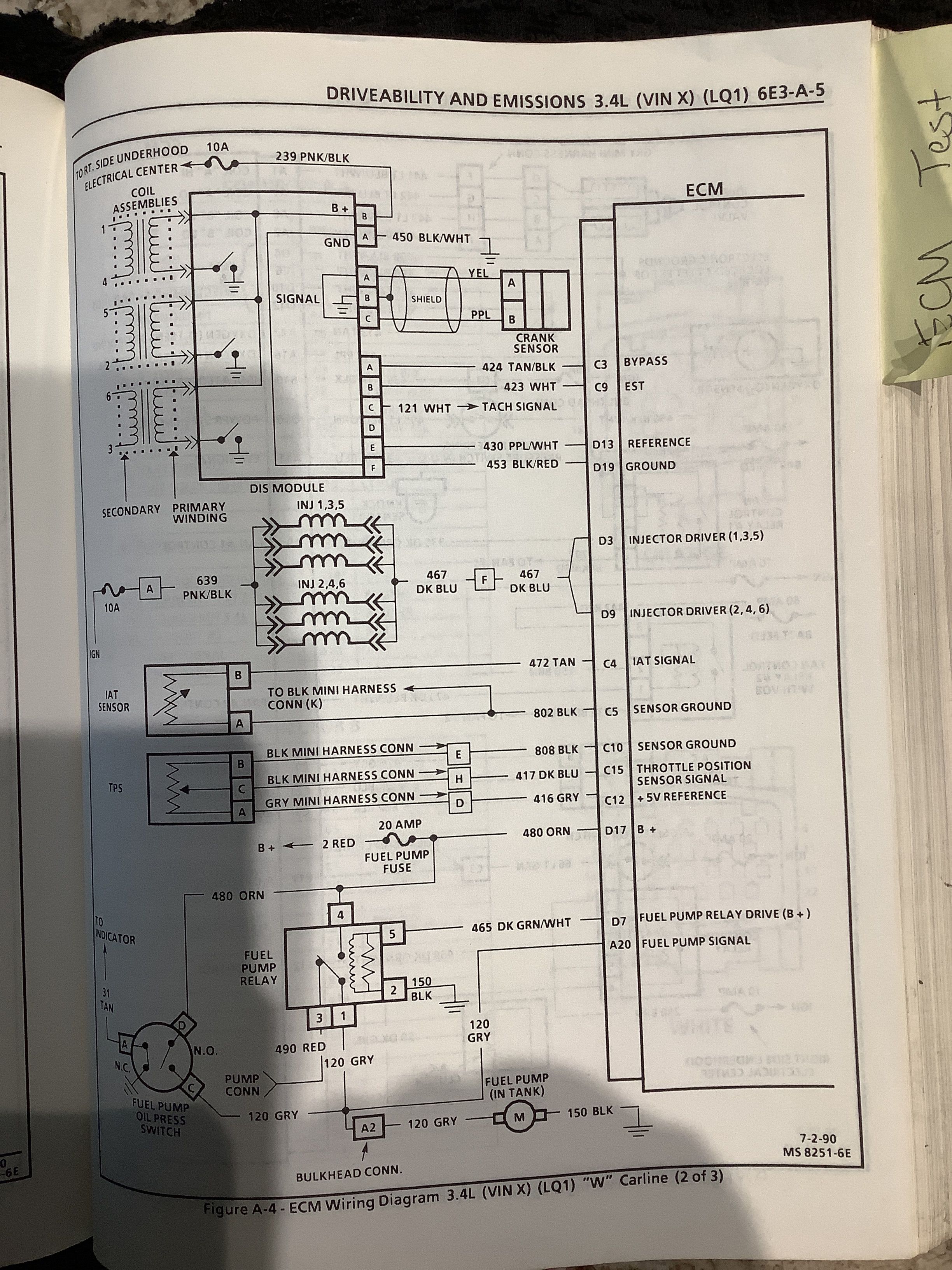

GTP091 Posted July 26, 2022 Report Posted July 26, 2022 That my friend is a classic symptom of a dying crank position sensor or something up with the ignition pack. Ignition control module or faulty wiring. Bad coil will usually give a miss so I doubt it’s that. Could be ECM though. You’re going to have to get you hands dirty and take this one at a time. Post up some pics of your car. if you getting a code 12 your ecm should be good. Here’s what GM says about ECMs. And how to replace one, read the functional check part first (last pic) Quote
