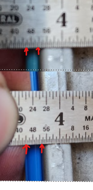

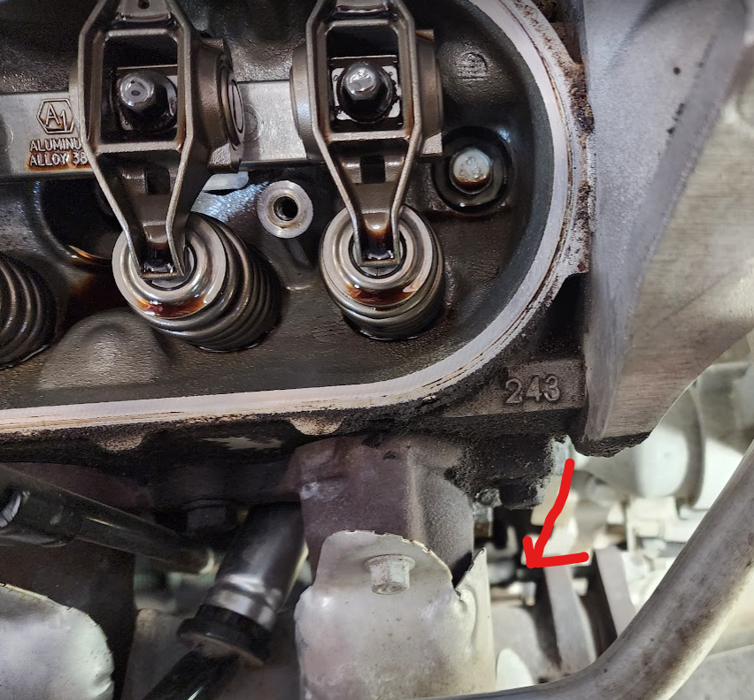

Finally got back to it last Friday. I think it might be the valve covers. The other issue was when I did the valve covers I clean the entire engine compartment really well. What you (LAI) said was in the back of my mind this whole time. What was throwing me for a loop was the side of the block was dry. Long story short, I think the leak was running down the head (1st Pic) to the back (well driver side in the GXP :-)) So I just pulled the valve cover just to look and found it. The mistake I made was not using the blue Felpro.

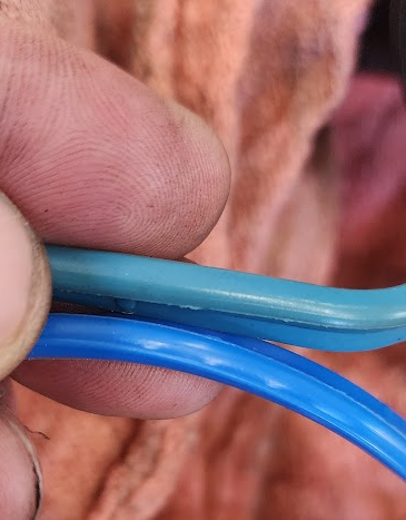

Not sure if the picture shows what I am talking about, but the tab that goes into the slot to hold the gasket is wet. I am starting to think the oil was being pushed up and over. The car has 190,000 so I sure there are some blow by building crankcase pressure.
I can't tell, but the tab on the blue Felpro looks a tad longer
Also, not sure the round part is a little bit bigger also.
Kind of hard to tell, but I think the Flepro blue is 3/64 bigger.
I know you are not suppose to use RTV, but I did put a little in the slot, just in case my theory about crank case pressure is pushing it around the tab.
