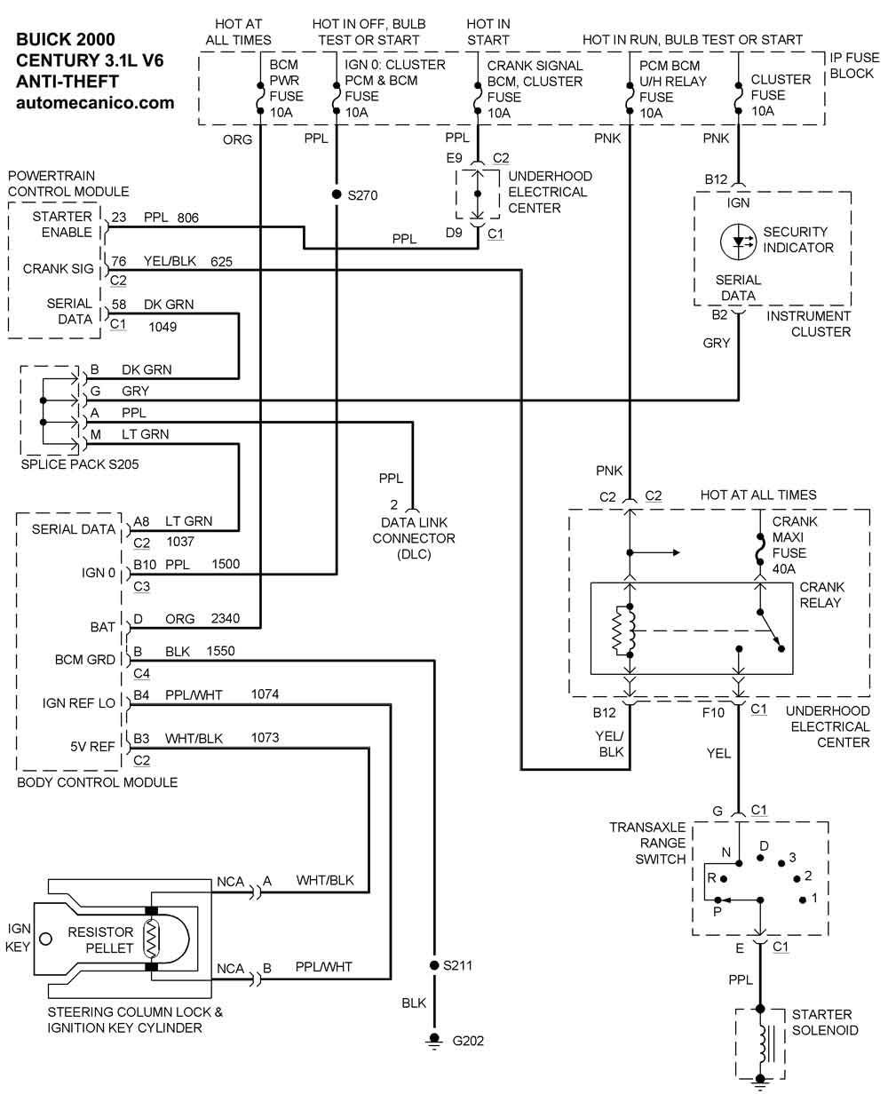

55trucker Posted April 18, 2022 Report Posted April 18, 2022 (edited) 8 hours ago, Krellmon said: I'm assuming you meant VATS. If not, I'm not sure what you mean. It is equipped with VATS Passkey 2. The Passkey sensor is reading the right resistance and the BCM has been replaced since this started... The security relearn on BCM has taken the security light off. Yeah, GM refers to the anti theft as VATS, Ford calls it PATS, all of my daily drivers are Fords.... I don't have any gen2 service manuals on hand but here's a basic schematic that should apply to the Regal. If you've got no voltage at the solenoid when you attempt a start you have to use your diagnostic prowess & start back tracing the circuit to find out where the problem originates. Dead at the solenoid? go backwards to the transaxle switch, if that's dead as well move on to the crank relay, where the crank relay is concerned pull the relay & test the pins for circuit continuity, probe both sides of all the contact points (in & out) everywhere trying the key in *start*. Backprobe all of the pins with your meter to test & locate where the problem lies. To me it sounds as tho you've possibly got a short to ground when you turn the key to *start*. Edited April 18, 2022 by 55trucker RPE1992GPSE, Krellmon and Schurkey 2 1 Quote
Krellmon Posted April 19, 2022 Author Report Posted April 19, 2022 Well guys I have good news and bad news. While troubleshooting today, I was switching identical relays around and the car started. Moments later, after shutting it off to put the air box back together, the car would not start again. Another 20 minutes of messing with relays and it started again so I drove it around the neighborhood for 10 minutes or so. It ran amazing for having sat for so long. I parked it back in the driveway and it has started without fail 5 times. I'll try again tomorrow to make sure it's good, but it's working for now. I didn't knowingly fix any issue that I'm aware of so I'm a little confused but I'm really happy it is working now. Thanks for all the troubleshooting help guys. It kept me working on it. I'll keep this thread going if it has issues tomorrow, but I'll call it fixed for now. Hoping it's not an intermittent issue. Quote
Schurkey Posted April 19, 2022 Report Posted April 19, 2022 (edited) Of course it's intermittent. Verify the metal contacts that the relay plugs into in the electrical center. Make sure they're not loose on the relay blades. Moderate-to-good chance that swapping relays enabled actual contact with the terminals in the electrical center, but as soon as vibration gets to them, you'll lose contact again and it won't start. Yes, there could be other problems, but that seems the most likely given your statement about moving relays and suddenly it worked. Edited April 19, 2022 by Schurkey RPE1992GPSE 1 Quote
