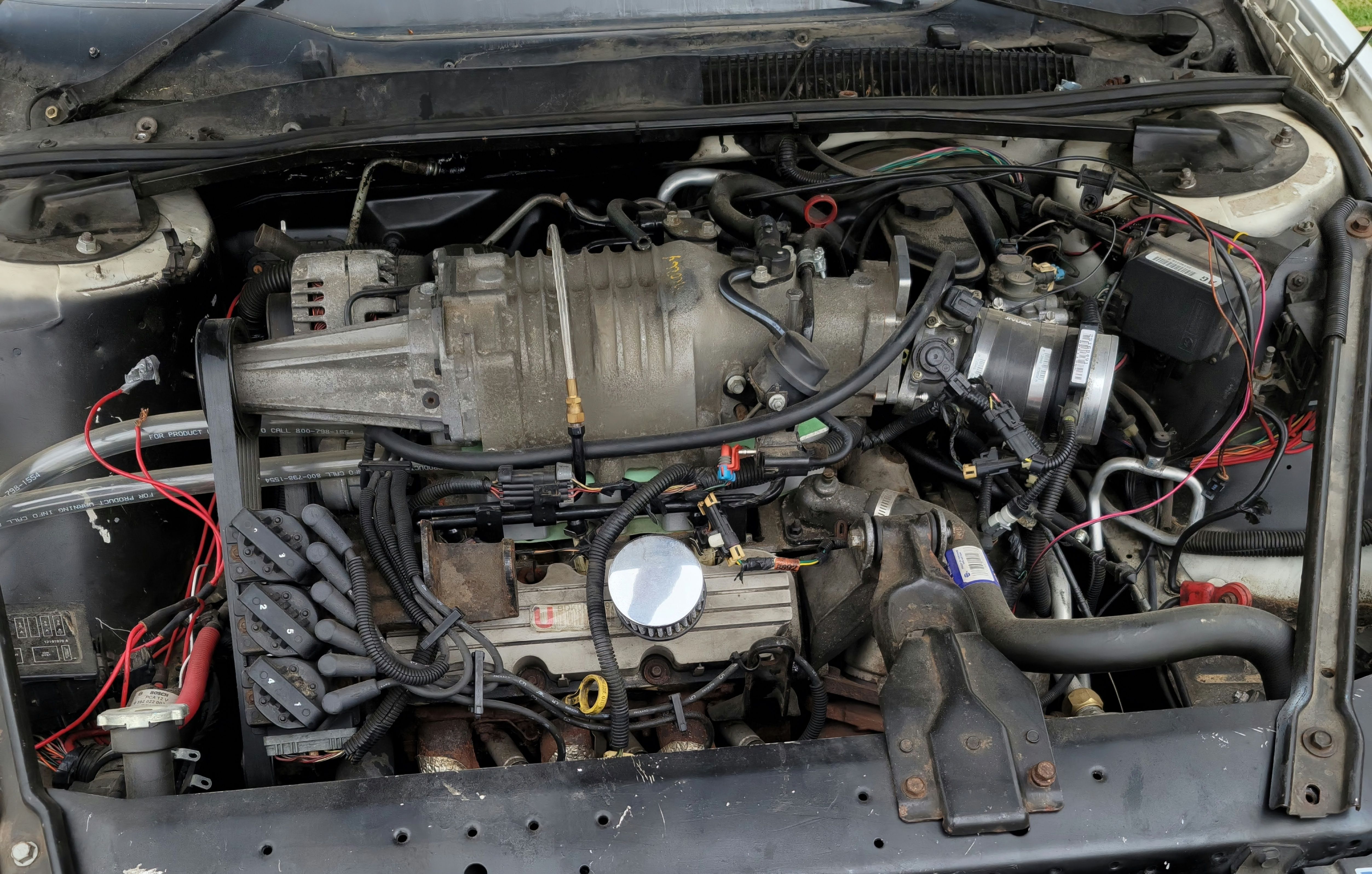

rich_e777 Posted April 12, 2022 Report Posted April 12, 2022 Post some pics! An abandoned project car with an engine swap sounds about as fun as grabbing a wasp nest bare handed. Ive always wondered what happened to all the cars with the l67 swaps over the years. What all is there and can you tell how far along the swap is? Theres a few useful swap threads that I`ll try and dig up when I have some more time. Quote
Kdon Posted April 12, 2022 Author Report Posted April 12, 2022 oldmangrimes and 94 olds vert 1 1 Quote
pwmin Posted April 13, 2022 Report Posted April 13, 2022 Sweet. Yep, looks like they gave up on their hack wiring. Quote
Bake82 Posted April 15, 2022 Report Posted April 15, 2022 You bought this complete? it looks like it’s got a few of performance parts on it!! intercooler, fuel rails, northstar with an lq4 TB who knows what else!! If it’s just a wiring issue, find a 98-99 Monte Carlo z34 or lumina LTZ woth a 3.8, get the engine harness off it. With a few minor changes to the c100 firewall plug and 2 wires run inside for the obd2 port, and a PCM tune it’ll run no problem! 94 olds vert 1 Quote

Kdon Posted April 16, 2022 Author Report Posted April 16, 2022 3 hours ago, Bake82 said: You bought this complete? it looks like it’s got a few of performance parts on it!! intercooler, fuel rails, northstar with an lq4 TB who knows what else!! If it’s just a wiring issue, find a 98-99 Monte Carlo z34 or lumina LTZ woth a 3.8, get the engine harness off it. With a few minor changes to the c100 firewall plug and 2 wires run inside for the obd2 port, and a PCM tune it’ll run no problem! I bought it from a auction this way I believe the engine came out of a Pontiac Grand Prix. Quote

Bake82 Posted April 16, 2022 Report Posted April 16, 2022 (edited) 7 hours ago, Kdon said: I bought it from a auction this way I believe the engine came out of a Pontiac Grand Prix. Understood. to get this running you’ll want the Monte Carlo/lumina harness or get a new GTP harness you'll also need GM service manuals from the 1994 cutlass supreme and either the Monte Carlo or the same year Grand Prix gtp you pull the harness from in order to figure out the wiring at the c100 you need to do. once you get it running you’ll need to get the PCM tuned because of the northstar throttle body and lq4 MAF. if you decide to swap back to a 3.4 you’ll need the 3.4 and trans and a 1994 cutlass supreme wiring harness. If you went to a 3.4 I’m guessing you could sell all the 3.8 performance pets for the cost of the other motor. i have a 3.8SC in my 88 cutlass. I’d try everything to get it running. It may be more work because of the unknowns on the swap but if you take you’re time to go through the wiring and the rest of the swap I think it’s way better option than the original motor. Edited April 16, 2022 by Bake82 94 olds vert 1 Quote
Bake82 Posted April 17, 2022 Report Posted April 17, 2022 Good luck! The harness may be a bit tricky to track down, but I do recall someone selling one on one of the3800 Facebook groups. Try 3800 Marketplace. once you have that and the manuals, it’s really just some time and reading the manuals to sort through the wiring differences. I was thinking about the PCM, you are going to need a PCM tune first because of the lq4 MAF you have. Again on the 3800 Facebook groups I would find “Daniel Smuts”. He offers remote tuning and would be the most cost effective I think. other than the wiring, is everything else done? Axles, exhaust downpipe, heater coolant hoses, power steering lines? pwmin 1 Quote
