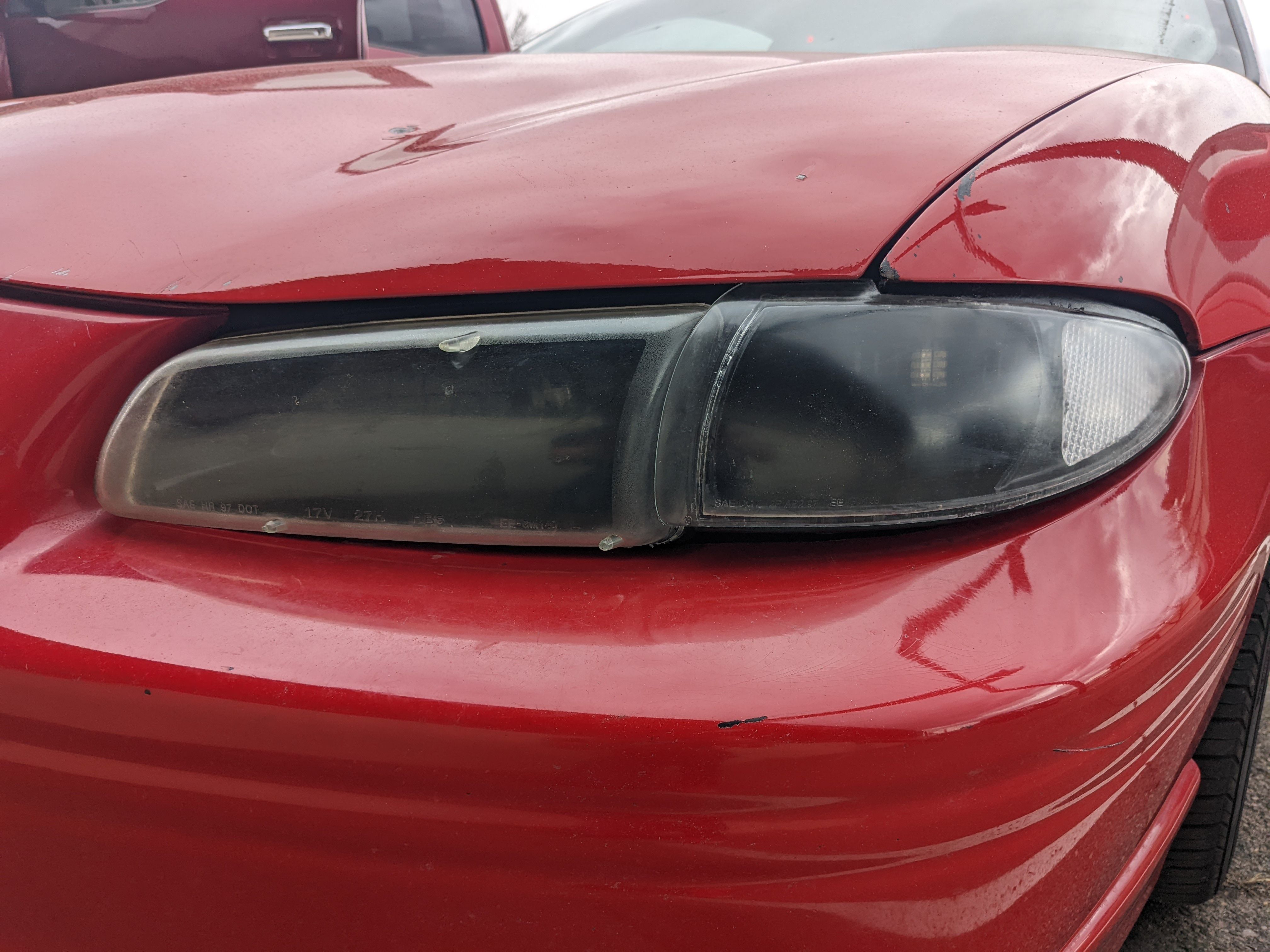

I got a set of old headlamps to mess around with for my 99 GP and I was thinking about doing a retrofit.  However, I don't want to mess with two separate headlamp bulbs and the projector retrofits I'm finding only use H1 single filament bulbs and it's not logistically feasible for separate bulbs/projectors in the factory style housings.  Unless, maybe, I would take the turn signal bucket and put on in there, but that seems even more ghetto and difficult to line up.  I do have Spyder projectors on it now, but I guess I'm just looking for a project.
I guess maybe a simpler question would be if anyone has but H4/9003 bulbs in place of their factory 9007's?  Is there enough material that can be cut out to put an H4 bulb in an H1 projector?  (I'm going to guess no.)

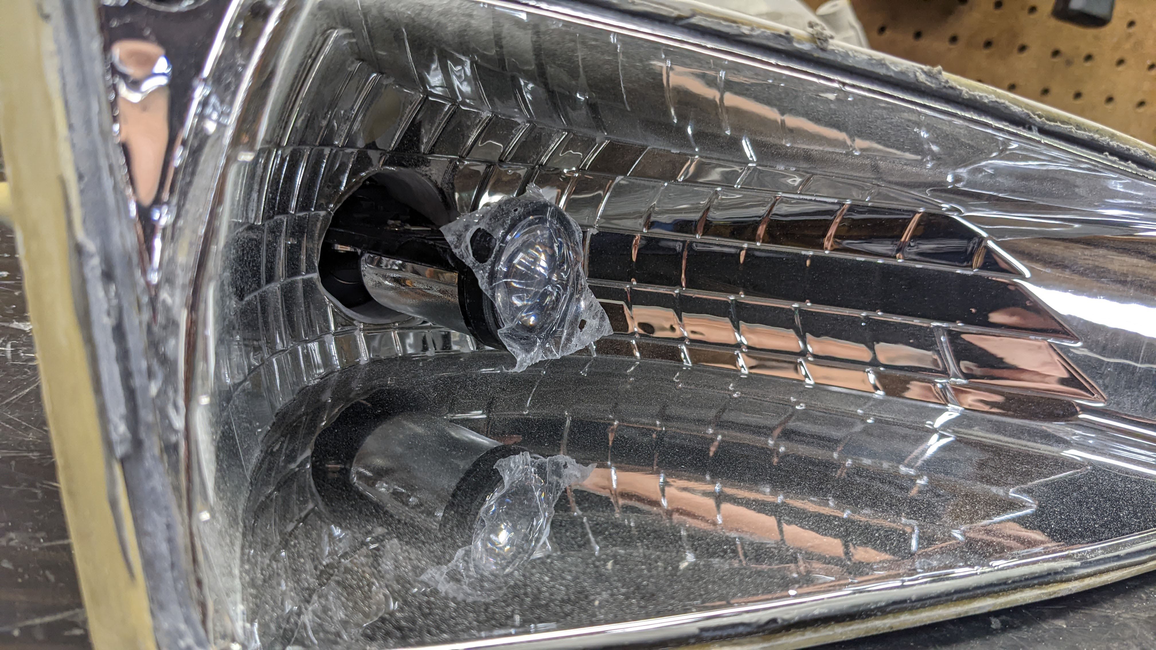

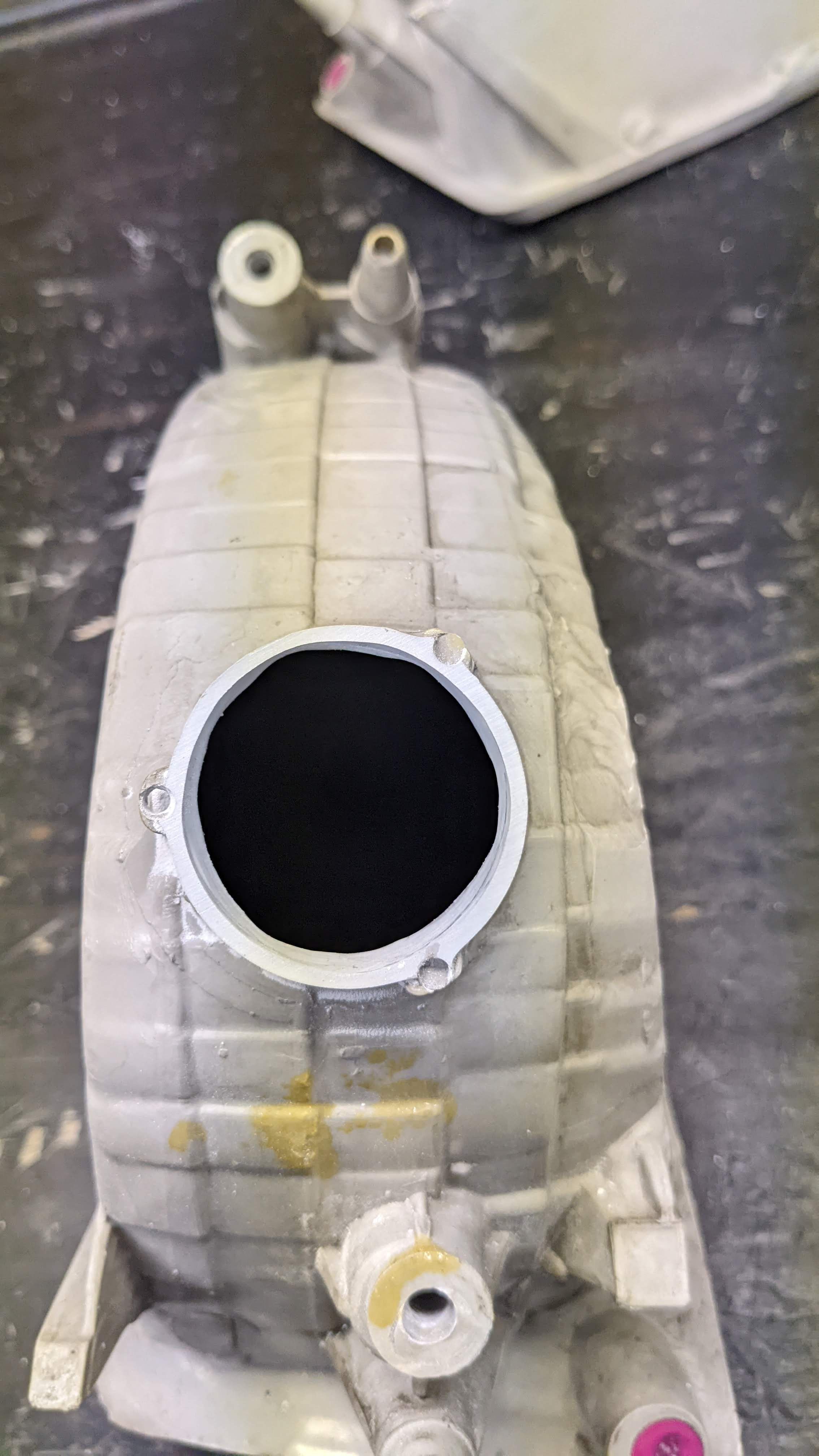

I got the bulbs and started messing with the housings.  I hogged out the hole for the bulb as it was larger than the 9004 hole.  I was going to try and figure something out to hold the bulb in, but I'll probably end up just using silicone.  It's going to need a seal, anyway.  Unless I can come up with something.  The screw holes don't line up, only one of them, but there wasn't enough material to use the screw to hold it in.  Should I paint the chrome part black since it has a projector?  Here's where I'm at so far...

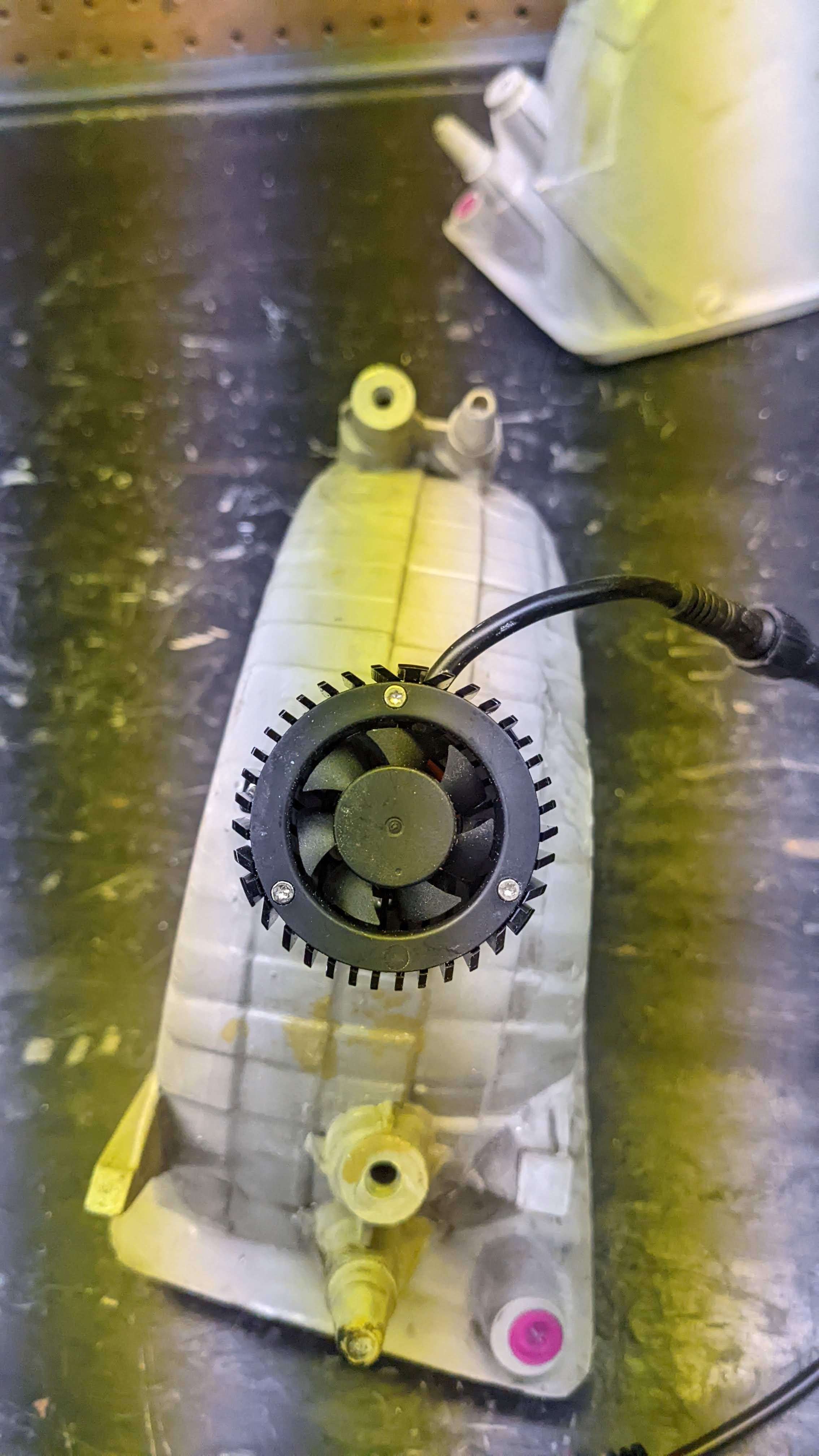

Got it done finally.  Of course, the high beam doesn't work on one of them and it's past the return window.  Still have to adjust everything and see if it's binding at night.  Beam pattern doesn't seem to scattered.

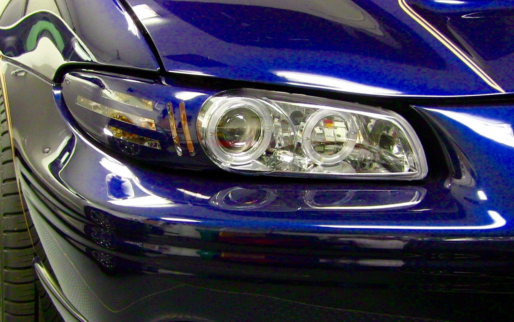

PWMIN, to address your question I would tell you this. I have had projector headlights in my Grand Prix since “02” I bought Spyder chrome units, as they were at that time about the only ones available. Since then many others have come to the market & I have looked at them, but never liked them as well. Unfortunately you can no longer get them other than black! Which kind of defeats the purpose of a parabolic reflector for the high beam.
 So you would have to choose what works for you, but the projector headlights for low beam are by far superior over the OEM lights when you use HIDs. Which will be the H1 HID bulb. What I found was when I would go to the brights, which was just a halogen 9006? I think that was the number, it was like I turned off all the lights by comparison. Because in the W-body as you know it doesn’t work like old school. It turns off the low beams, dumb!

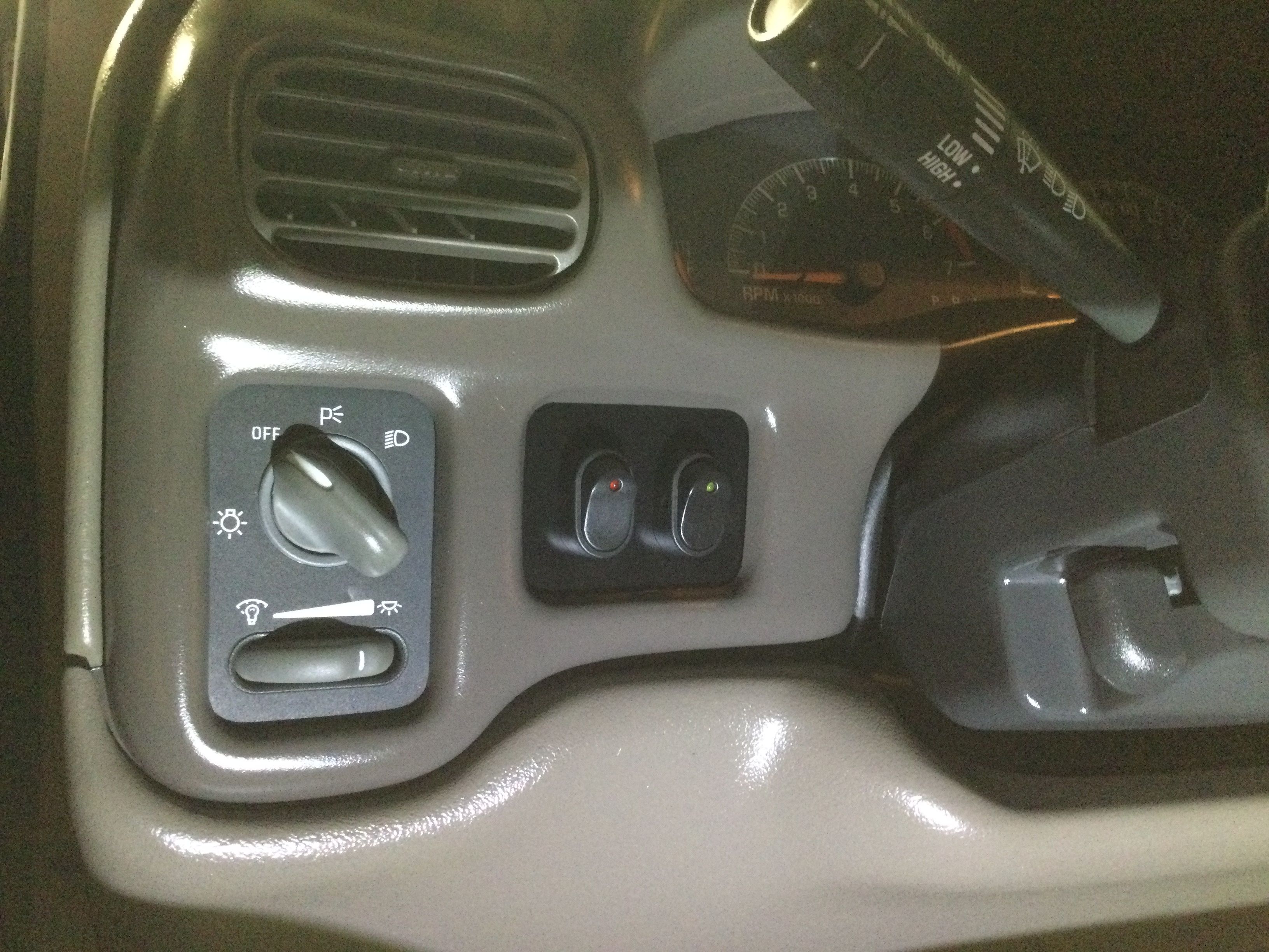

So to remedy that I put in HID 9006 bulbs & ballast for the high beams, but to feed them power I went back to the inside fuse box picked up 12 volts ran that to a relay, from the relay I feed the lights by a switch that is mounted in the cubbyhole on the left side of the steering wheel. Of course I made a plate for it. So when I want bright I just hit the switch & than I have low beam & high beam just like back in the good old days. Now with that you can actually seethe road.

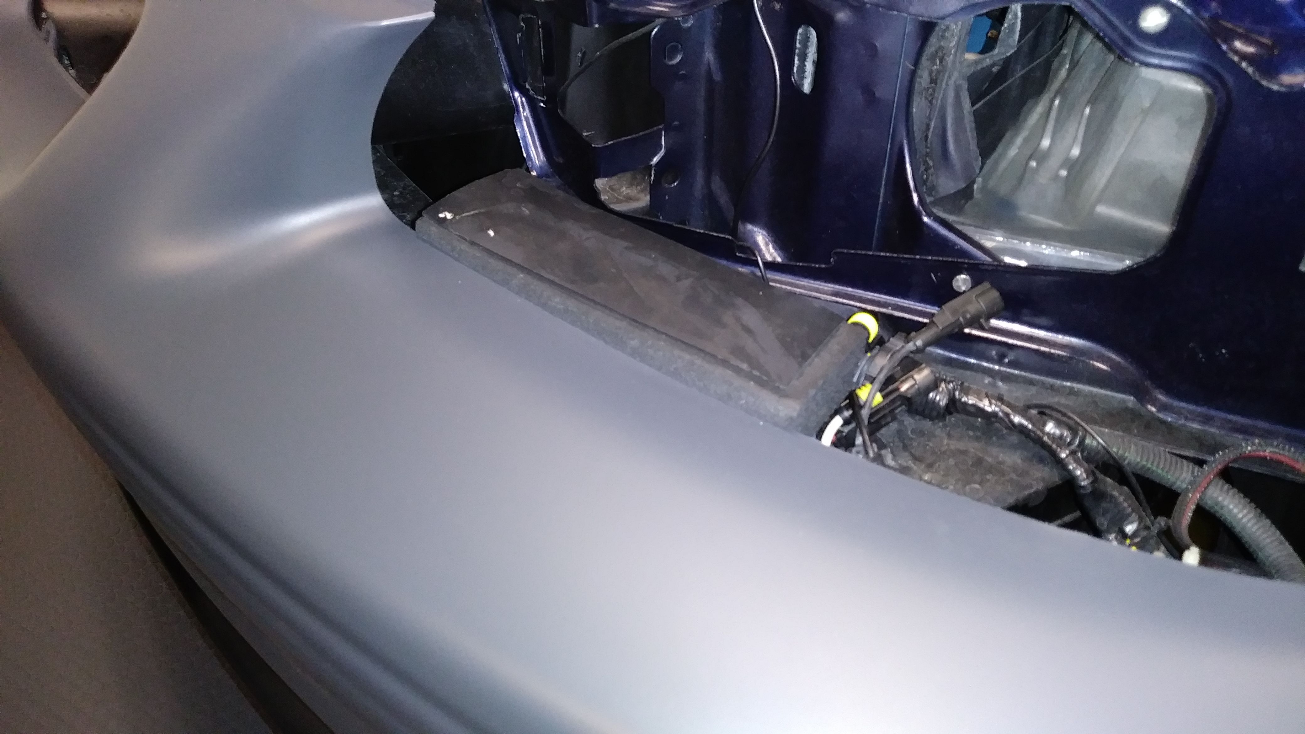

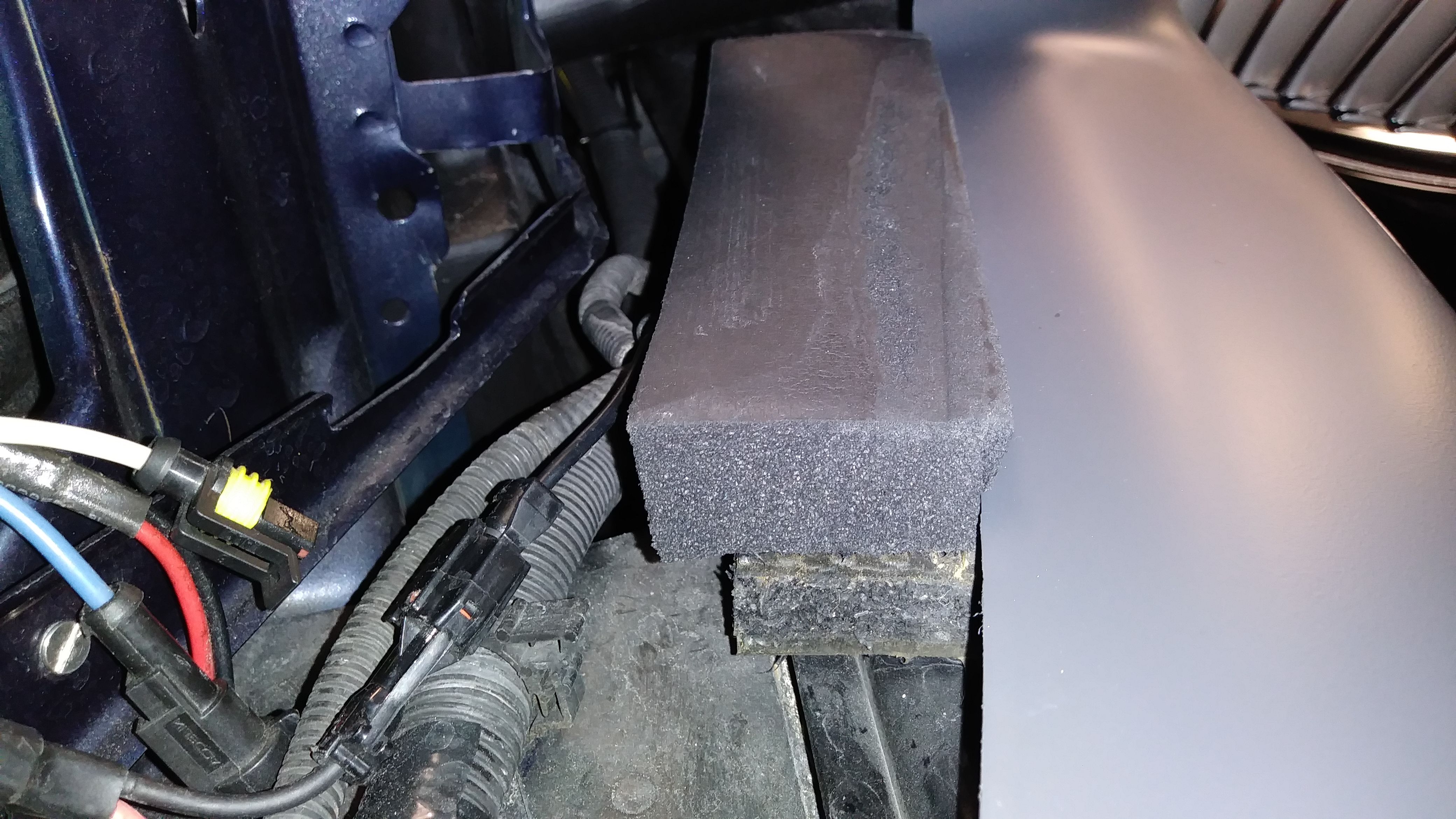

One other piece of information, since these lights are projector & not factory they tend to not be as ridged as the OEM lights. So I ended up stabilizing then by mounting a support/shock pad under them, see picture.
  • Like 2
I had to put a block under my Spec-D tuning projector lamps, which are similar to the Spyder ones.  I finally got the LED's hooked up, too.  I like the protector bulbs in factory style housings better, but I had a hard time sealing them correctly.
