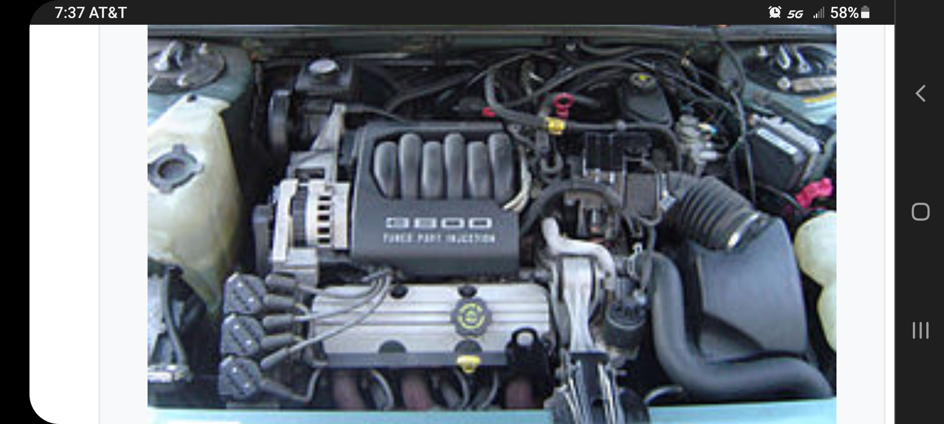

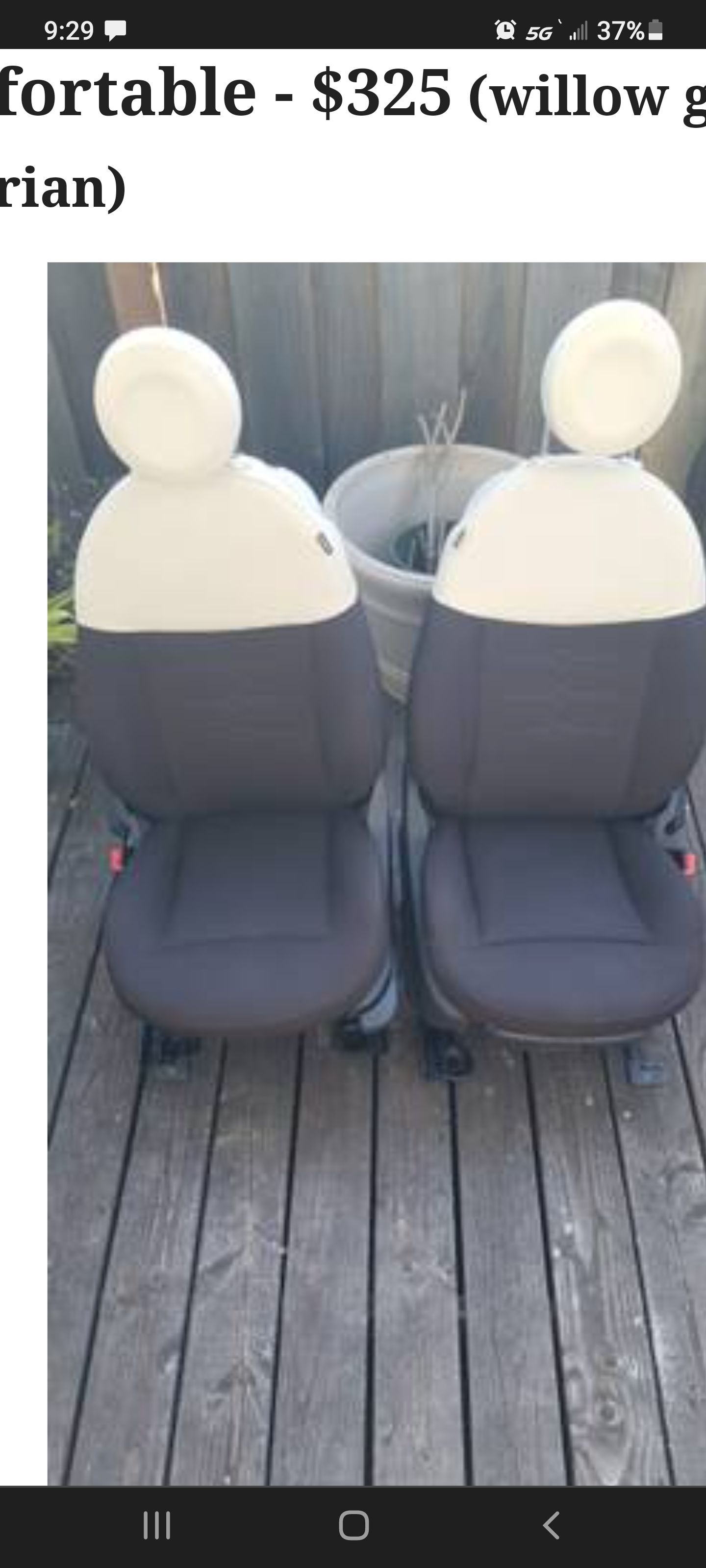

Dat50go Posted December 18, 2021 Report Posted December 18, 2021 Hey w-body fam bam. I have a question about the rear crossmember and suspension set up. Is it possible to replace the older '94 spring leaf suspension with the newer set up as like the '04 pontiac grand prix gtp? I noticed the brake caliper is in a different position from each vehicle which means I'll need the knuckle changed. And the sway bar routes different. And the gtp has coil spring strut assembly as the buick has struts and leaf spring. How would I mount the three bolts that are on top the coil? And it also seems as tho the coil spring could possibly be jammed against the inner wheel well.. any info on coil spring swaps would be greatly appreciated. (I installed these manual seats from a 2017 fiat 500. Blends well with interior.. looking for wood grain steering wheel... thinking maybe order from dealer a steering wheel for luxury vehicle like buick enclave limited or similar.. Toyota sienna has a nice wood grain wheel as I'm noticing lol (currently sitting in a '05 xle limited) also was thinking about swapping this Beauty into Mt regal also.. comes from same gtp rear suspension donor.. brakes/ rotors are here too.. 20211207_142256.heic Quote
Dat50go Posted December 18, 2021 Author Report Posted December 18, 2021 I will post a pic once I change brakes and suspension. I'm also thinking of not putting that supercharged engine into my vehicle.. maybe turbo will be better.. sleeper style.. and car (sedan) only weighs 3338 lbs!! LET'S GOOOOO!! Quote
