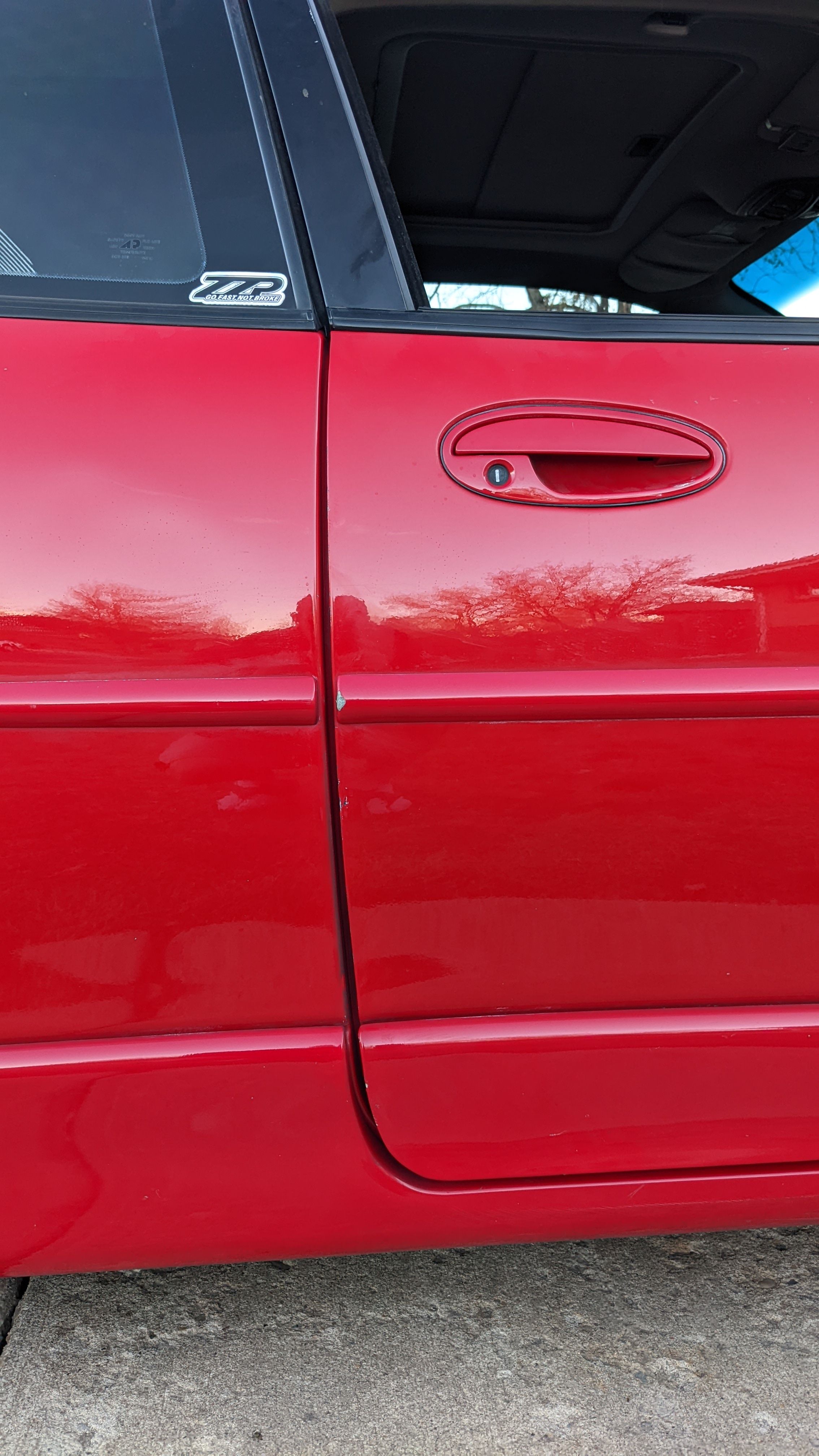

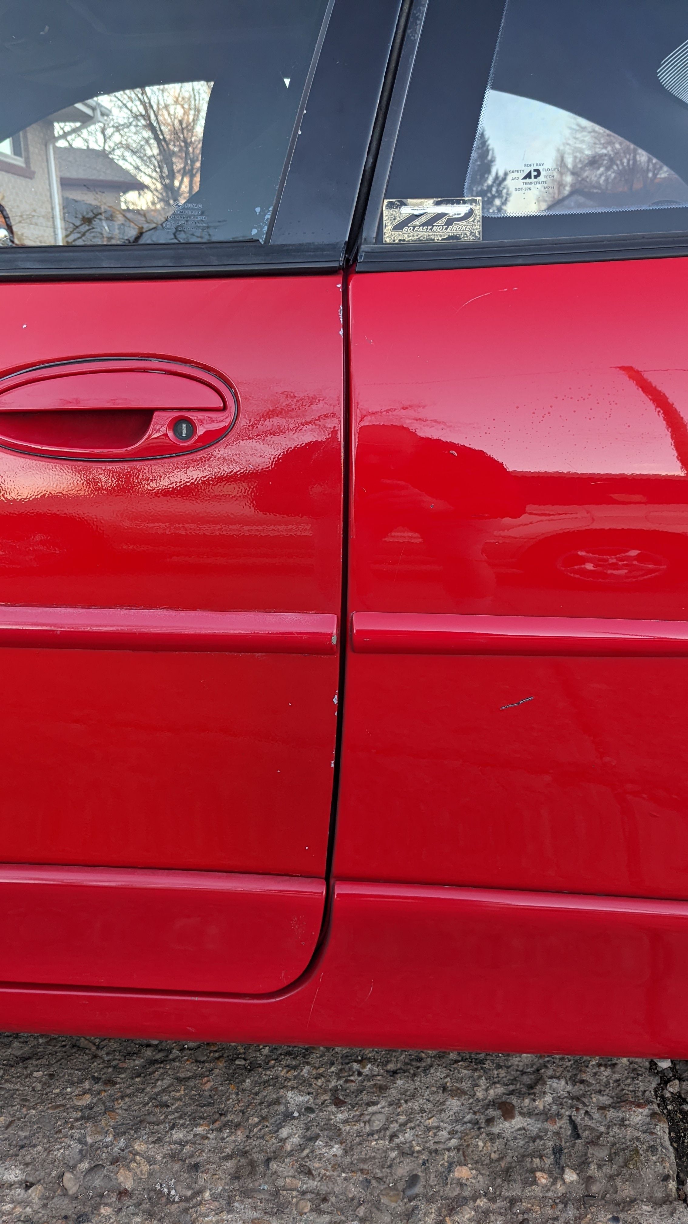

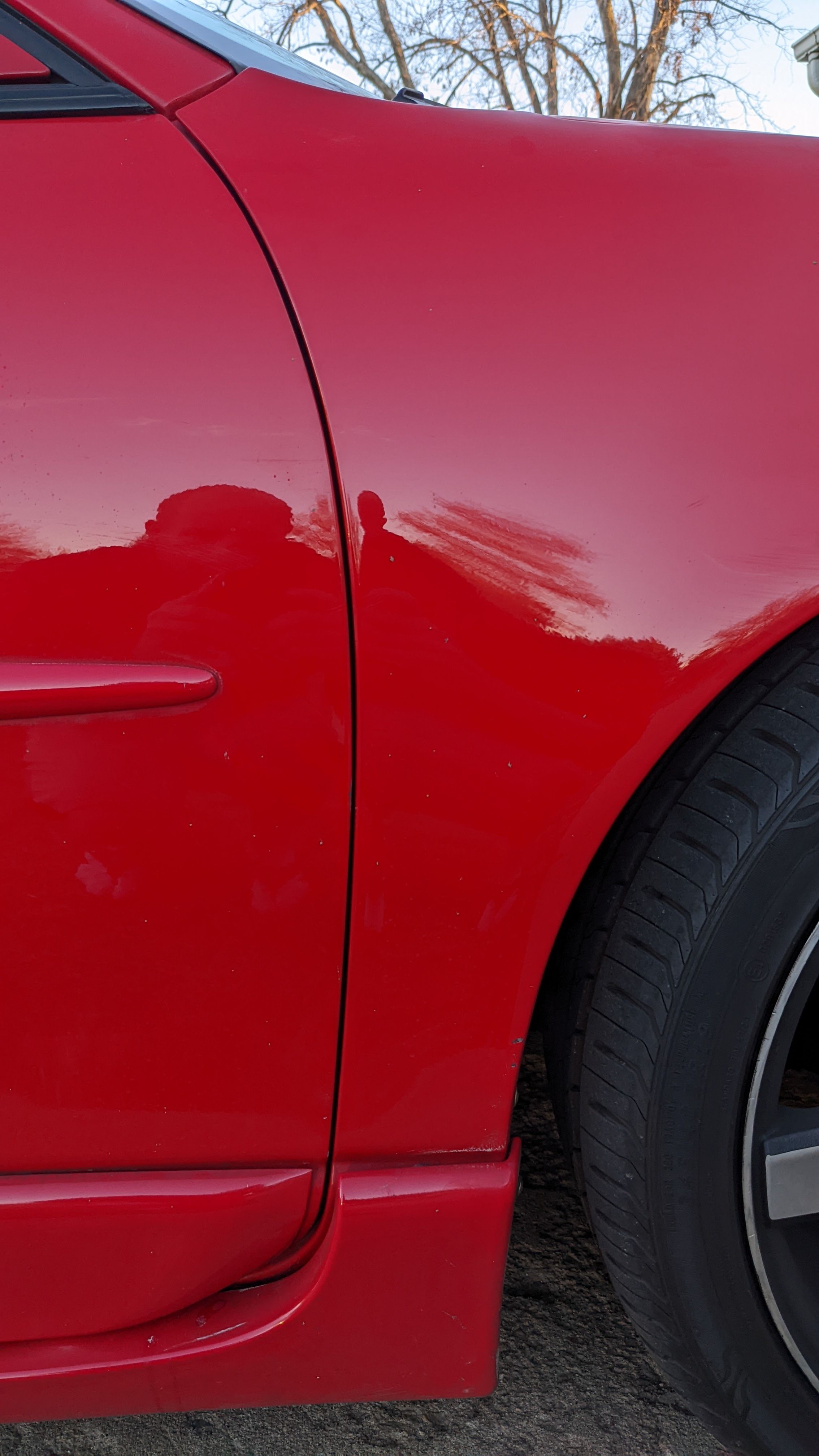

pwmin Posted December 15, 2021 Author Report Posted December 15, 2021 (edited) It's not much, but the passenger side is wider than the driver side even though the pictures don't really show it. Edited December 15, 2021 by pwmin Quote
runt Posted December 17, 2021 Report Posted December 17, 2021 If that were me, I'd find a body shop to deal with it. I used the "grab the lower part of the door and pull up" fix a few times but after awhile the hinges need professional help. I do see the gap difference though. pwmin 1 Quote
pwmin Posted December 17, 2021 Author Report Posted December 17, 2021 the hinges feel solid enough, but maybe they are starting to wear out Quote
