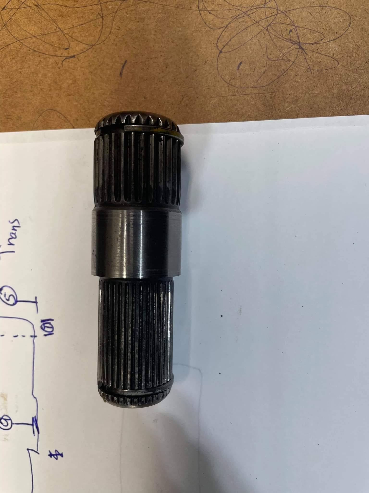

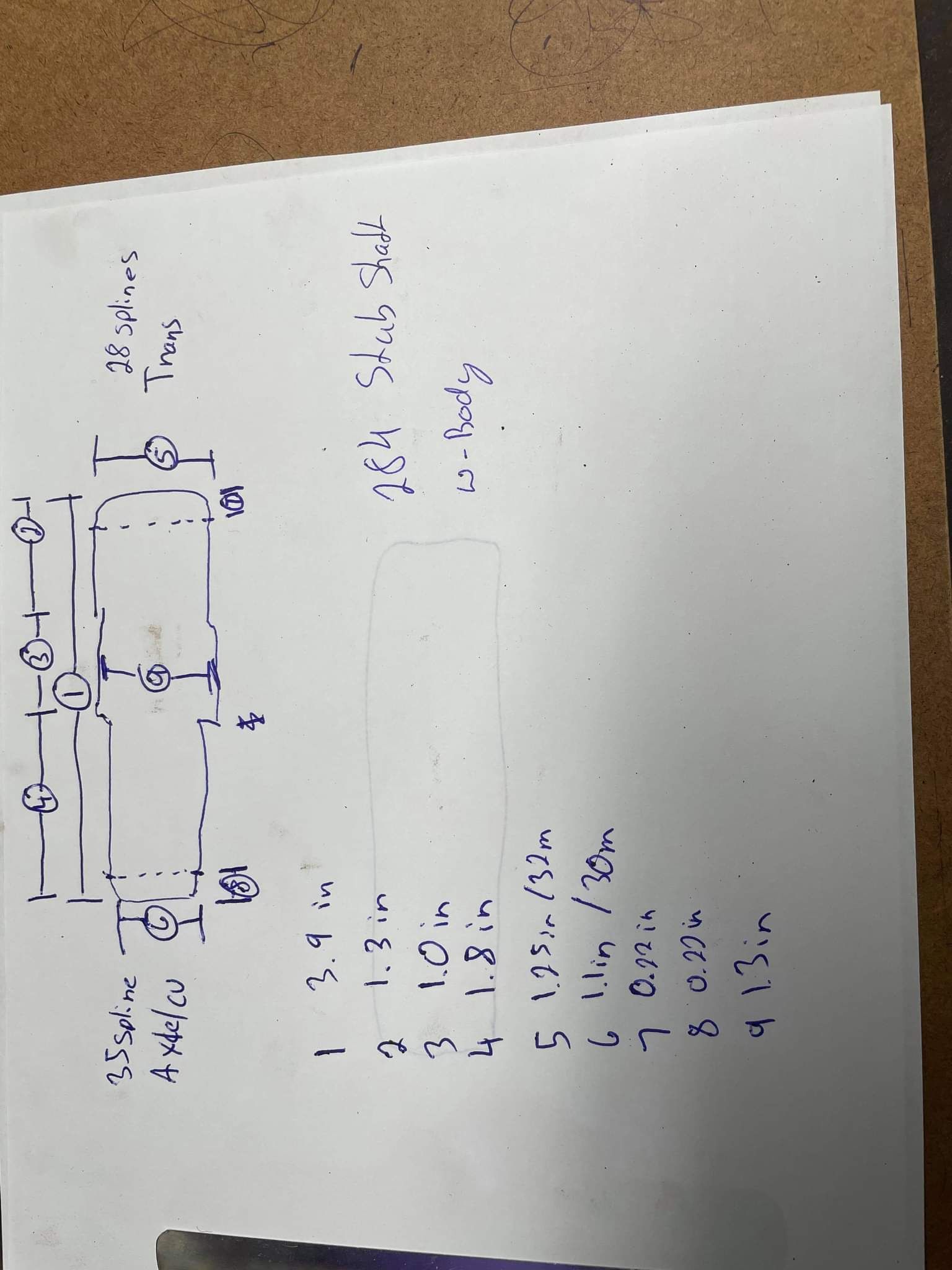

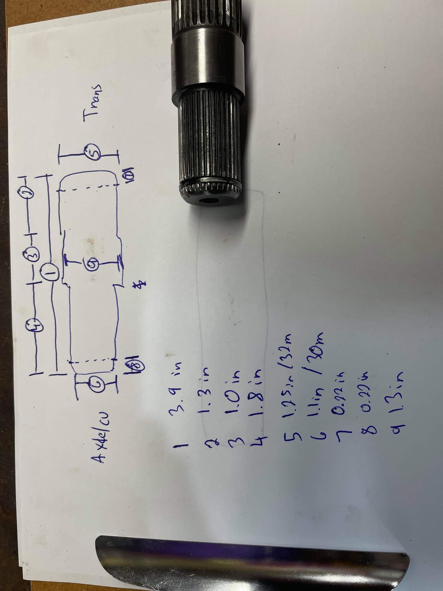

Getrag 284 stub shaft
I had a friend get me some measurements on the driver side stub shaft. I could draw it up in something like solid works or CAD but does anyone know anybody that would actually cut it?? My other idea was to find a 28 spline male cv that fit and build a custom axle that uses the w body out board and a 28 spline in board.
