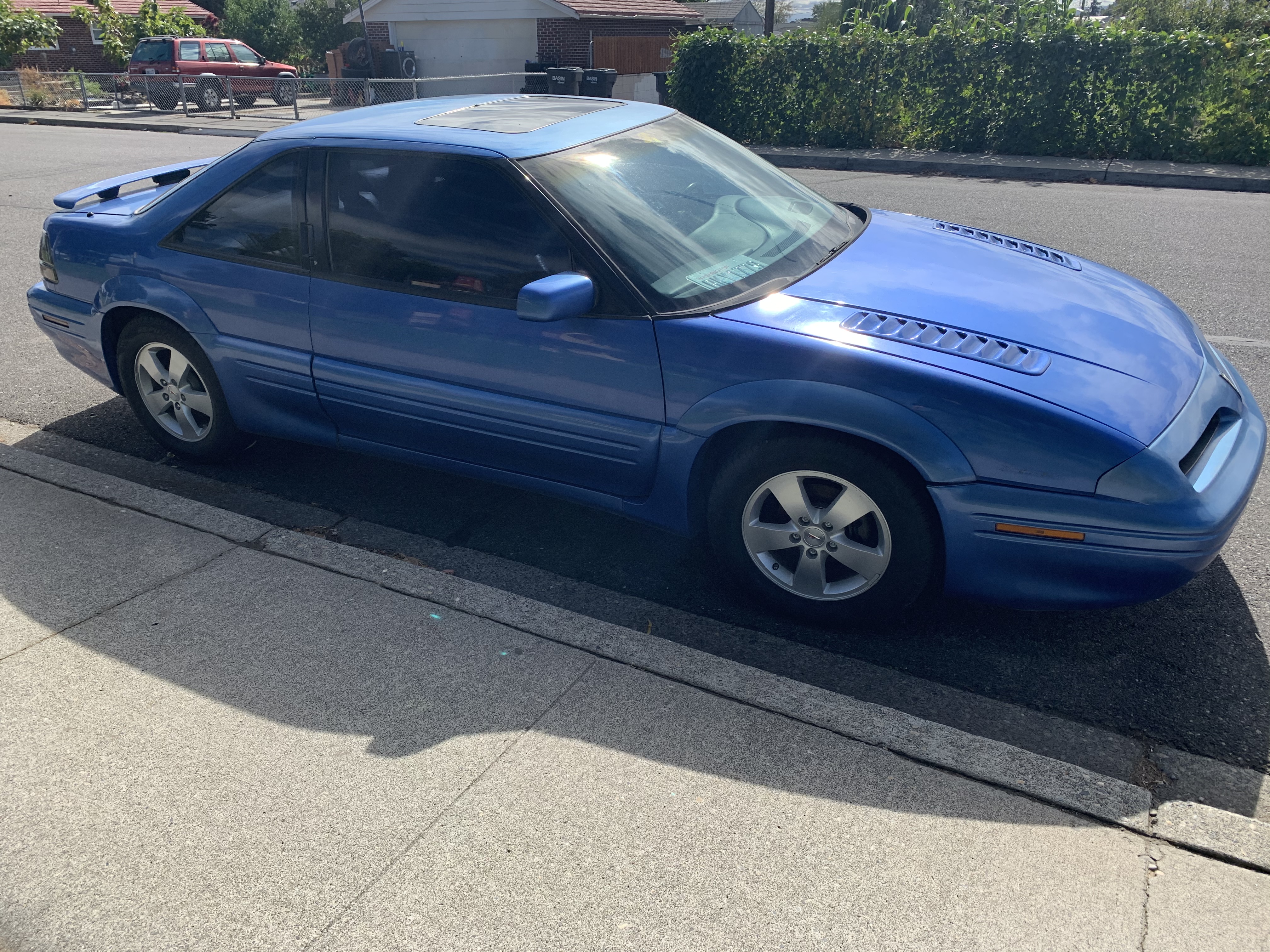

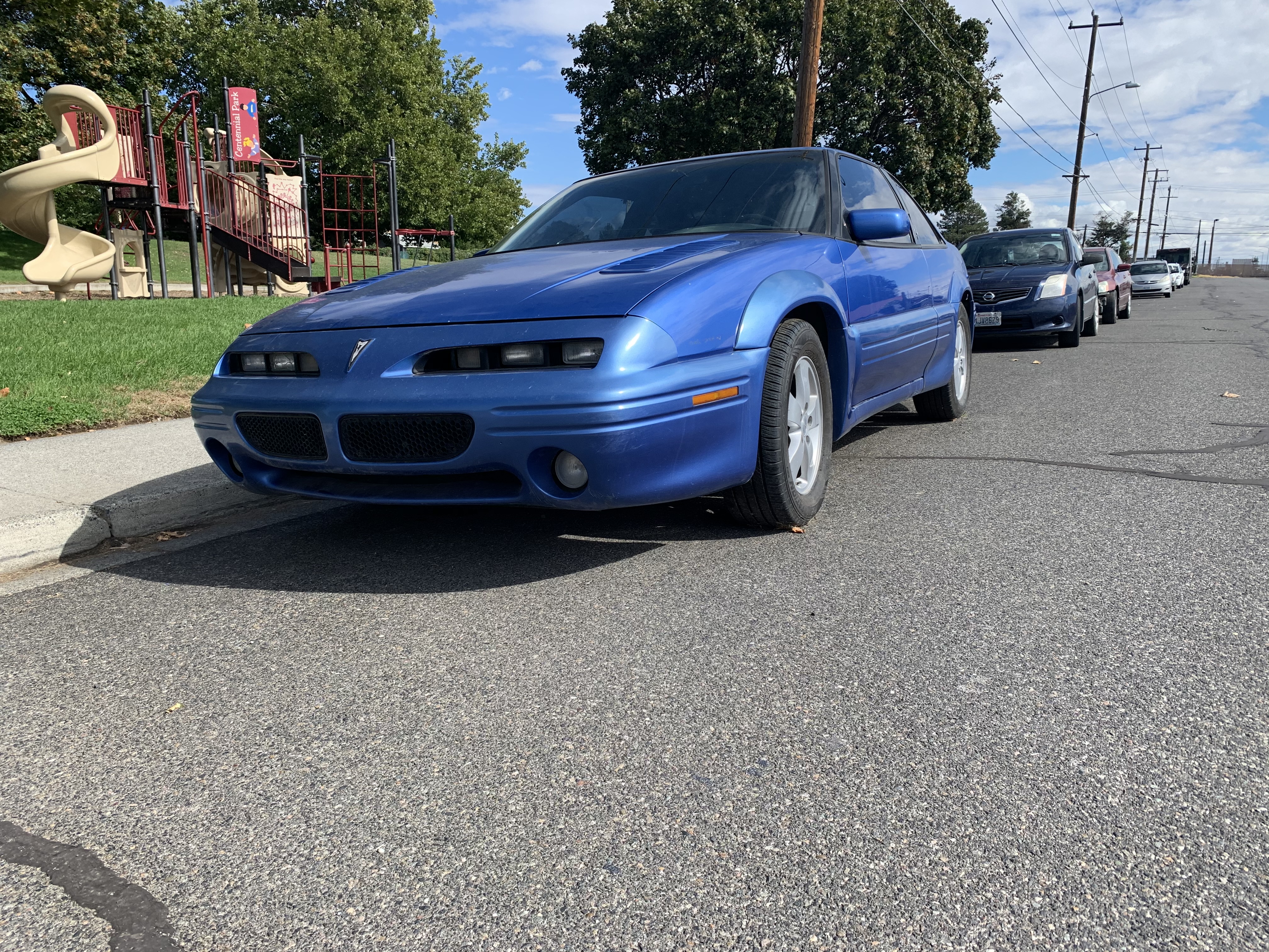

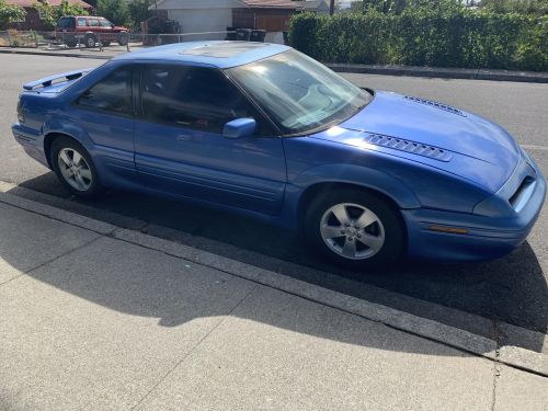

94GTP90SE Posted September 29, 2021 Report Posted September 29, 2021 Hey what’s up guys. I’m new to forums for cars; but I’ve been wanting to talk to other W body owners so I can figure out the issues with my cars. I previously owned a 1990 GP SE coupe with a decently rare option set, but I had to sell. I now just purchased a 94 GTP and I’m unfamiliar with the motor and some of its issues. ( Fans won’t kick on/ car won’t restart once heated up/ dies in reverse sometimes when power steering strains/low rpm flutter) I hope you all like the car anyway! pwmin 1 Quote
55trucker Posted October 15, 2021 Report Posted October 15, 2021 Hi there, what would you like to know about the DOHC engine? Are those mid 2000's Impala wheels on that car? Quote
RareGMFan Posted October 15, 2021 Report Posted October 15, 2021 2 hours ago, 55trucker said: Are those mid 2000's Impala wheels on that car? Pretty sure they're '04 & up GP wheels. Welcome to the boards, 94GTP90SE. I see you've got the TGP/'91-'93 hood with the bigger vents. Quote
