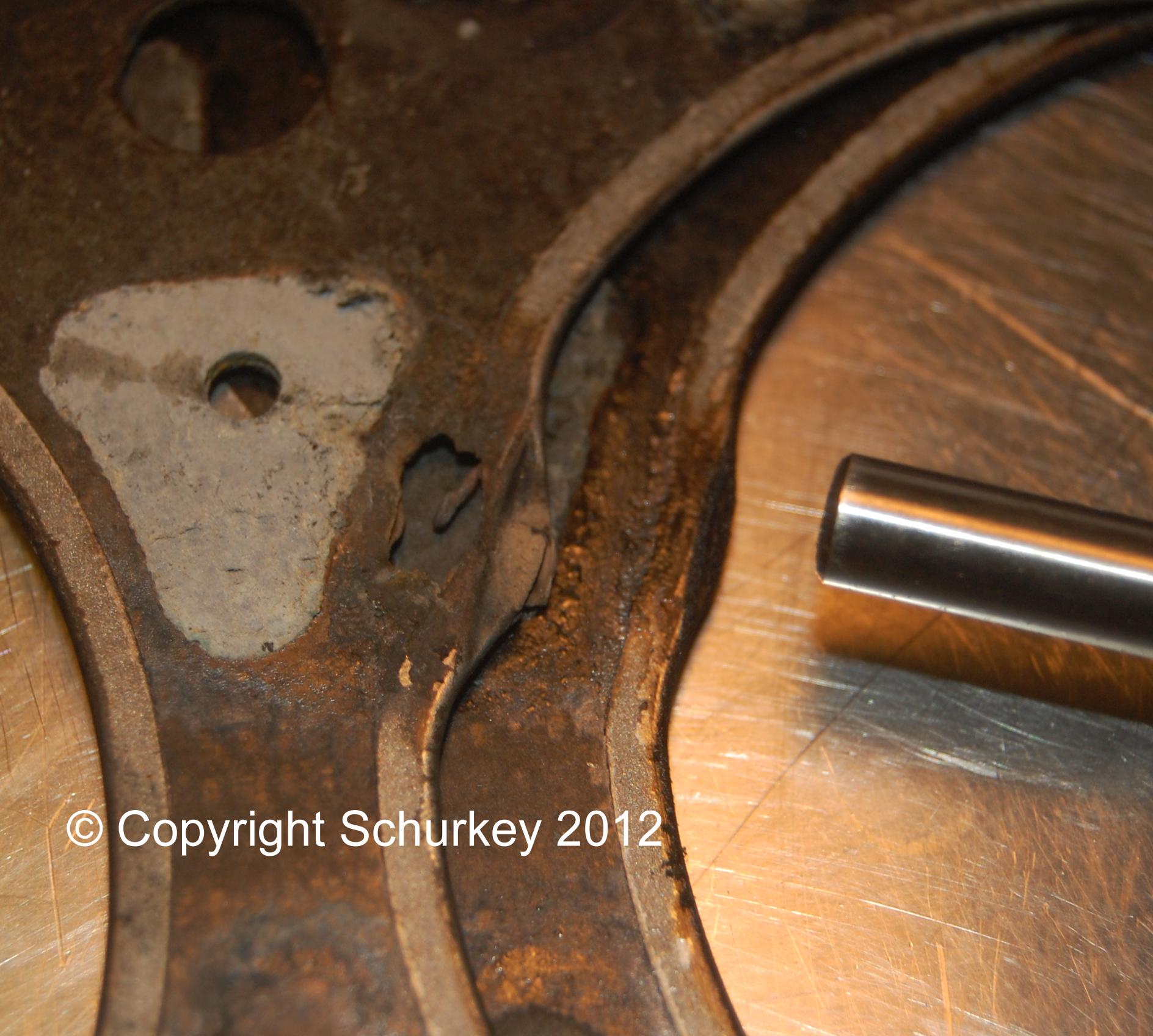

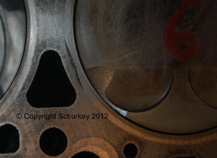

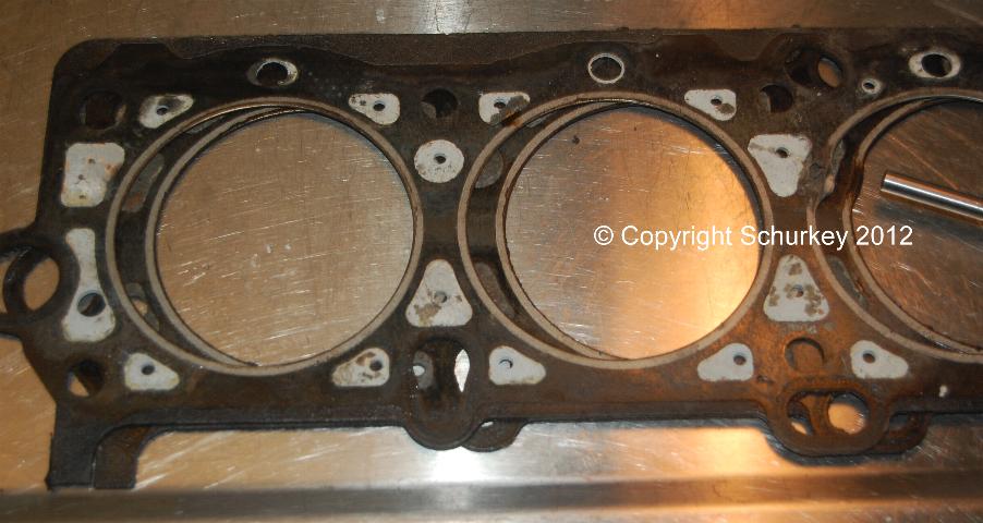

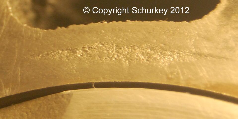

1.  Thanks for saving a rare and wonderful vehicle.  You know the previous owner neglected the vehicle, it's going to need substantial repair and preventative maintenance to set it right.
2.  I had a '93 3.4L with blown head gaskets.  One head gasket actually failed and leaked, when I pulled the other head I found identical damage in the identical place--it just hadn't started leaking yet.  It's as if there's a "soft spot" in the head casting; the head distorts, loses gasket-clamping in a certain area (near #1, kinda towards the lower part of 1 and 3; and the same spot on #6, towards the lower area of #6 and #4.  Very near a coolant hole in the gasket, and a bigass coolant passage in the block.)  The gasket wiggles free until it fails from fatigue.  Had to mill the heads .015, and I wasn't happy about the wear on the block surface--but I took a chance and it seems to have worked.  Got the engine running beautifully, and then the trans failed.  Haven't driven the car in almost ten years.
3.  Some photos of the two head gaskets stacked on each other, and scarred deck surface attached.
