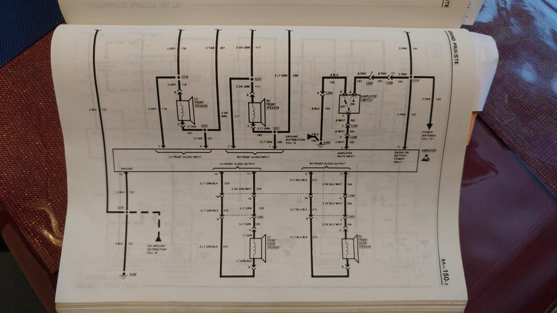

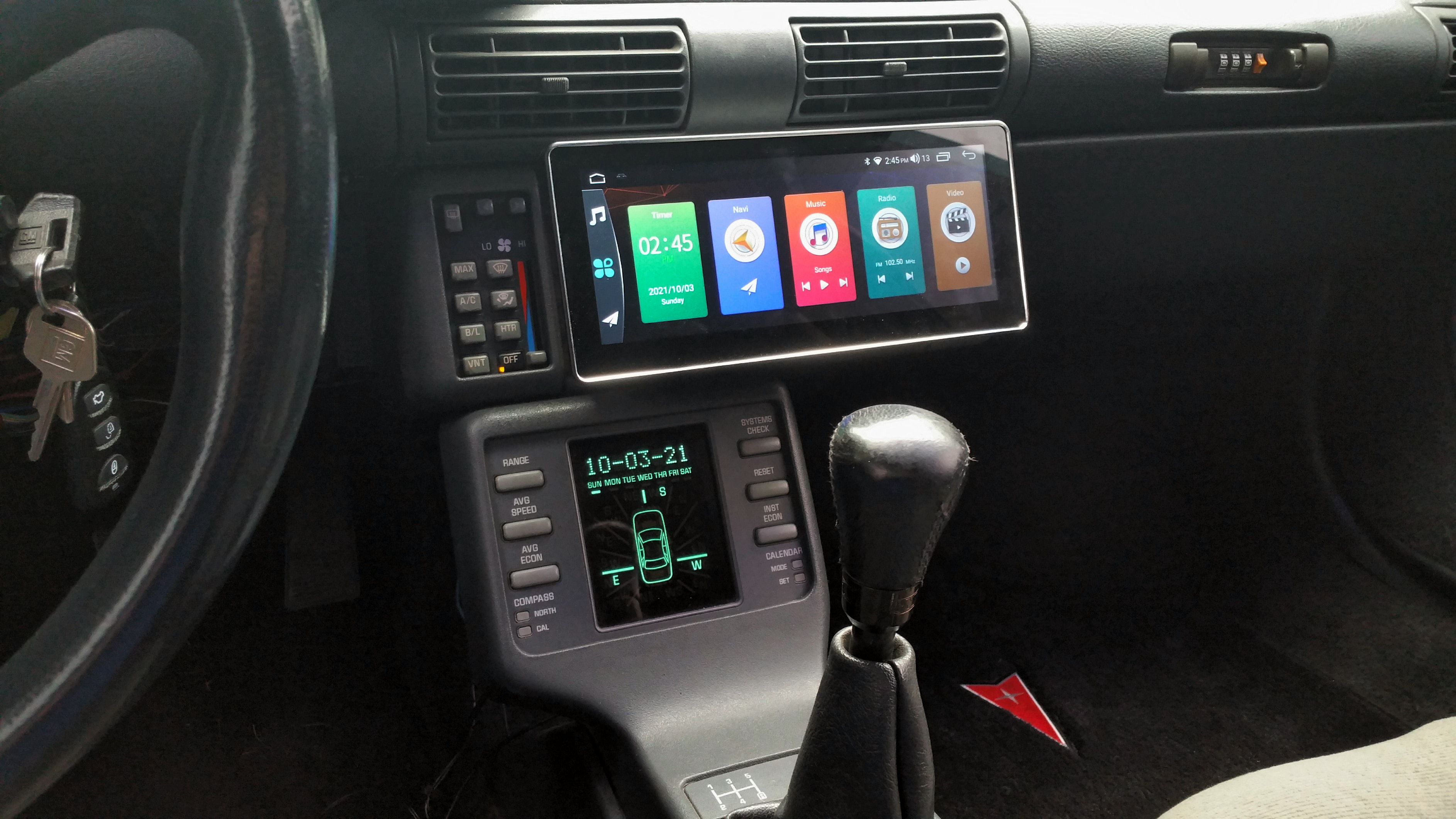

crazyd Posted October 18, 2021 Author Report Posted October 18, 2021 I got it installed last week. Still haven't figured out how to get the door speakers to work, anyone have any suggestions? Also have the PAC-SWI steering wheel interface but have no idea how it's supposed to connect to this thing. 94 olds vert and oldmangrimes 1 1 Quote
White93z34 Posted October 18, 2021 Report Posted October 18, 2021 Wow, thats a lot bigger then I expected. I'm guessing your car has the weird small amplifier at the base of the console that powers the dash and door speakers I know that thing was a notorious pain in the rear in years past but no idea how it was dealt with. Quote
crazyd Posted October 18, 2021 Author Report Posted October 18, 2021 There's some kind of box just below the dash and behind the head unit that might be what's powering them. Quote
55trucker Posted October 18, 2021 Report Posted October 18, 2021 (edited) 2 hours ago, crazyd said: I got it installed last week. Still haven't figured out how to get the door speakers to work, anyone have any suggestions? Also have the PAC-SWI steering wheel interface but have no idea how it's supposed to connect to this thing. Dave: the small *amp* & I use that word loosely....... is high impedance wired across the front speaker channels, what the front speakers get, the door speakers get as well. There is no volume control for it at all, I removed mine many many many years ago & installed a separate amp under the pass seat that is rca wired into my Alpine head unit & then to the doors speakers. Much better being able to independently control the volume to the doors myself. Edited October 18, 2021 by 55trucker Quote
crazyd Posted October 18, 2021 Author Report Posted October 18, 2021 Okay, then I'm guessing the door speakers aren't getting anything because there's no power to the amp through my harness adapter. Any idea which wires power it? Quote

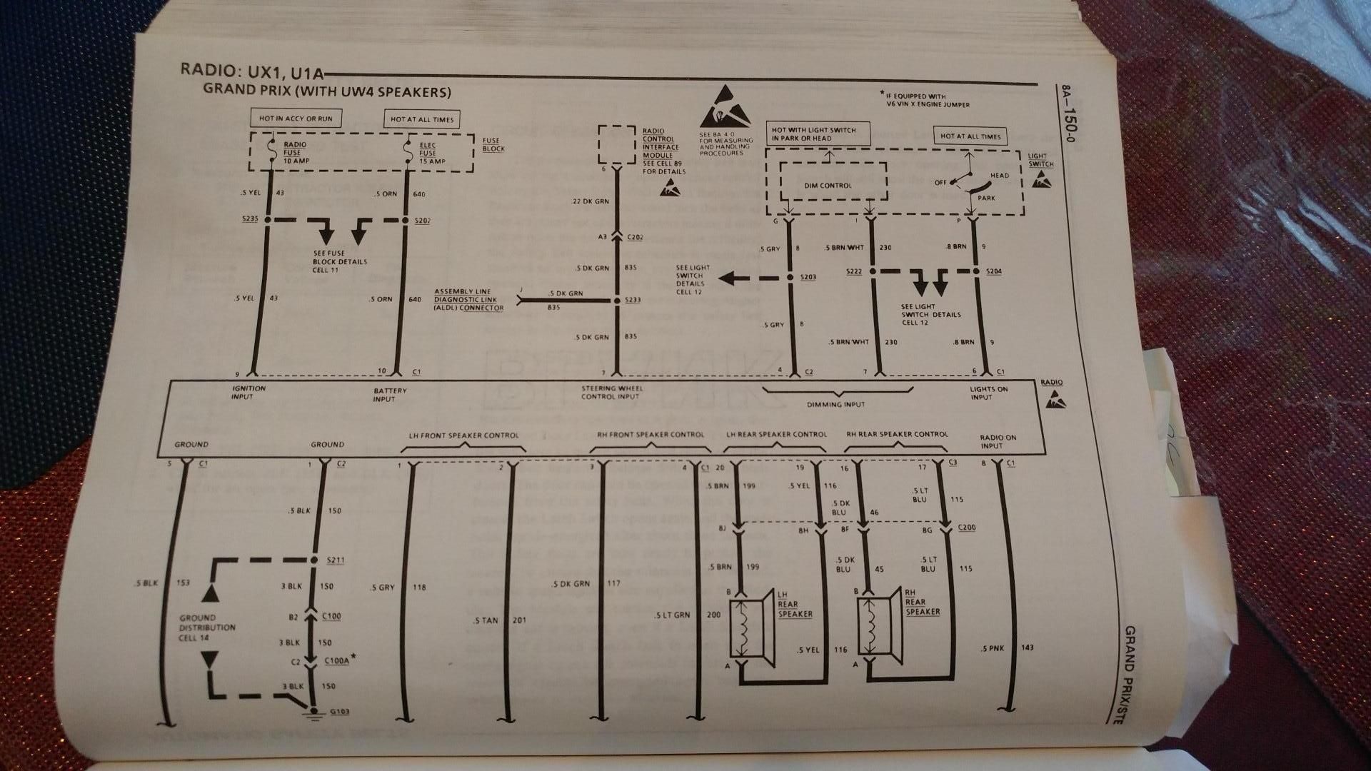

RPE1992GPSE Posted October 20, 2021 Report Posted October 20, 2021 According to the above diagram, the pink wire in the factory harness to the "amplifier" provides the power. I am unsure which year service manual the diagram is from, however. (Your vehicle may not have the "amplifier switch" pictured in the diagram with the white wire in the harness.) The factory pink wire is the "remote turn on" wire (or commonly referred to as the "power antenna" wire), so the corresponding wire in the aftermarket harness should be the blue wire (or perhaps a blue wire with white tracer). Just out of curiosity, are you using the stock speakers, or do you have aftermarket replacements? pwmin 1 Quote

crazyd Posted October 25, 2021 Author Report Posted October 25, 2021 Had some time to play around with this thing. Other than getting the door speakers to work, it works really well... I also got the optional TPMS kit that shows tire pressure and temperature! Haven't wired in the backup camera yet as I haven't decided how I want to get that wiring inside the car. Also going to rewire the sub to RCA as it doesn't work right off the rear speaker signals anymore. Quote
