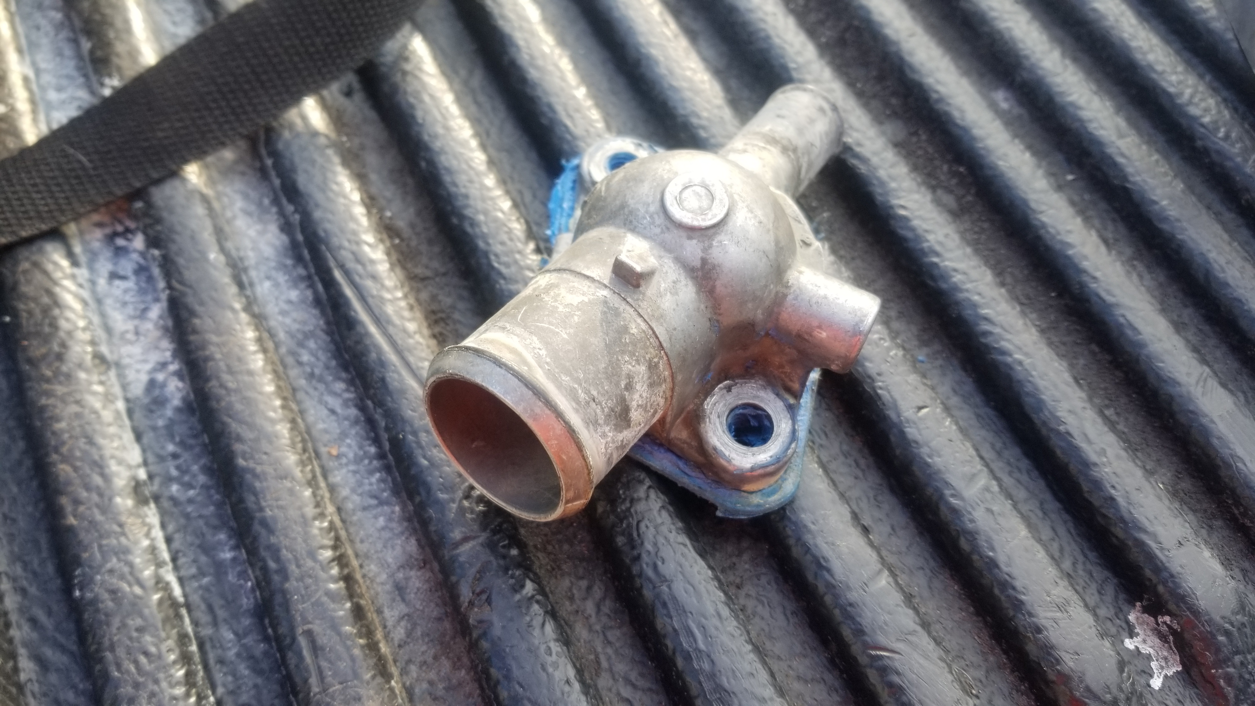

Jimmy Posted August 22, 2021 Report Posted August 22, 2021 Where can I find a Thermostat housing for a 3.4 95 oldsmobile cutlass supreme Quote

Jimmy Posted August 24, 2021 Author Report Posted August 24, 2021 Yes i did and actually ordered one that i thought would work but the hole spacing was different. And none of these are like the one i posted that i took off. Quote
55trucker Posted August 24, 2021 Report Posted August 24, 2021 The LQ1 stat housing is unique to the LQ1, it is stamped steel, not cast aluminum, the pushrod eng housing will not work with the LQ1. You'll need to get one off an LQ1 engine. Quote
Jimmy Posted August 25, 2021 Author Report Posted August 25, 2021 I'm informed that it's a water housing I'm looking for. Quote
GTP091 Posted August 25, 2021 Report Posted August 25, 2021 (edited) You’ll still need to get it off a donor LQ1 from 94-97 years. 91-93 is different. You may find it on the inter webs but best to hit a JY and hope for the best. part # 24503051 http://oemcats.com/oem-parts/24503051.html the old one has a crack? Edited August 25, 2021 by GTP091 Quote
